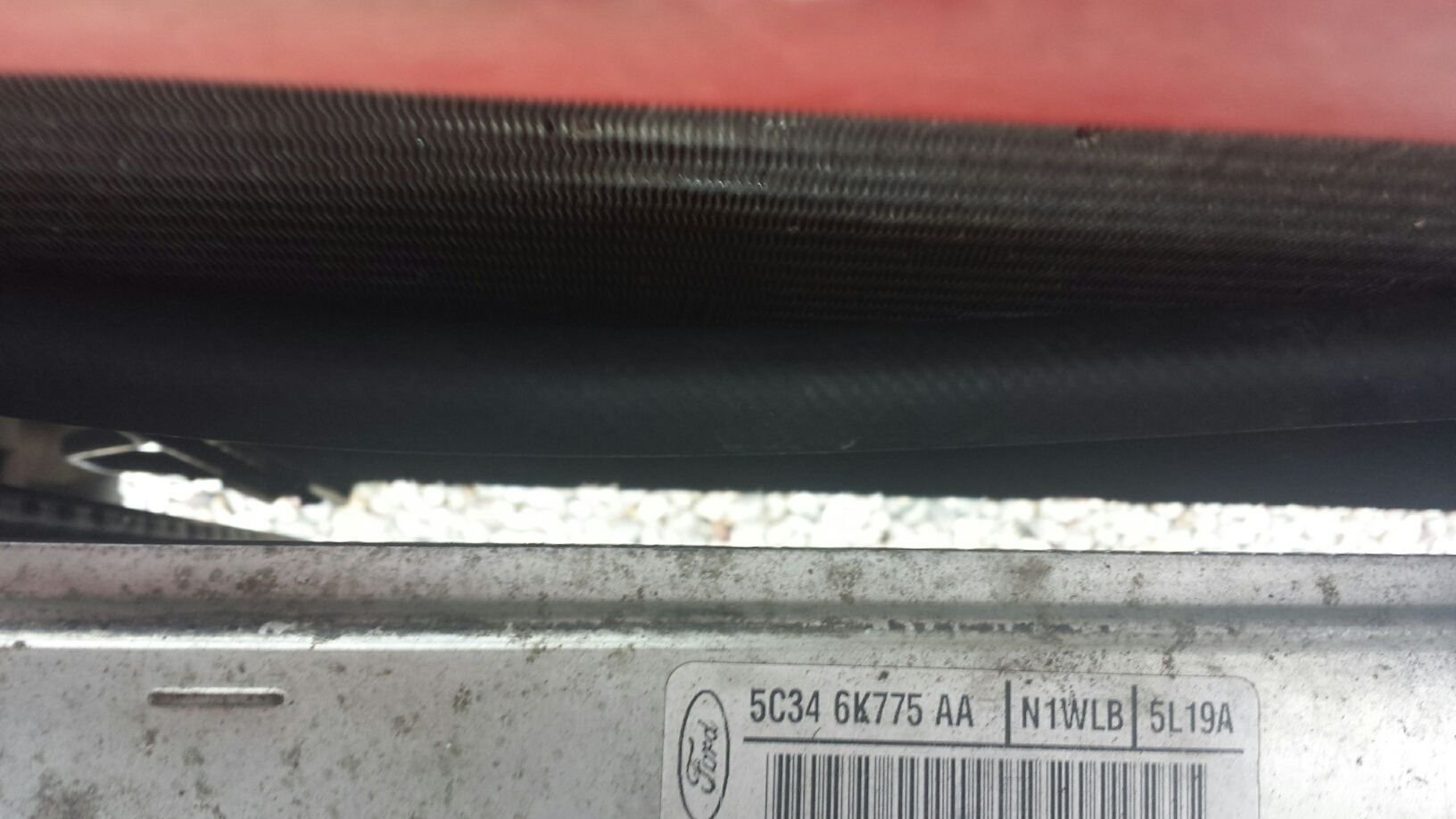

I picked up a 6.0 trans cooler today thinking it would be a relatively easy swap from the original trans cooler. Now that I am looking into it, it looks pretty involved. I see that the cooler lines themselves are smaller on the e4od, so would I be able to splice them up to a larger size or would I have to put all new lines in? Also, as far as placement goes, is hanging it from the middle in front of the other radiators the best place? or maybe off to the side a bit? Let me know what you have to think, thanks!

should be fine in front of the ac condenser. I addapted a 6.0 and early 99 7.3 trnascooler in between my ac condensor and intercooler. I recomend using an electric fan dirrectly mounted in front of your transcooler. I can attest to the wonders of cooling your tranny, I should know i have 800k on stock tranny.

All of mine fit up there great. Dont get me wrong your gonna have to cram alot in there. But after trimming the front grill support and the backside of the grill itll work. Your gonna have to build the mounts a second time when u put the intercooler in. I have my intercooler an inch in front of the condensor, and then the tranny cooler an inch in front of the intercooler. It all fits. I used 1/8th inch x 1.5 wide steel strap and bent it in an S in a vise. Then drilled 1/4" holes for the bolts.This is what itll look like with ur exact truck expect I ended up putting everything about 5"s higher then in the pick. Great looking truck by the way.
I can deal with a little trimming here and there, and this fix isnt looking as major as I originally thought. Im sure your truck looks better than mine when it's all in one piece! Mine is rusting to hell; I just found rust bubbles around my front wheel wells and around the top of my windshield...I didnt even know Fords were prone to rust there! Another question to you, how much more ATF did you end up using when you installed the cooler?

Ouch man sorry to hear about the rust. I put on some coveralls and got under mine and thuroughly looked for rust when I bought it. Luckily mine didnt have any. I just added one quart, itll say its way high when u put it in, but only because it hasnt filled the tranny cooler housing yet. Itll go back to normal level once u run the truck. Heres some more pics. Just do 3/8ths barbed to 1/2" male threaded fitting, to 1/2" barbed to 1/2" threaded female fitting. And then just buy 5ft of 1/2" tranny hose. I also pushed by front bumper about 1.5"s forward. Dont buy it at nappa its super expensive there. Heres some more pics.

I wish my truck looked as good as yours but being a plow truck in the middle of the rust belt is eating mine alive. I have some barb 3/8" to 1/2" barb fittings on the way, would that work? And only one quart? I thought it would be a lot more. I may have to re-position some things if the bumper sticks out that much with the intercooler too because my plow sits very close to the bumper.

Yeah the 3/8ths to 1/2 should be fine. Yep only 1 more quart. My bumper was pushed forward so I could fit 33s with no lift. You may be able to leave ur bumper there. You could always just trim the bumper out to fit the tranny cooler. However u may not even need to trim it or push it forward at all.

I was looking more closely at the truck and im seeing plenty of space in between the two existing radiators. If I can properly mount the cooler there, I might just do it. looking at the pictures, it looks like the cooler with the mounts is the width of the OEM radiators. Just a thought
