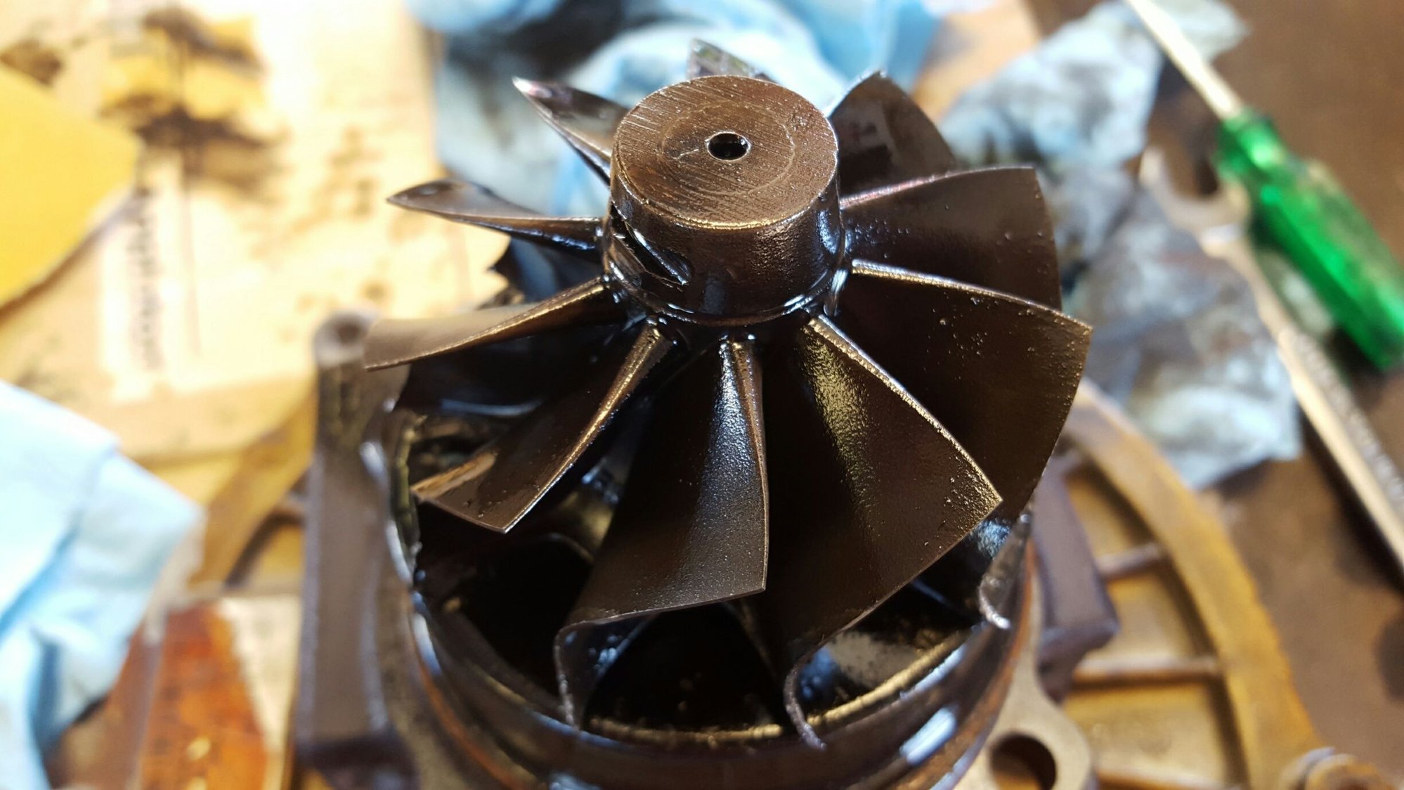

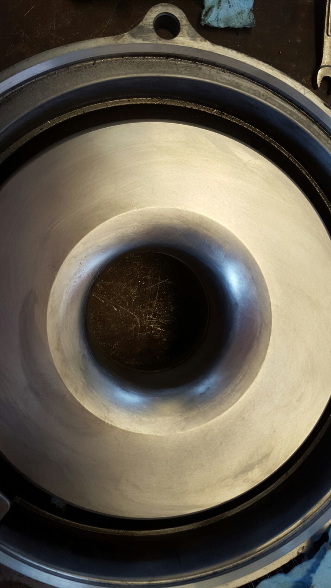

So I think I see the problem now. I guess I should have taken the turbo apart when I had it off the first time...

Wait until you see the exhaust/turbine wheel...... I hate to break it to you, but I would cancel/return that new "cartridge". You need a whole 'nother turbo, since the outer compressor housing is also damaged. (your bottom pic) It may not look like much, but that gouged out material will greatly increase the gap between the new wheel and the housing, and you will lose a ton of intake efficiency.
Wait, that's not your NEW WW2 is it? I hope not. Also, what's that piece of greenish tape on one blade of the wheel? I think that would cause a huge imbalance at speed.

I don't think it's gouged, it feels like it's the material off the compressor wheel built up on the housing, the wheel is definitely the softer material. I hit it with some 220 and cleaned it up with a scotch brite and it looks good.
The cartridge is coming today, the WW2 won't be here until Tuesday so I'm going to put it together and see how it runs, if boost is about what it was before it came apart I'll call it good and just replace the wheel when it comes in. If not, I'll order a replacement housing and do both. Right now, I'm just wanting to get it running well enough to head to South Texas and shoot some dove. A man has got to have priorities...
The exhaust wheel actually looks fine to me. I think what happened is the oil seal blew out on the exhaust side and the whole thing got some play in it. I can move the wheels back and forth some and actually can't get the intake wheel off, it just free wheels when I clamp the other side.

Originally Posted by bcg;15655208..........
The exhaust wheel actually looks fine to me. I think what happened is the oil seal blew out on the exhaust side and the whole thing got some play in it. I can move the wheels back and forth some ...[/quote
Nope. That exhaust wheel is TRASHED. See how the outer tips are actually little "hooks", or claw-like? They are not supposed to be like that. They shouldn't "wrap" around the center housing, like yours are. The back face of the wheel should be flat, and with a small gap between it and the cartridge.
If you can manage to get it apart, you will find the heat shield and the back face of the wheel have "matching" gall marks/gouging, with chunks appearing to have been "peeled" out of each. ANY amount of in/out play is very bad, and will quickly lead to the carnage you are seeing.
Here's pics of my old turbine and center section:
Your turbo has swallowed a crap-ton of metal shavings, so I would make sure you thoroughly flush out the oil passages in the pedestal and any other parts you are reusing ,as well as changing your engine oil.
You may have broken the shaft. Actually, I wonder if the previous "mechanic" may have used an impact gun on the wheel? That will do it. Never, ever use an impact gun to remove/install a turbo wheel. (Except maybe to get your old one apart for a post mortem, since its already junk anyway). Which is why you may want to wait until your WW2 arrives, so you can install it once and be done. Otherwise, you'll probably need to pull the turbo again to install the WW2 correctly.
