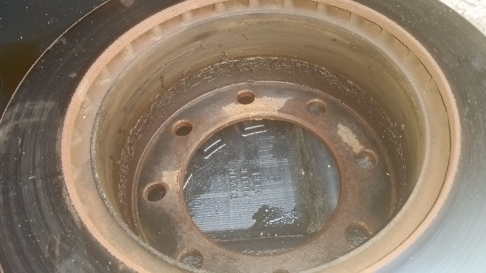

Progress so far...

Obviously I finally got the rotors off. A little PB Blaster works wonders. The seal on the PS hub looked dry and rusty, while the one on the DS looked ok.
The PS ebrake hardware was rusty and in pretty rough shape. The DS was wet, and smelled like diff fluid, worth all kinds of crap stuck to the inside of the rotor.
Since I had to replace the seals, I went ahead and replaced the bearings and races - which I don't think were bad now, but, with 144k on its odometer, I didn't want to put those bearings back in.
Replaced the PS brake caliper since I damaged it while taking it off. Replaced the DS caliper since it had a stuck piston. New pads as well. Should be finished this morning, as long as the rain is really gone. Lost 5 hours to rain yesterday.
