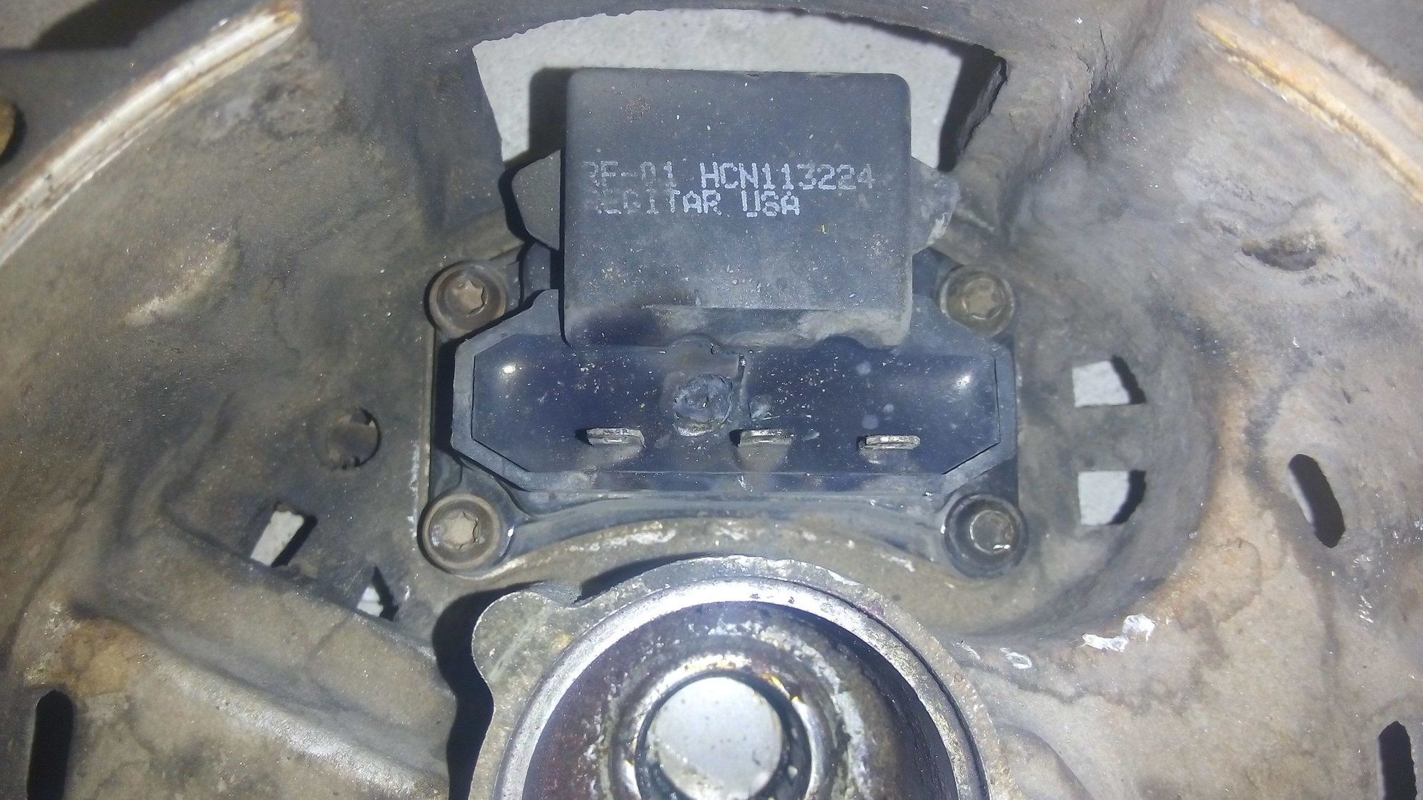

Bad/overheated rectifier?
Is there another component in the charging system that would cause this hole or is it just a symptom of the rectifier itself going bad.

Is the plug/pigtail shorted out?
That's what usually cooks these alternators.

Poor design right from the beginning. Best solution is to upgrade to a 3G alternator. Very easy swap

Locally my parts store wants $92 for a 2G REMAN! I converted to a 3G using all new for $122 and that's including buying a spare inline charge fuse! I wouldn't screw with the 2G at all. I tried to rebuild mine and what a waste of time it was.

Thanks for your responses guys, I had mine rebuilt locally three years ago and decided to open it myself this time it went out. I'll look up the 3G conversion threads

Neither of the two connectors look in the best of shape
