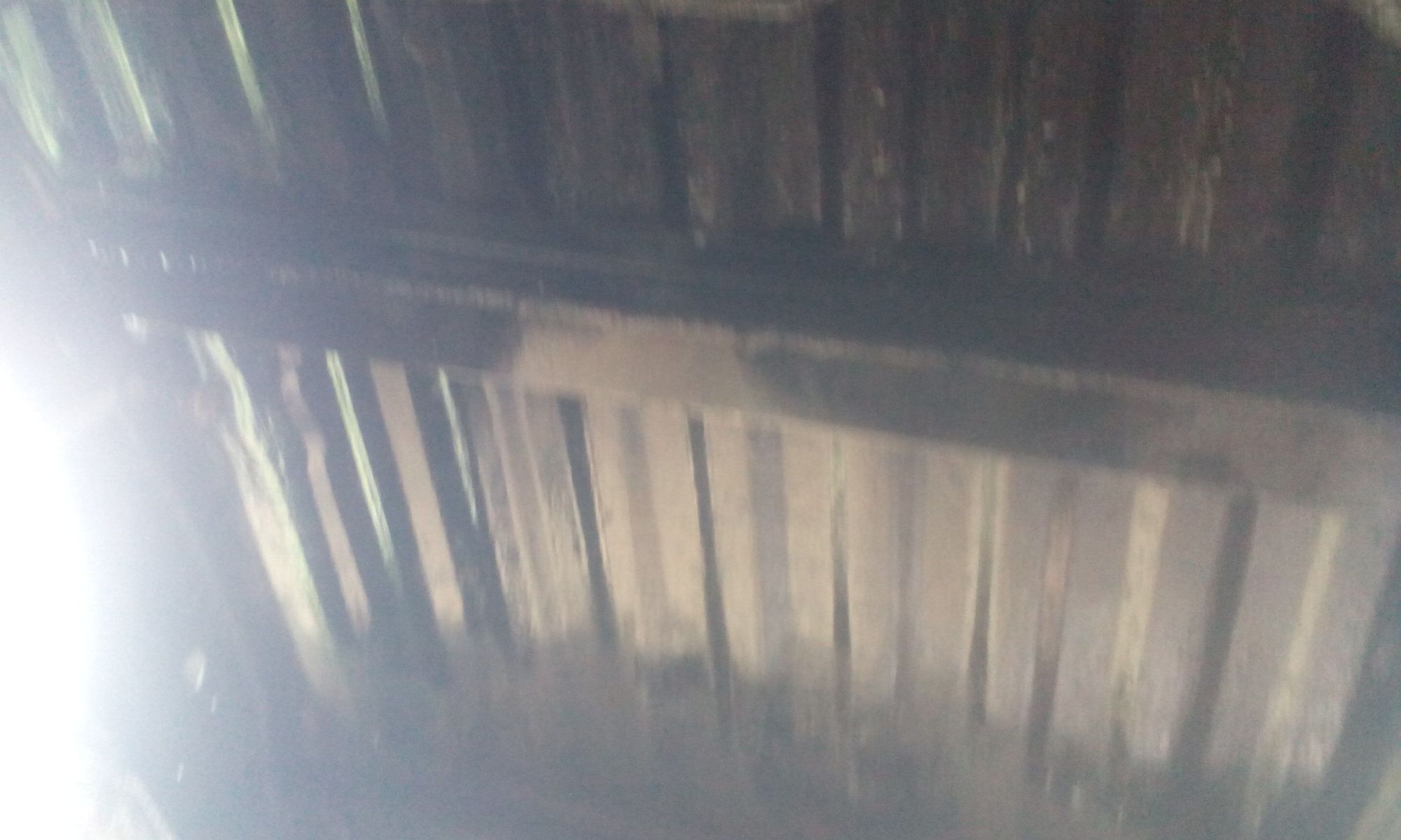

Well noone has replied so I thought I would upload pictures and do a repair my self. Along with wheel arc's

So I removed all the old spot welds cleaned up any rust and por15 the the olde girl. Made box braces out of sheet donated from a local business scrap metal bin they had bent them wrong for a customer and were the perfect size here's a picture of one. I forgot to take a picture when the box was off so I laid on my back and took a picture as best as I could. Worst part of the repair is the spot welds on the stock braces.
