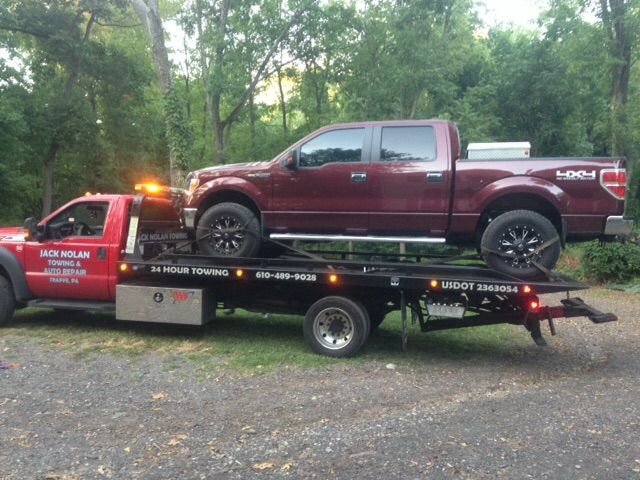

At least it was a F550 Should know something today. The young man in the tow truck thought because of the dead battery it messed with the idle air control settings and maybe it needs to be reset with a diagnostic machine. Hope that's all it is, something simple

He called me. Dead spider in the MAF when he took it apart to clean it. Problem solved haha
