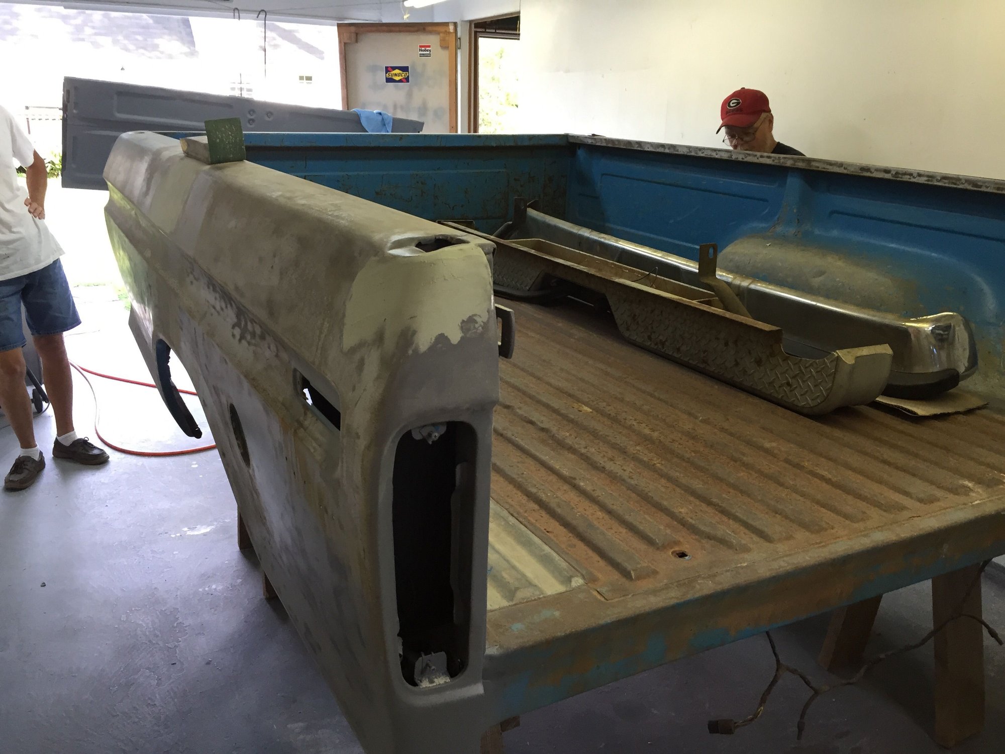

So I was orignally thinking about replacing the original c4 with a Aod but when I took the bed off I found that the 9 in rear end may have just really low gears. I was wondering if changing that would improve my performance for possible Highway driving.
When you peel away the paint you find some body filler.

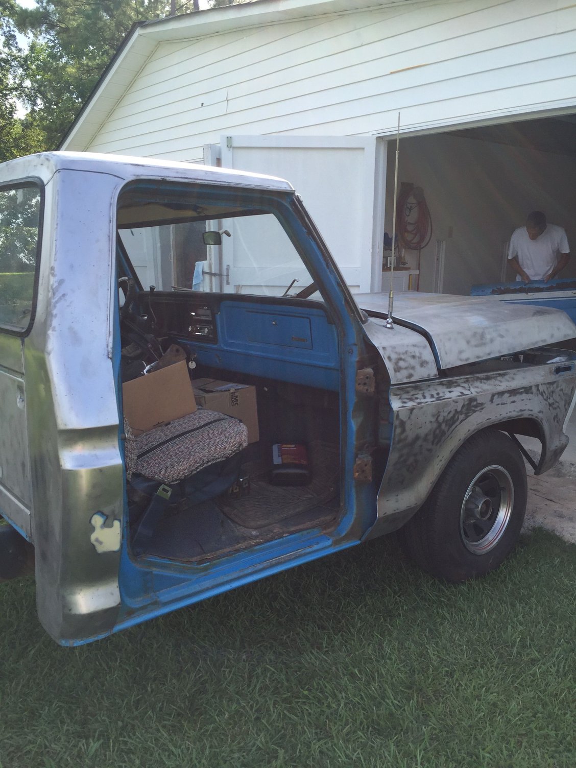

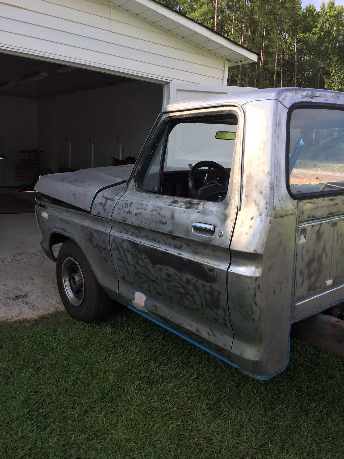

Nice clean body! After all the long years that poor 'ol truck has a right to have a little body filler. She's going to be a nice one! Gary

Nice body... hope you will post a pic after painting.

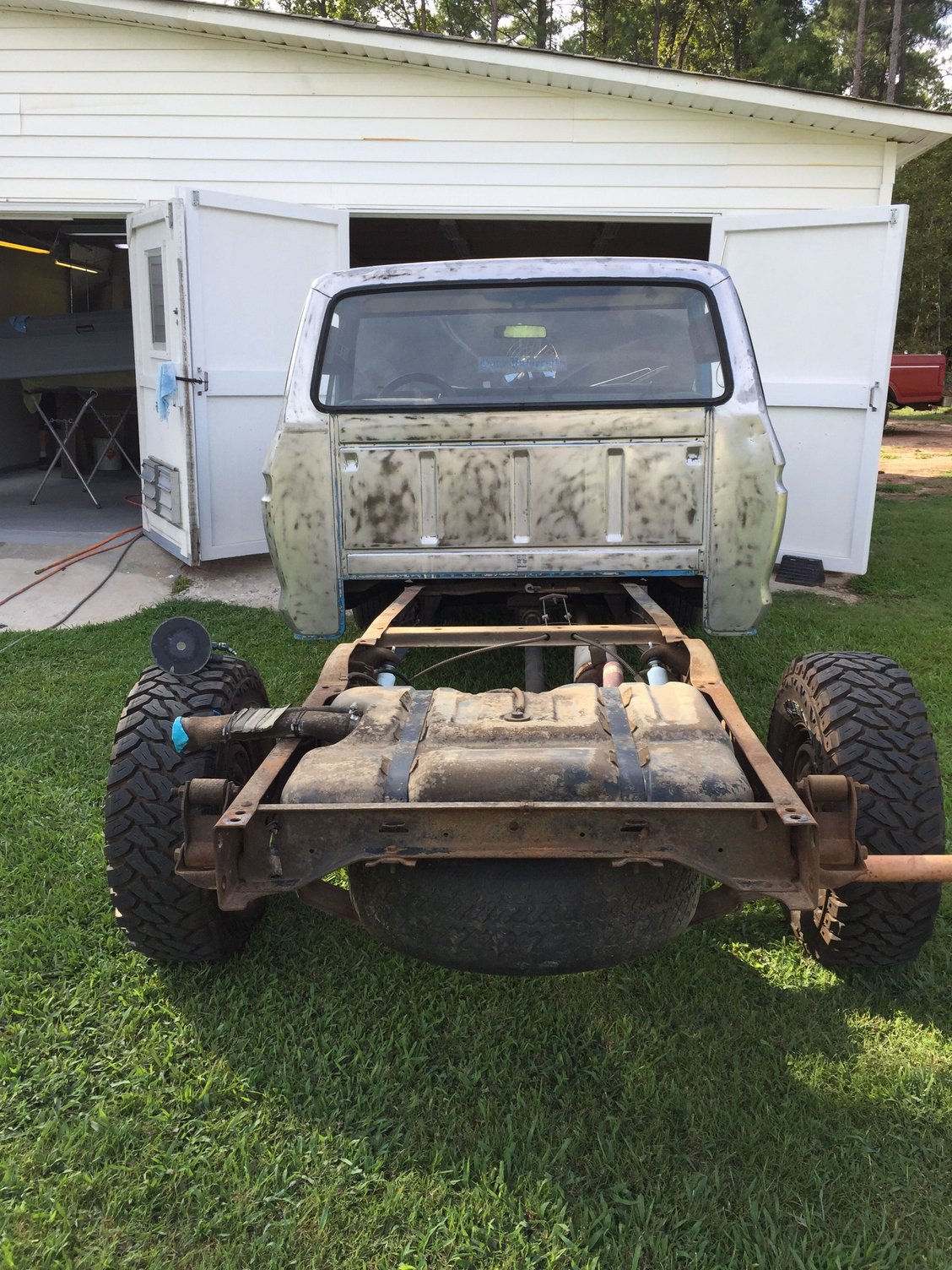

29.5 to 30 in tires. I like 31s but the M/T are really noisy so I am trying to find a decent wide tire size thats close to stock height thats an all-terrain.
Aod seems like the route I am going to go, but I am nervous about the TV cable issue. I know nothing about transmission so I know that a constant pressure valve body will help but I have no experience installing it.
