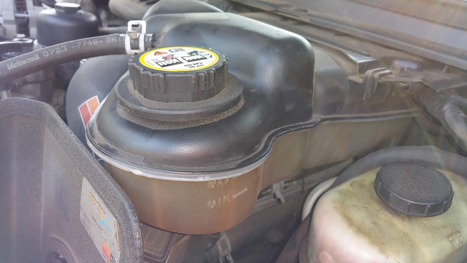

I really need your expert advice since this may be my first Diesel. Please evaluate photos. I did a road test drive about 25 miles. Runs and drives great. Torque Pro app only showed coolant temp at 188. Would not show oil temp. Hard to cold start. New injectors. Has a programmer. Thanks for any help before buying. He is asking 12K. It has 209K miles.

Well head gaskets are good, first signs are white residue at degas bottle.
I can't tell how much coolant is in there? Color looks like ford gold, not preferred but not the end of the world.

Your cap is the wrong height..

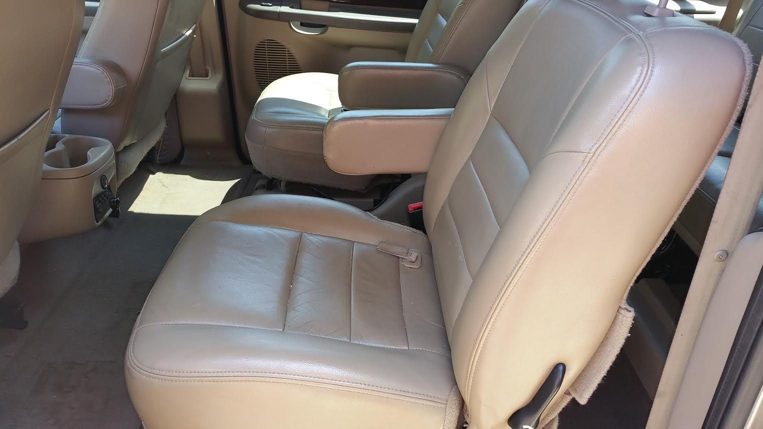

For the interior, swap the 2 front armrest covers. That will put the tore up cover facing down on the passenger side giving you 2 unused tops. No tools needed, the vinyl just pulls off... Easy
