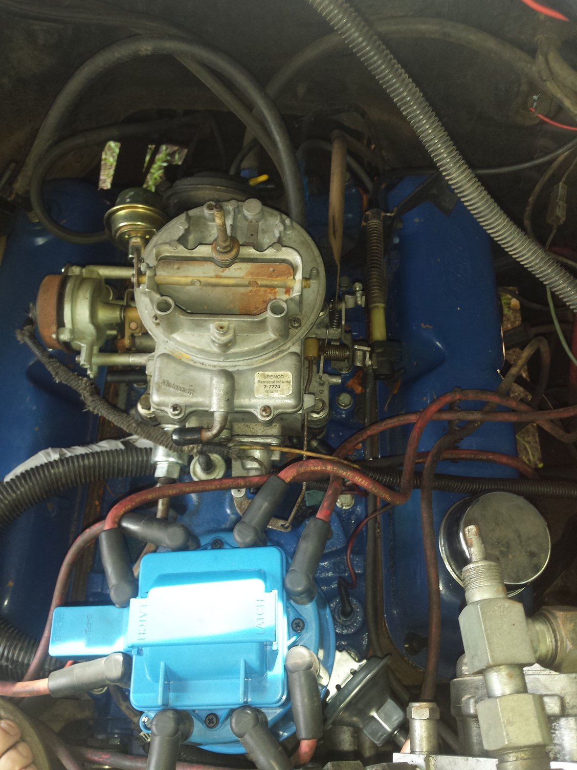

When I purchased the '84 it had a whipped, carb'd 302 with no emissions.
EGR disconnected, no canister and straight exhaust. The engine has been replaced with a '86 302 EFI, converted to a carb with a spacer plate and conversion distributor. The engine runs great when cold but as soon as it reaches op temp, it blows the spacer plate plug off and bucks like a Bronco..pun intended. Do I need to put the EGR system back on it with the canister to enable it to run correctly at op temp? I'm hoping that there is a "work around" for this as I am trying to keep this build as basic as possible for future serviceability. Maybe the pics will shed some light...Any thoughts?
The semi-finished install. New plug wires to follow as well as vac lines.

I currently have this truck discussed in this thread. The egr is located on the carburator spacer plate. It is capped off. I installed an older model spacer that only had an air hole with a plug but on start up the air pressure from the manifold would blow the plug off. Here's what is happening... on cold start truck runs excellent for about 20 minutes at idle. When gear is engaged it shuts off. The carb throttle body door is not staying open once warm it closes as it was when cold. So to restart I have to hold the throttle butterfly open and it will start again briefly. Feels as if it's not getting enough gas or temp control on throttle is not working properly. I want to illuminate the possibility of the air lines bring incorrectly plugged do you have a simple diagram?
