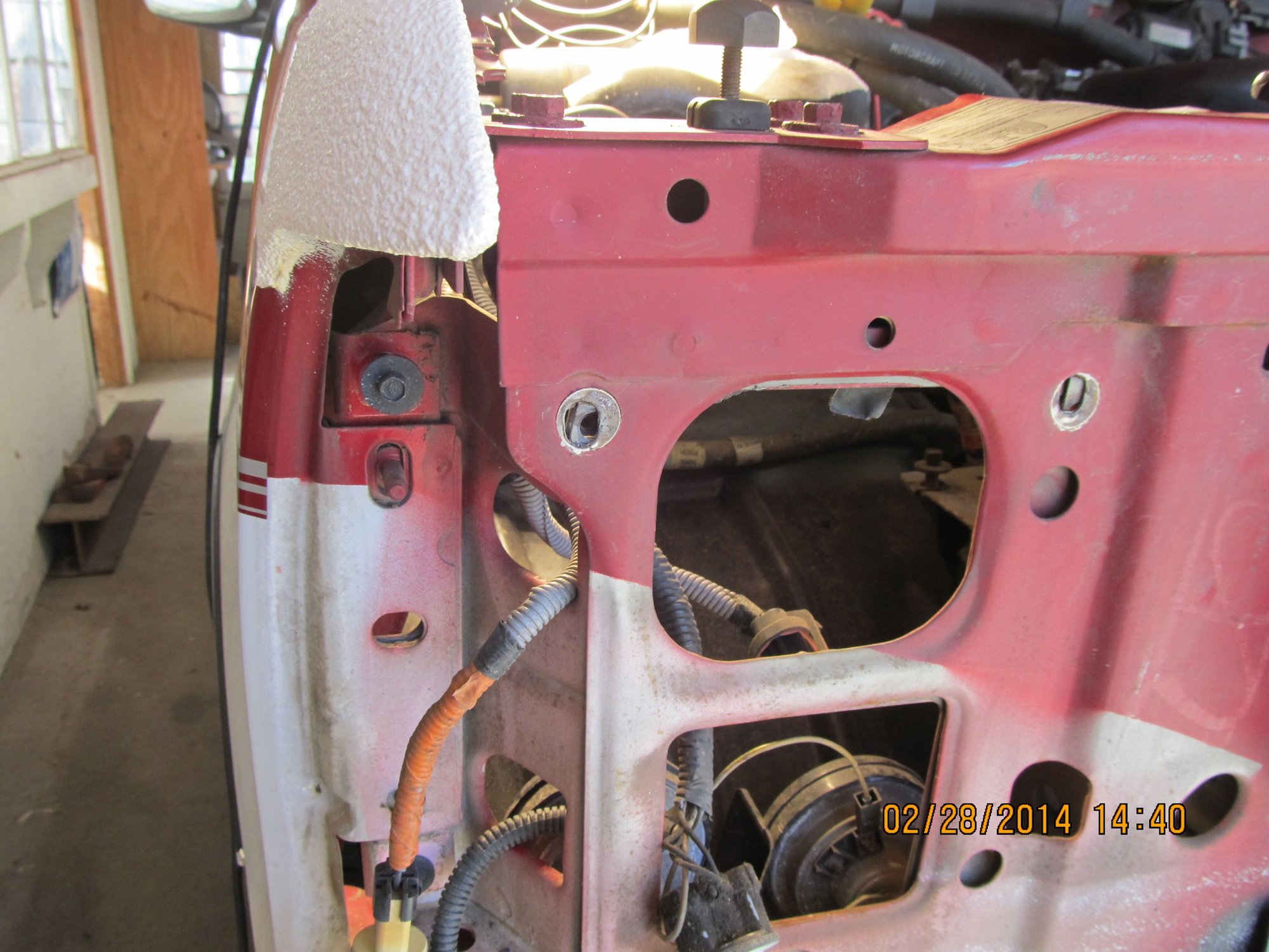

Ford has shims between the radiator support and the body mounts. The radiator support is attached to the fender at the front with two bolts. My experience has taught me the shims are there for adjustment when it comes time to align the hood, doors and fender. I suspect each truck has it's own custom adjustment when leaving the production line. Installing new OEM fenders may alter this spacing. You may play with this adjustment and see what it does for you.
Passenger side fender and radiator support.

Thank you Mike1, and mtcox for your help, especially that picture mtcox. I have mocked it up well enough to book it in to the local autobody shop to have the professionals adjust it properly. This was my first body repair project, and I think it went pretty well all around!! Thanks again guys!!
