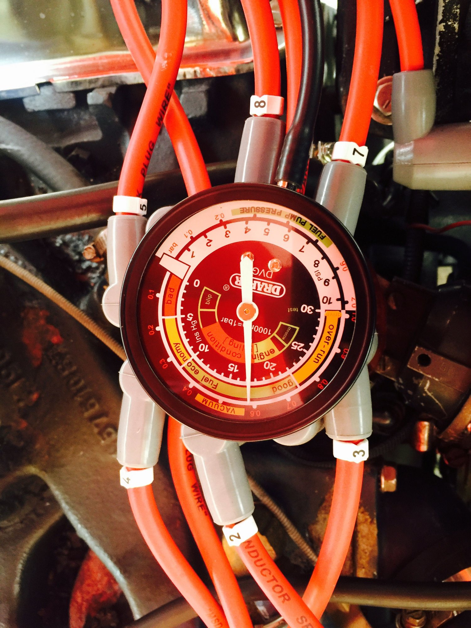

A little update. Finally got a cheap timing light and vacuum gauge. Attached the vac to the header manifold (via the pipe running to the brake servo) and measured after the truck warmed up (have attached pic).
Checked the timing, and the initial reading was around 6 degrees. The previous owner had marked TDC and 10 degree increments on the pulley, i got up close with a light to confirm this was correct.

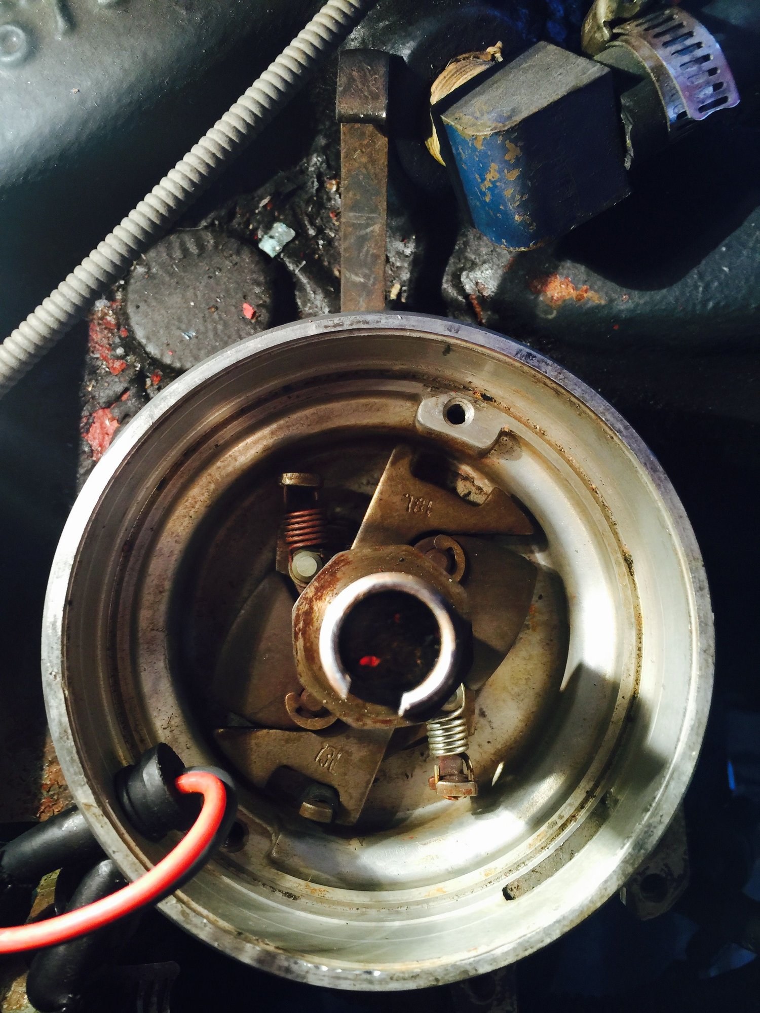

I also stripped the distributor to check that vacuum and weighted advance was in good order, no broken springs etc. I have also added a picture of the distributer stripped and the timing pulley with the marks on.
I played around with the timing, advanced it to 8 degrees and ran the truck down the road, wow what a difference. Still a minor hesitation but much more responsive. I came back and moved the timing to 10 degrees, and while I haven't ran it up the road yet I'm hopeful that the truck will purr like a kitten. I might need to alter the plug gap to stock if it's still playing around.

Try this .Engine vacuum at idle should be 18-20" at sea level. Are you getting this?. Try advancing distributor clockwise at idle for highest possible steady reading, and then back off 1" from that figure. This is generally the optimum initial timing. Ignore timing light for this test.

I'm getting 15 from the vacuum gauge, cant really squeeze anything more than that unless I advance the timing past 10.
