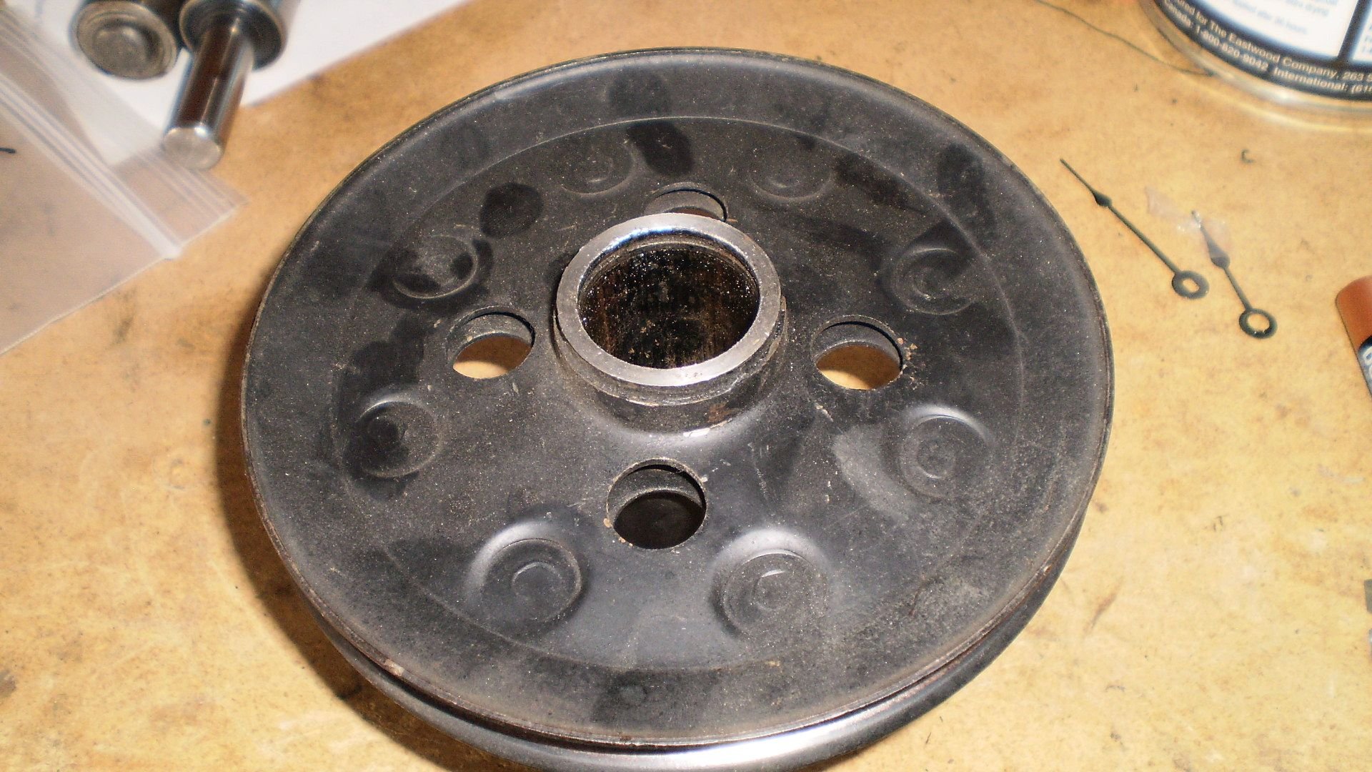

My truck has a car engine with that bearing setup. It's not super hard to replace the bearing, but it isn't super easy either.
First thing I'd do is take off the belt for the fan and see if the noise goes away, which would likely mean it's the WP.
The only replacement bearing is a universal cartridge, NSK #885586, that I got thru Kaman Bearing. Any shop with a catalog should be able to get it. It comes with an extra-long shaft that you need to cut to size.
First the shaft needs to be pressed out of the bracket. Ford capped the inside end of the hub to retain a rubber seal washer. You need to un-cap it, either in a lathe, or by grinding. After removing the rubber seal washer, you'll see a retaining clip on the bore. Now you can press the hub off the bearing while holding the shaft. Not simple with the fan still attached... Assembly is the reverse. The bearing goes in until it seats on two pressed-in bumps on the hub.
