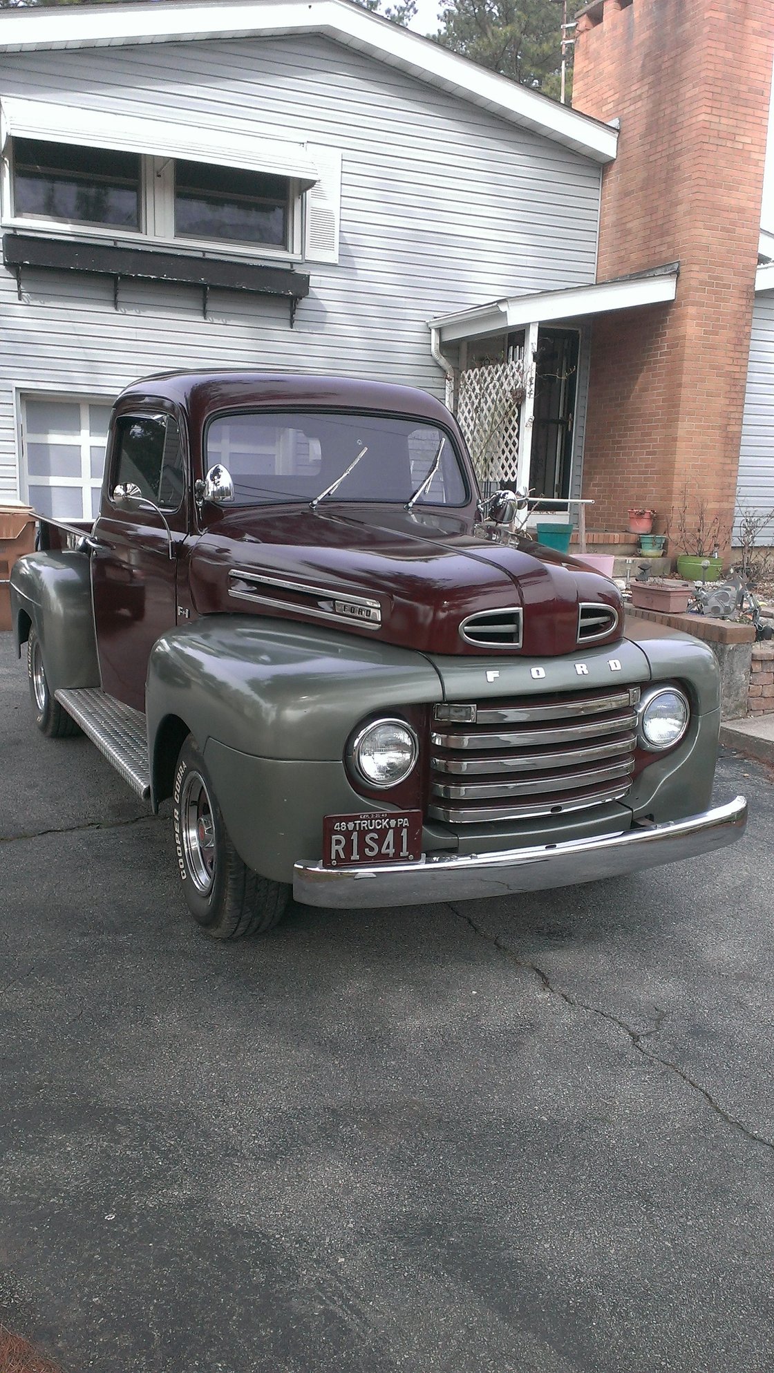

Here ya go, 52flatheadF1: This is the best shot I have showing how the wheels fit the truck.
Looks like this will be the route I am going to take. Nice truck by the way! Last question, is what size tires are you running on those wheels? Are you running larger on the rear?

So i picked up a set of 15x7 ford wheels from a local junkyard. Wire wheel and sanding flap wheel took care of the surface rust and imperfections. Cleaned them all up and applied 3 coats of black and 3 coats of clear. Ordered new center covers so they would shine and new chrome lug nuts. Here is a before/after so far.

Here is the finished product for anyone who has been following this thread. I haven't cleaned the blue crap off the tires yet, but they look great. The truck handles and rides so much better than the bias tires..holy crap! I do have 1 regret, and that is not going taller in the back to get more top end speed out of it, but it is what it is at this point.
