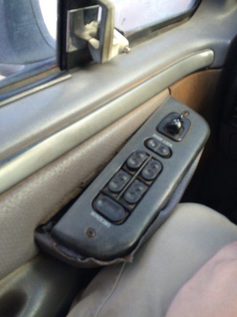

Yeah, I was going to say you'd need to make one for the trucks with power mirrors:

So far there will be three versions:
Power Window/Lock
Power Window/Lock/Mirror
Power Window/Lock/Mirror/ChipSwitch
Originally Posted by Crewcabber
Id be interested in the substrate you are going to use for these. As far as the reinforcement for the screw holes is going to be tricky. If you make it to big it will not allow the bezel to sit flat. Im interested as well.
Thats the war i'm fighting. The screw hole has its own standoff underneath but seems to crack towards the outer extreme angles from pressure points. Perhaps lengthening this standoff will relieve some of this pressure and reduce this cracking towards the pressure points.
On a separate note, this power W/L/M bezel I have isn't cracked like the power
W/L one is.
This one is cracking from the hole for the power mirror switch, one crack towards the power lock hole, another towards the inside (door shell) edge, and another towards the outer (cab interior) extreme edge.
Anyone elses like this?
