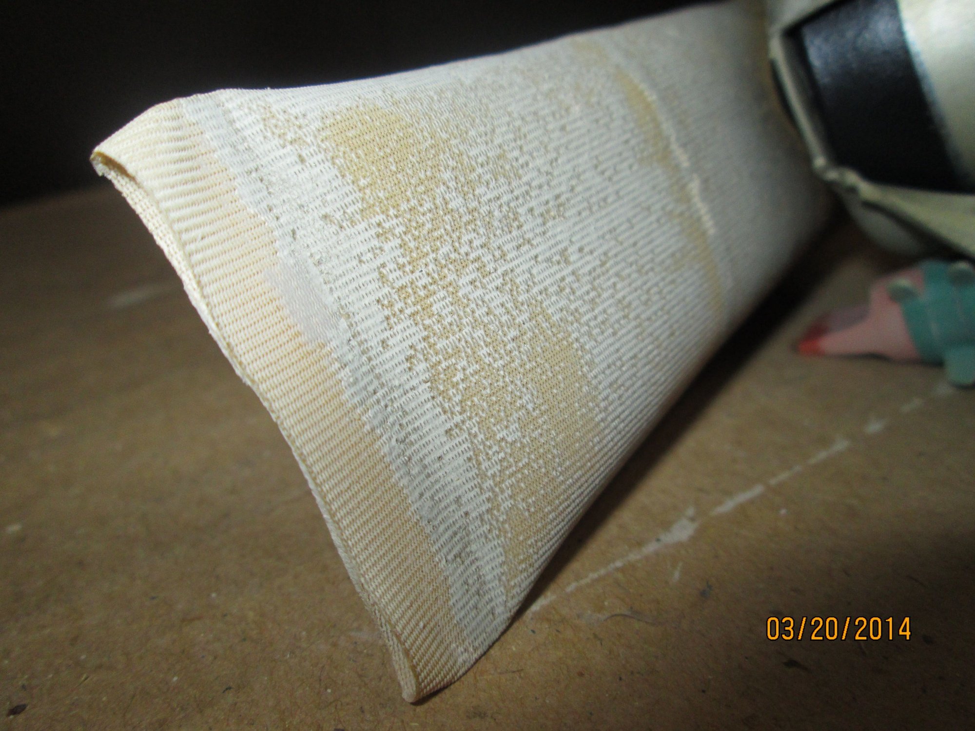

I got my dad's 88 model 302 with dual tanks after it mostly sat for 10 years. Same symptoms, ran great up to highway speeds the it felt like it ran out of gas. When I pulled the tanks down, the filter sock was covered with some white calcium looking stuff. I replaced both pumps and the main filter and it runs 80 MPH all day. The photo shows just a small area right under the pump motor that is clear. jim

I agree. filter first then pump if needed.
