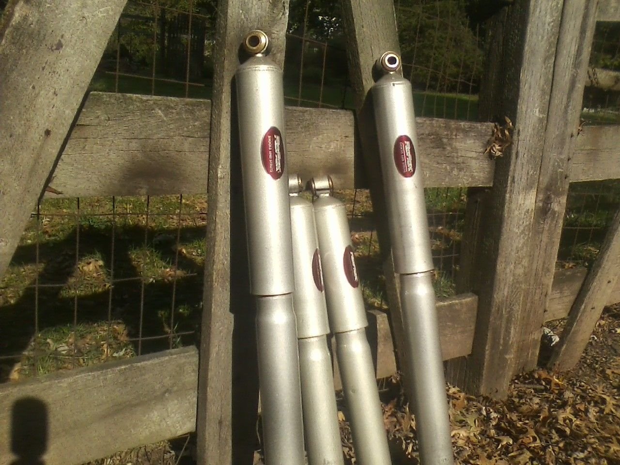

So the project is moving fast now. I was able to finish rust-treating and painting the frame. While the bed was off I also replaced the shocks. I had Monroe Reflex shocks and although they still held pressure and offered resistance, they were rusted badly enough to be near failure. These are 8 years old with 75K miles.
The Reflex shocks had a Lifetime Warranty and it took 5 min at the local PepBoys to exchange them for a new set. I sprayed these with 4 coats of gloss enamel to try and offer additional rust protection. I think they look great:
