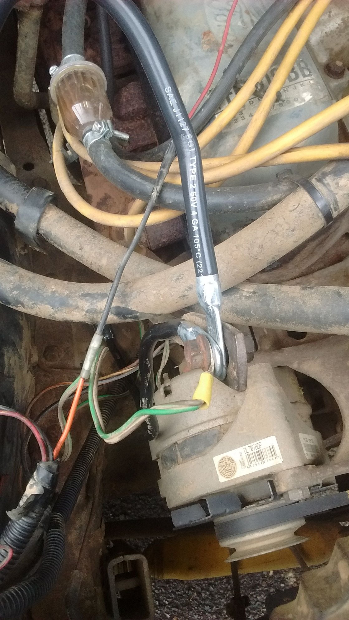

Thank you for the feedback!!! As you guys suggested I changed out the main negative running from the battery to the post were the alternator is grounded to and then replaced the other negative main meeting at that post running to what I believe is the cross member, the previous owner had a 2 gauge running from the battery and a 6 gauge running from the cross member and I could only find 4 gauge as a replacement and I've completely took out the green wire, I haven't had any issues yet, any more feedback upon this issue is still greatly appreciated !!

The post the main negative meets the alternator and other negative cable

Were the last negative chord is routed to that i replaced
Old Jul 26, 2015 | 02:18 PM
Franklin2's Avatar
Franklin2
Joined: Jan 2001
Posts: 56,979
Likes: 2,734
From: Virginia
The above is not the factory location, they would put them directly to the block. But as long as that bracket they are bolted to keeps a good connection to the block, it should be ok like that. The factory spot for the negative wire is somewhat hard to get to.
