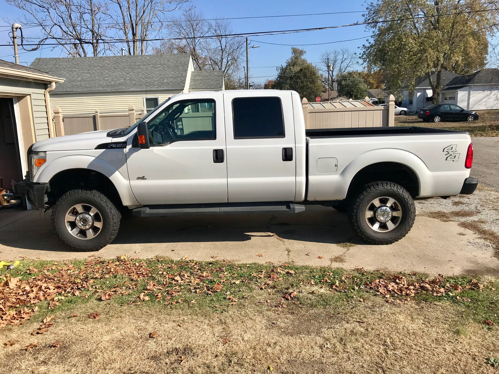

325/65/18 BFGs on my F350. running them at 60 psi.
