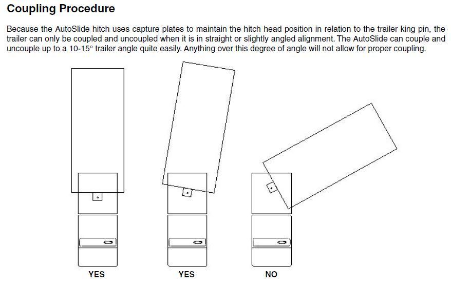

Sorry to resurrect an old post, but had a question for you Ginther...with your experience with the Demco AutoSlide.
I have the exact same truck as you (only 2014) and will be getting our first 5'er soon. It doesn't have the rounded cap so looking at the Demco Autoslide. Couple questions for you if you don't mind sharing your experience with it:
1.) What about backing into a spot and your truck and rig are not straight...so unhooking at an angle with the Demco?
2.) With the weight issue...ever use the jacks on the 5'er to lift the hitch above the truck bed...then lower onto say a raised cart and then disengage from the hitch pin?
Just some questions I've thought of. Too bad you could try some of these hitches prior to ordering. Especially if you are a newbie to 5,ers, like me.

1. Hooking and un-hooking need to be done fairly straight because the way the pin box capture plates work.

As far as hooking and unhooking at angles greater than 10-11 degrees...have you ever found yourself wishing you had that capability or is it pretty much not needed.

So far.... knock on wood..... I've never been in a spot where I couldn't hook/unhook nearly straight on.
