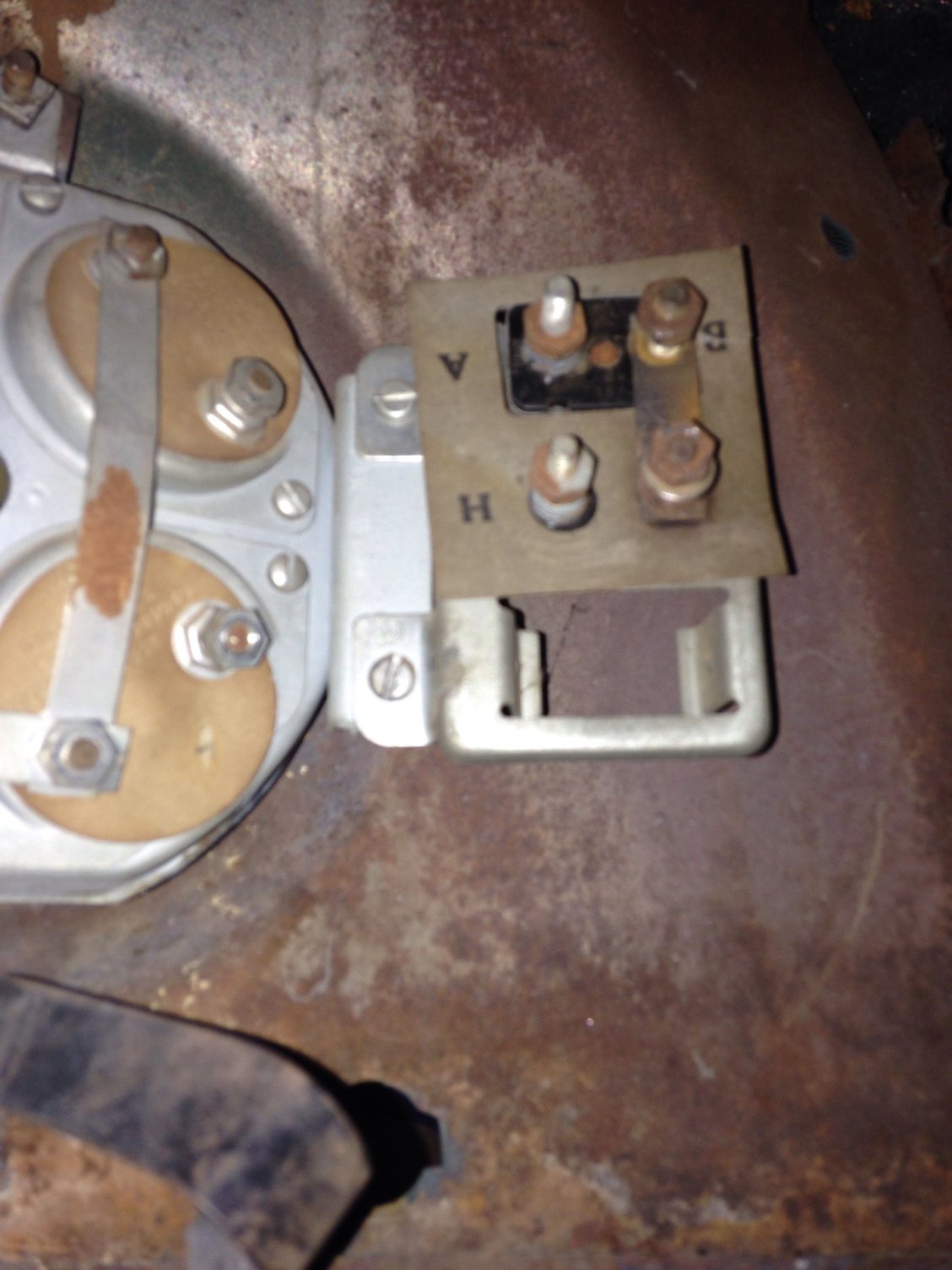

I'm sure this has been addressed quite a few times but I couldn't find it within my search. I'm using my original gauges on my 52 Ford with a 12 volt system. I know I need to get voltage reducers to operate the gauges but my question is how many do I need? Do I need 4, or do I buy just one to wire into the apparatus to I've posted below?

Those are the circuit breakers, you don't connect the voltage reducer to them, you connect it to the ignition switch. Make sure your gauge cluster has a good ground.

You only need one voltage reducer if you get one designed to supply all three (fuel, oil, and temp). The ammeter doesn't need power.
