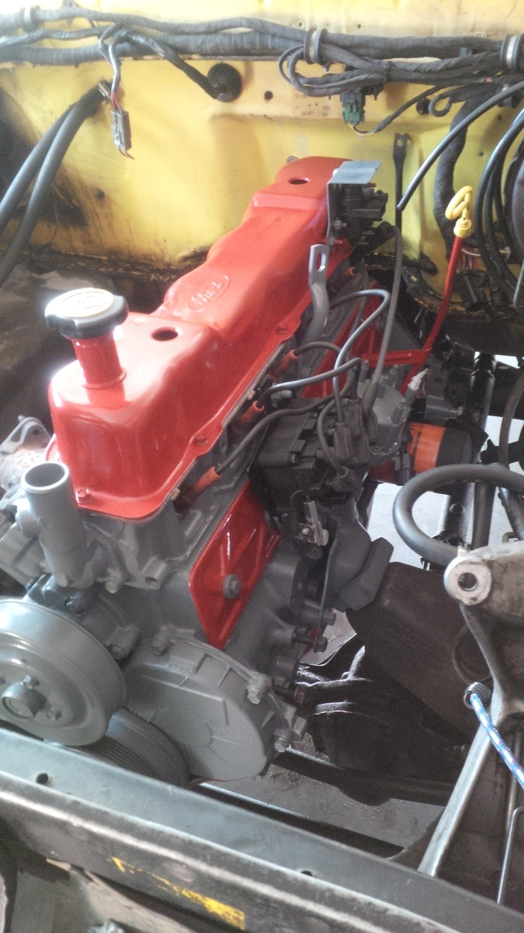

Ok, if we're going to get crazy, I do have a Ford EDIS-8 (Electronic Distributorless Ignition System 8-cyl) setup for my 5.0L EFI engine. The modules also come in 4 and 6 cylinder versions.
Crank trigger/harmonic balancer before I prettied it up.
Crank trigger/harmonic balancer (after) on the left, cam position sensor (takes the place of the distributor) in the middle, 8-cylinder ignition module on the right.
Not shown, the VR (Variable Reluctance) sensor that mounts to the timing cover and reads the pulses from the teeth on the trigger wheel.--not that the engine would hold up to it, but this system's spark delivery is accurate to 10,000 RPMs.
