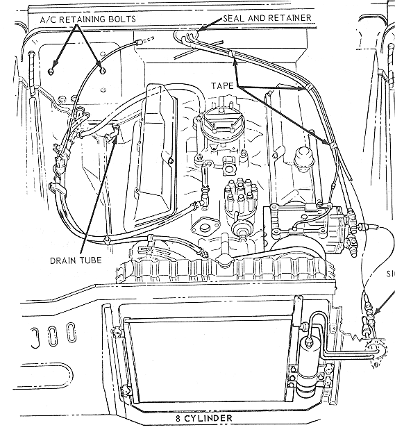

I have a 1970 1/2 ton with a 390 and I was wondering which way the heater hoses hook up to the heater core from the engine and if there is a wrong way?

Out the intake to the heater, out the heater through the control valver and in the pump.

Yep!
https://www.ford-trucks.com/forums/a...&postid=612884
