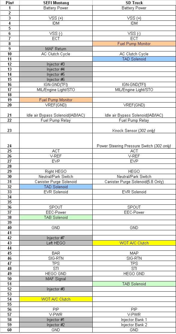

That is part of what you need but not all of it. These pre 89 EFI mustangs were SD like your truck but they were unique in that they still had sequential injection and dual O2 sensors, but the truck SD system is batch fired and only has one O2 so you still need a bunch more wiring. Here is a spreadsheet showing the differences in pinouts between the truck and Mustang PCM, Pin #s in grey are wires you have to add and Pin #s in color are wires you have to move.

Thanks for the info, didn't know that about the SD mustangs. I found this kit on eBay: http://m.ebay.com/itm/301673310182 seems like this would be a much simpler option even though I would still need the intake tube from a maf truck. What do you think about this one?
Old Jul 10, 2015 | 02:18 PM
Conanski's Avatar
Conanski
Joined: Jun 2006
Posts: 31,930
Likes: 1,499
From: Ottawa, Ontario
That is a more reasonably priced kit with almost everything you need, if you can source the intake Y pipe and an arbox that will fit that MAF meter from a junkyard you're all set. You should ask them what PCM is inciluded in the kit.. hopefully it's an A9L or A9P Mustang PCM.
