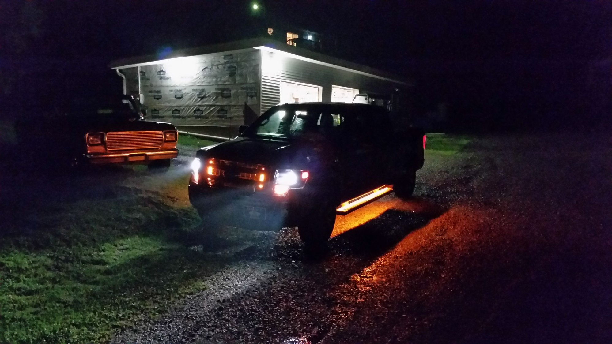

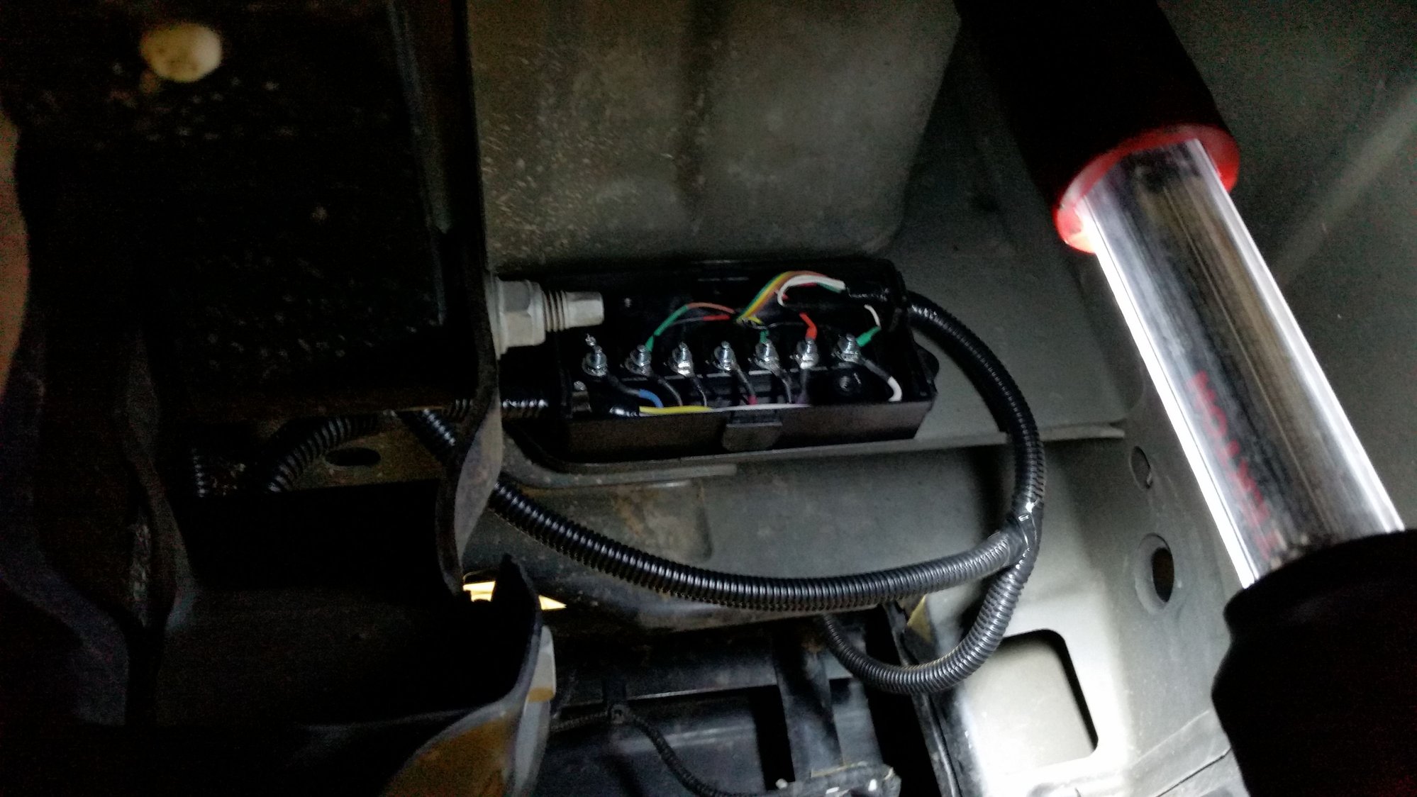

So ever since I got the new truck I wanted to put led lights on it. I came up with an easy non hack way to add all the lights I want. I bought a 7 wire fifth wheel wiring adapter to plug in the factory 7 wire harness. I ran all wires to a waterproof junction box double sided taped to the bed crossmember. Then I ran all my wires to the junction box. No cutting, drilling, or damaging the truck. I used led adhesive back amber strip lights for the sides. It's about 7feet per side. The leftover foot of the roll I split for the grill lights.

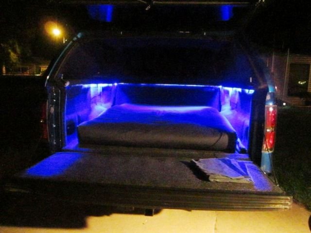

I've wanted to add some under carriage lights to my truck too. It's flame blue so I want blue lights under it, but I don't think that's legal. Instead I put some in the bed of the truck. Since it has a topper, BedRug and a futon, I call them mood lights.

Mine are just adhesive backed LED strips...what did you use?

The back is one of those running, turn signal, backup led combos. The sides and grill are the adhesive backed strips.
