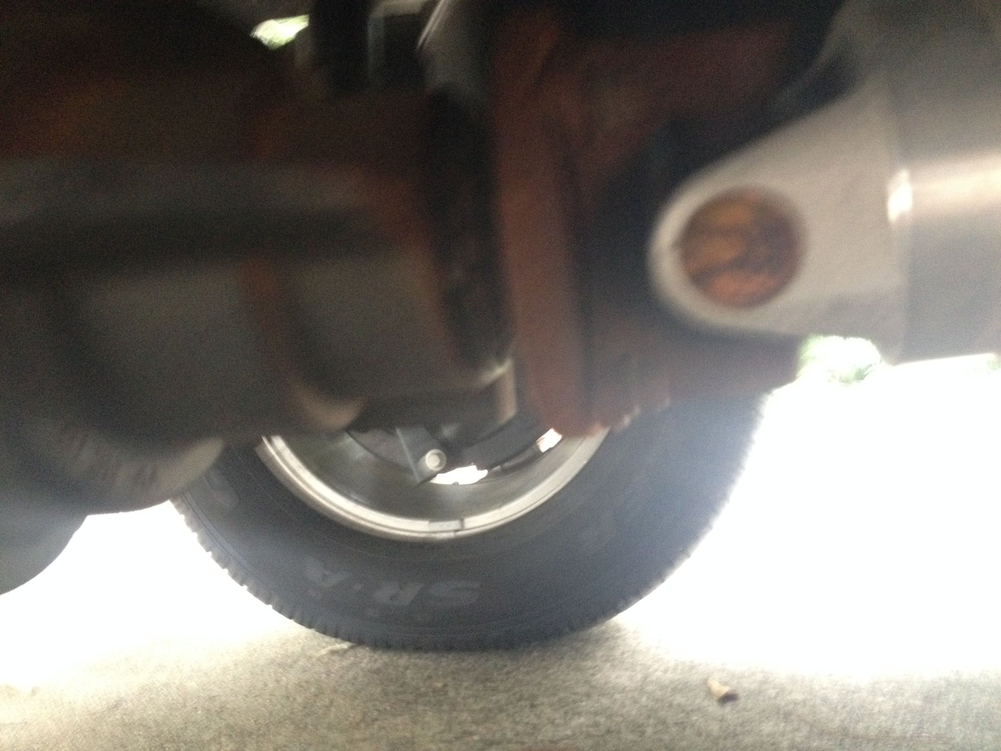

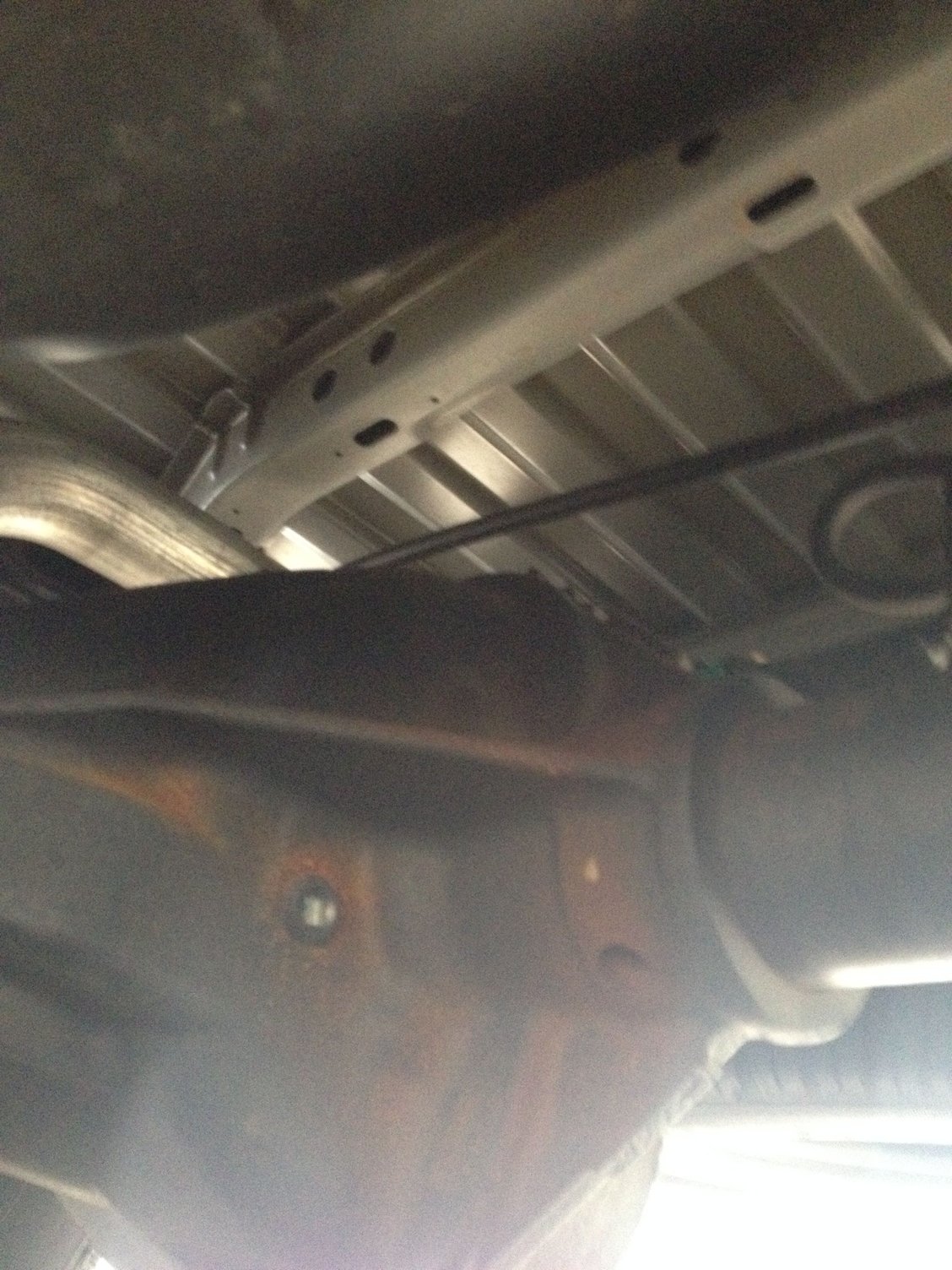

I purchased my new 14 F150 EB XLT 4WD two weeks ago. Just noticed some rust on components on the undercarriage. Is this typical or should I be concerned? I know I do not like the way it looks, especially considering you can see the rust on the rear axle just by standing behind the truck. My previous truck was a 2012 Tundra and with the exception of typical rust around the brake calipers, it was spotless under neath. I appreciate any advice!

I'm not crazy about how it looks either but it doesn't strike me as something that'll cause any issues.
I'd wire wheel it, prime and paint.

It's pretty typical. Most of the stuff in the pics is uncoated steel, like the diff and such.

I quite normal for the North East to see a truck fairly new with the bottom coated in surface rust.

Maybe it's a little early to have that showing, but after six months around here it would look like that anyway. Doubt your dealer will "take care of it", and not sure how they would even if they were willing.
Could have gotten a lot of that being trucked to the dealership if it was pulled in salty weather.

My 2012 doesn't have near that amount of rust on it with over 80,000 miles. If it did I would just spray some East Wood Rust Encapsulator on it & be done with it. That is some pretty heavy steal, so no worries about rusting out, it's just cosmetic.

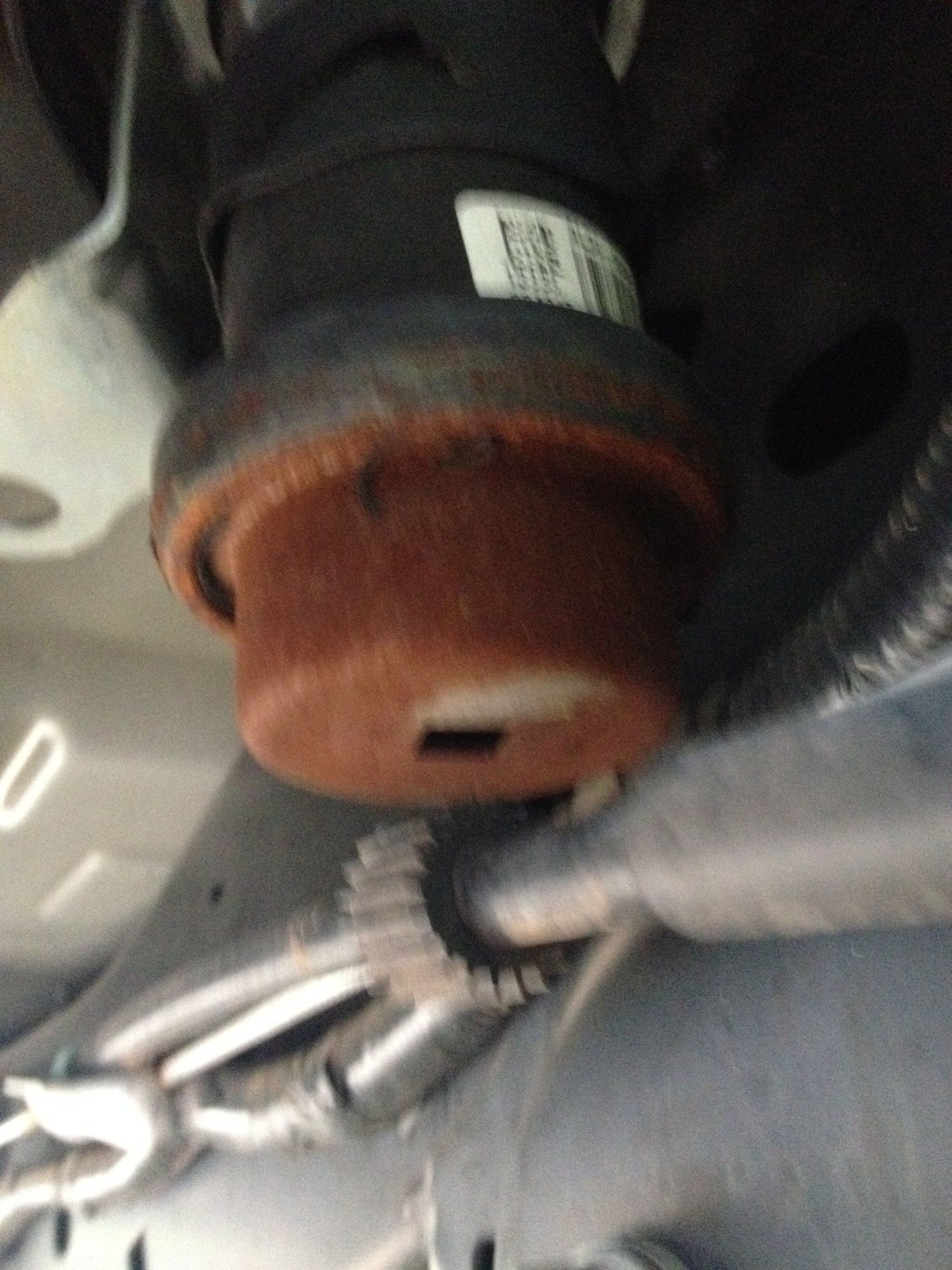

I'm a little worried about that body mount but otherwise it all looks like typical weathering for a vehicle on the lot in my parts.

it's not uncommon around here for the axles, steering box, tire rods, and driveshaft yokes to be rusty, but yours is the worst I've seen.
