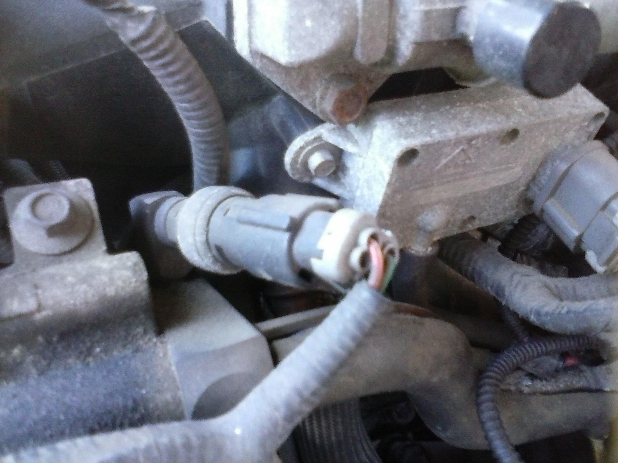

also what are these?
Old Jul 3, 2015 | 01:08 PM
Norsegod127's Avatar
Norsegod127
Joined: Feb 2015
Posts: 101
Old Jul 3, 2015 | 01:09 PM
Norsegod127
Joined: Feb 2015
Posts: 101

Norsegod,
First Picture is an A/C pressure relief valve that will blow off the a/c charge if the head pressure exceeds maybe 440 psi, like a blocked condenser, failed fan or shroud, etc.
Second Picture is an A/C pressure sensor for the low side telling the system there is enough refrigerant to activate the compressor.
Third Picture is a Throttle Position Sensor to tell the ECU how much you are stepping on the pedal.

Originally Posted by ranger pat
Norsegod,
That's not a pressure relief valve, and it does not allow any refrigerant to blow off. It's a high pressure switch, and it makes the compressor shut off if the pressure gets too high, BEFORE any relief valve opens.
