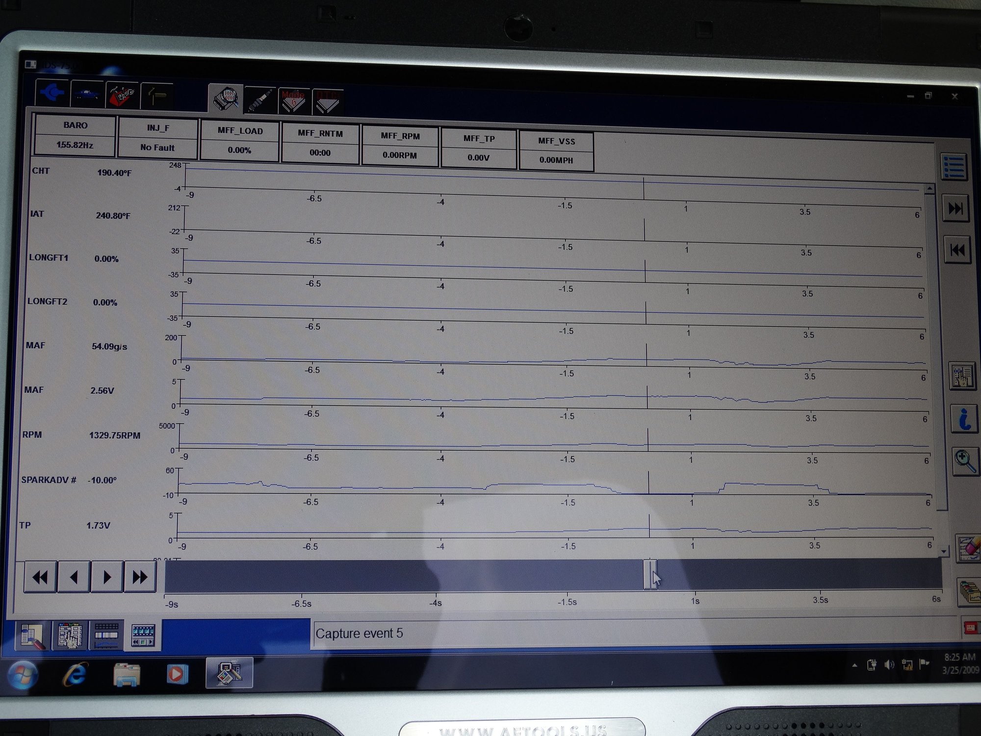

I have recently had access to a authorized Ford IDS scantool and during the live data playback while driving under load, the PCM retards the timing at 1200 - 2000 RPM to Negative 10 degrees. Before that RPM the truck runs great. Above 2000 RPM the truck surges on acceleration all the way to 4500+. The PID's for all sensors read normal when the timing retards. The firing for all cylinders shows 100%.

For some reason, this truck has a serious lag time to flash a CEL.
Probably a Federal OBD1 calibration. Check the emissions label on the underside of the hood.
Look at your IAT value.

Like mentioned above the timing is being pulled because the motor thinks the inlet air temp is super high. It should be integrated into the maf so check the pinout and output voltages. You may need to replace the maf and/or check your wiring.

Thanks for the reply. One questions: if driving with the MAF unplugged and the same timing issue occurs at the same RPM, would the MAF still be the culprit or am I back to PCM? At this point I will try both as well as inspecting the wiring.
I have never had to replace a PCM before, does anyone know what needs to be done regarding a sync to the original? I know of the tear tag number to use when ordering, but does it just plug in? The odometer is mechanical.
Thanks for the heads up on the IAT. I seemed to have overlooked that as I was too focused on the Timing.

You can unplug the MAF and FMEM should substitute values to make the truck run. Perhaps FMEM is seeing that IAT value and causing the timing to be pulled and causing the symptom.

Unplugging the maf will load a failed maf table, should run pretty poorly. You can unplug at idle and see if the IAT changes. But otherwise it's in the maf so I would start there. before the PCM.

Thanks for the reply. Yes replaced MAF, Wiring to ECM looks perfect (continuity / clean). Timing goes to max retard of -10 deg at the same RPM just as before. Reading on IDS software still way hot on the IAT just as before. With software on, unplugged MAF shows only a 30 degree decrease. MAF attached and compressed air to cool (not too close) and a laser reading on the MAF hot wires shows IAT to be 90 degrees, IDS stated 250 degrees. We confirmed today that the transmission is not trying to shift at the point of the timing issue.
The ECM does not throw cel's ( strike 1 )
The IAT is innacurate on the old and new MAF's (strike 2 )
The timing retards to max with no sensor fluctuation at timing retard (strike 3 )
The ECM is out.
I will post what I find.

It was the ECM. Replaced it and the truck runs better than it ever has. I would have never been able to track this problem down if it was not for the Ford IDS scan tool live data and the replies to this post from those who took the time to post their reply / advice on the topic.
