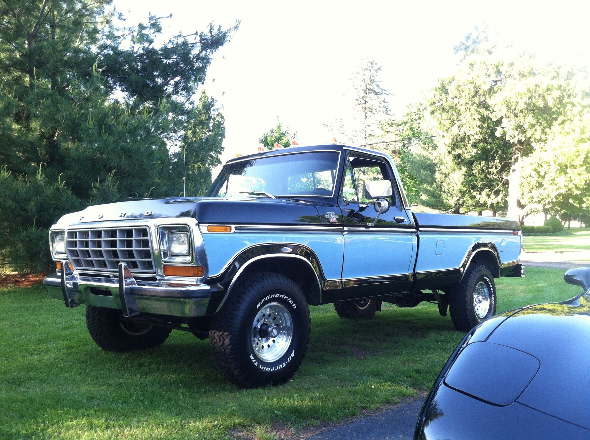

Here's the truck by the way

Beautiful truck.
Make sure you flush all the old fluid out of the system too...
