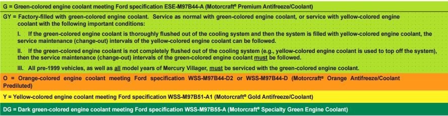

Can't find it on their web site....
Just found this...
Guess I need the green for the Expy and the Yellow for the Big Ex.
Looks like the VC-7-B is the one I need, right?
