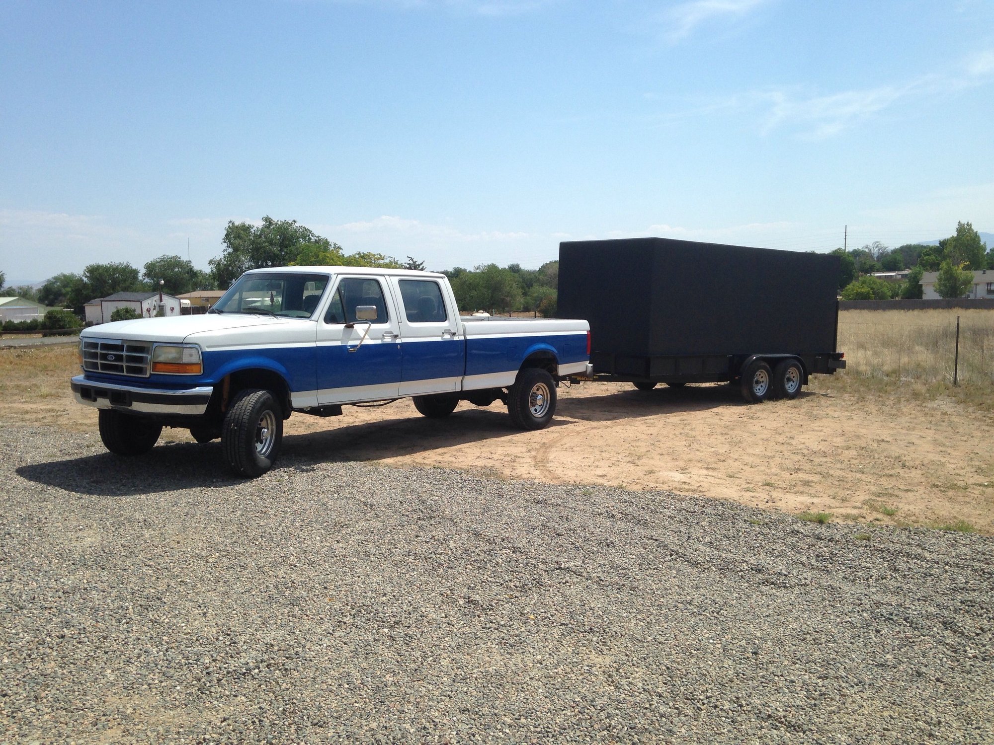

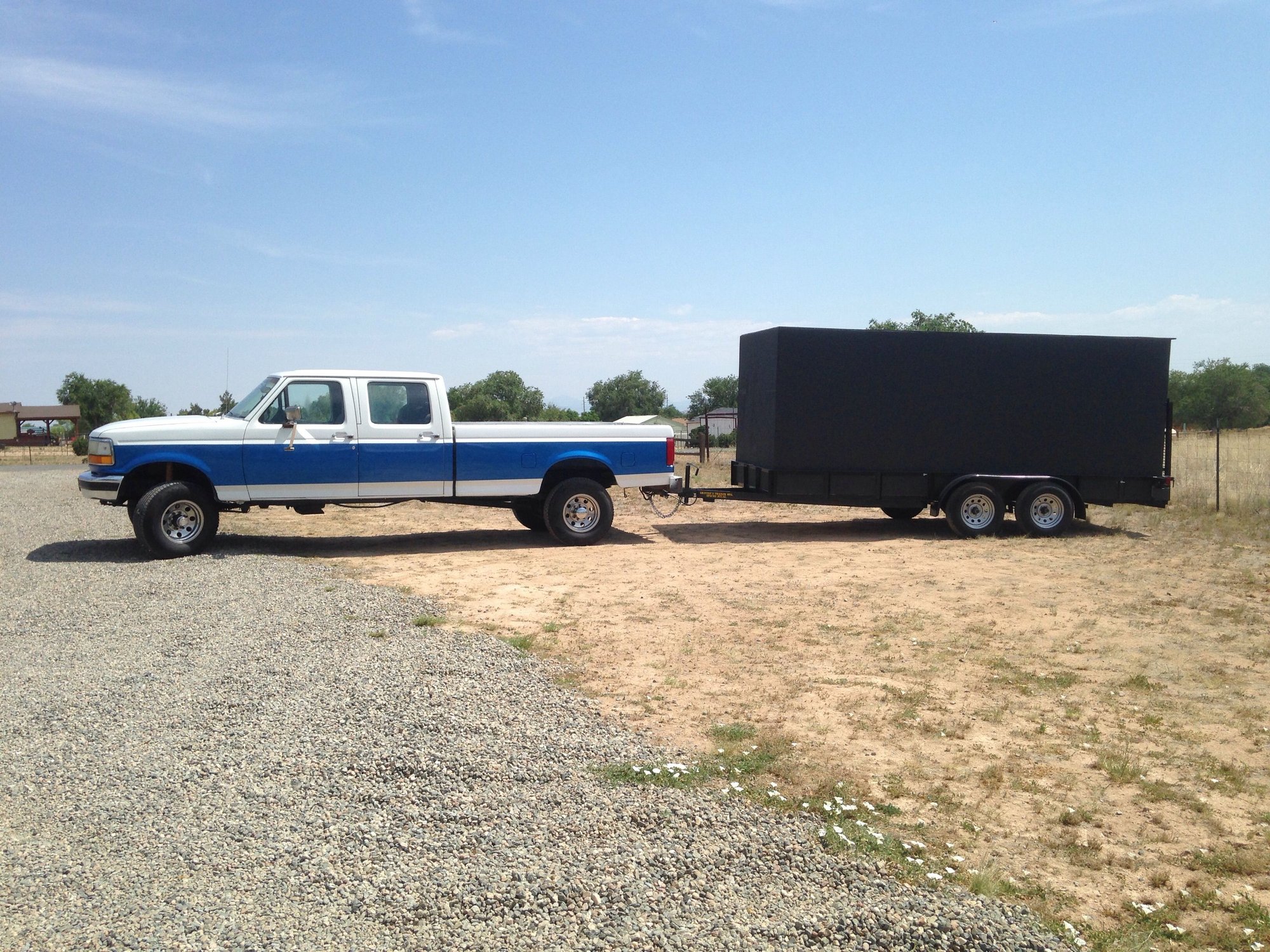

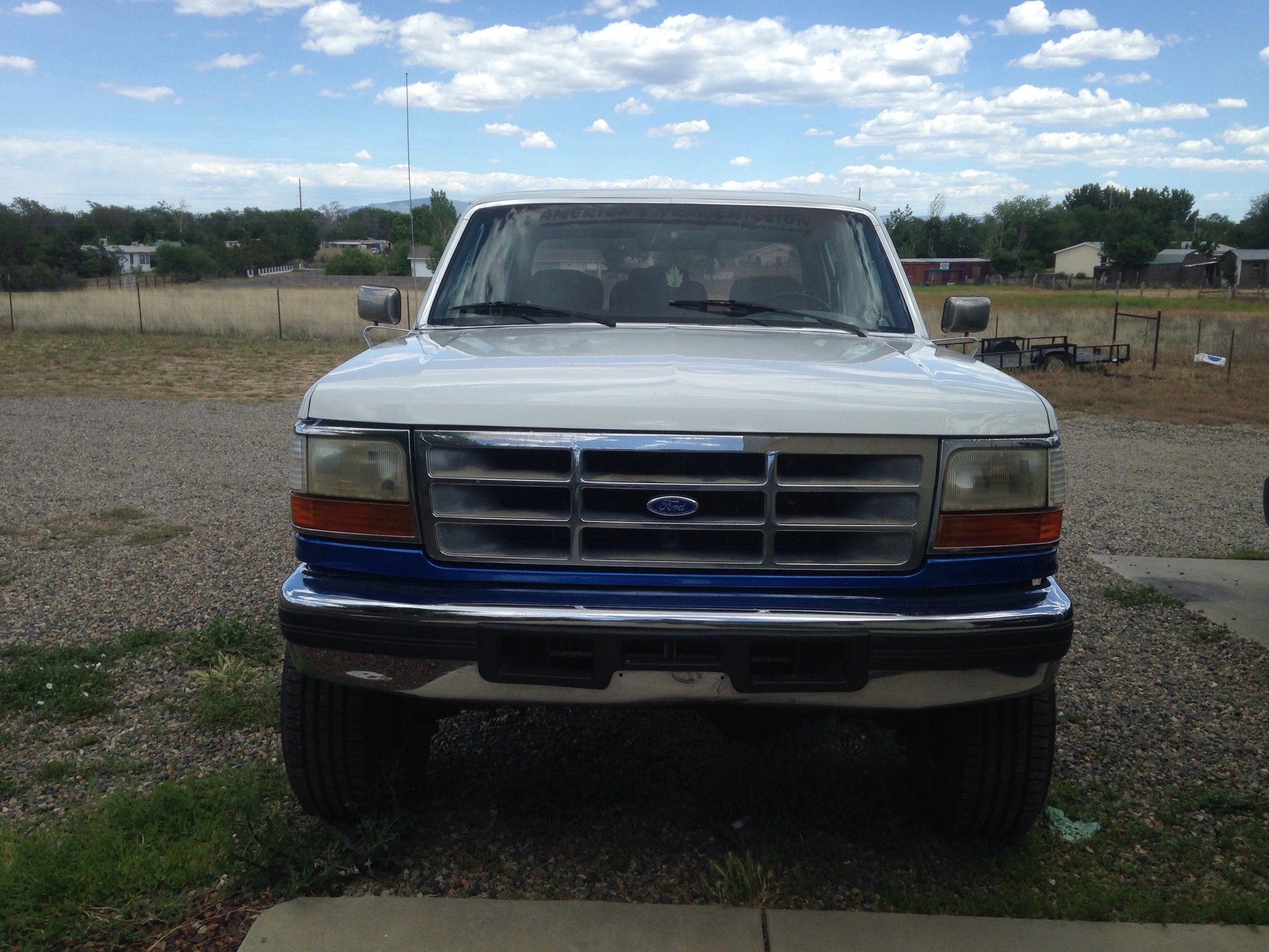

And since you were all so helpful here are some pictures of the truck and trailer I've been talking about. Hopefully these work.
