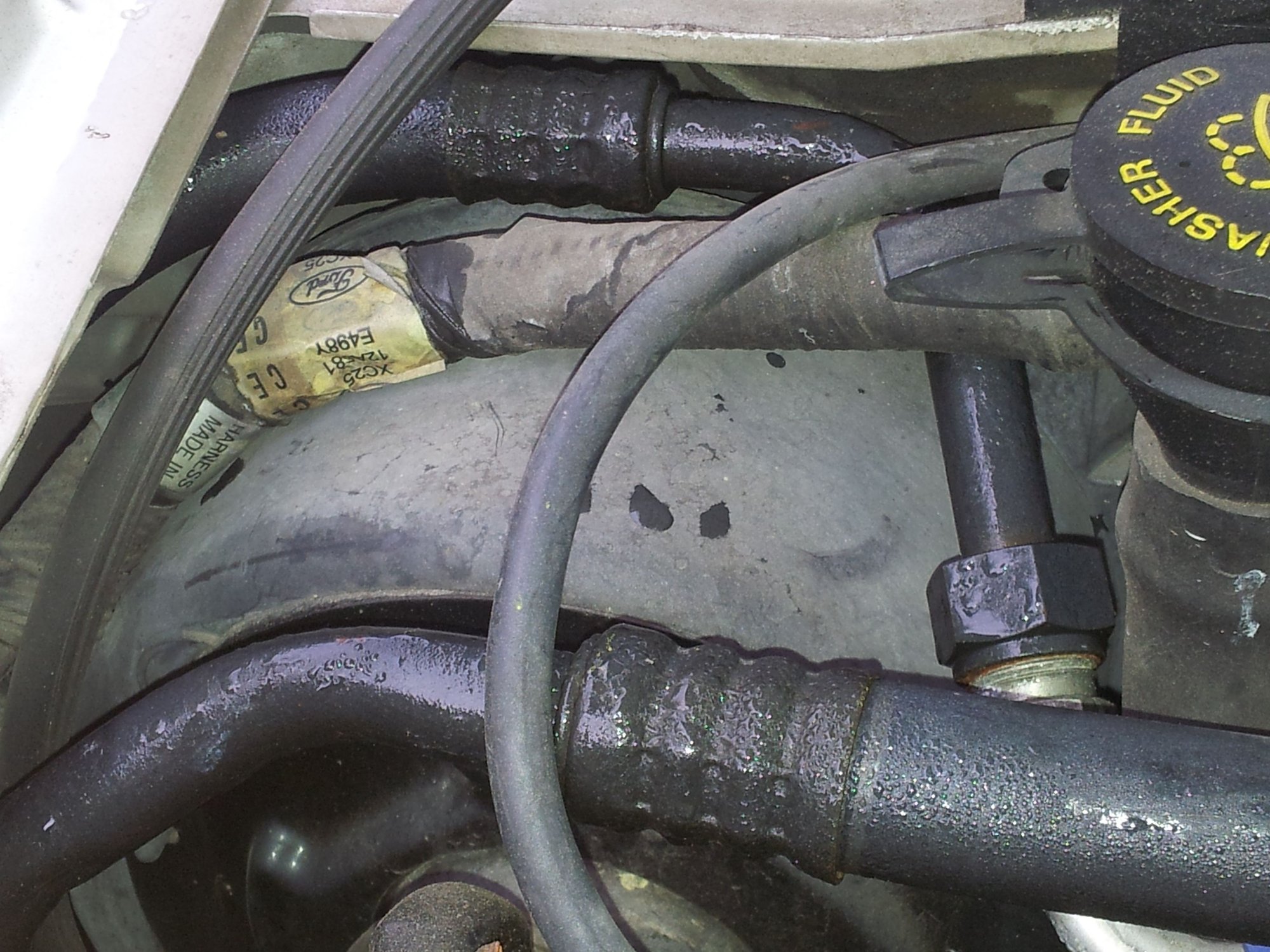

Here's some pics of the AC lines just a few minutes ago. AC on MAX - blower Max - output temp I'd say ~55 deg - ambient air 85 deg
There's definitely a water build up on the lines. Don't know if it is normal. I didn't see any icing. Just finished about a 10 min drive.

Condensate water on the metal lines is OK. With the medium temps and high humidity in your area, water will collect on any cold surface.
Have you got access to a gauge set to check high and low side pressures? That would nail down a low gas level quickly. The key is the sudden reduced airflow from the vents and after a while the airflow returns. When that happens, if you switch to medium heat on the selector for a minute, then back to Max AC, the airflow and cooling should return quicker.
Another item that can be the problem is the pressure sensor on the evaporator input that switches the compressor clutch on/off. If that sensor is stuck on, the pressure into the evaporator drops below the point where ice forms on the evaporator, blocking airflow. A gauge set will quickly point out that problem.
The cheapest thing at this point would be to button up the vehicle, run the system at MAX AC with the engine at higher than normal idle, then start adding a can of gas. It the compressor starts cycling ON/OFF at about 10 second intervals, that should do it. Again, a gauge set is invaluable in testing the system but this is the next best option.
