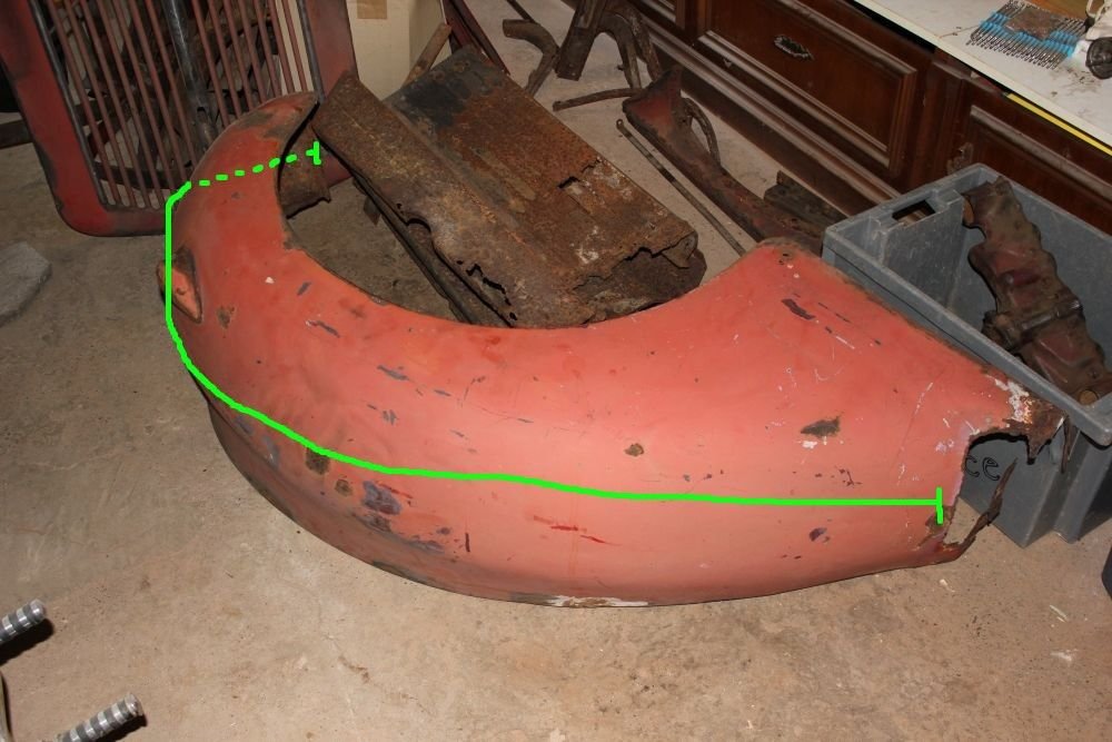

very difficult to measure. First I tried to measure the hole in the fender up to the point where enough metal is present for welding:
Right fender: 7.9 inch
Left fender: 10 inch
Then I measured the long way from the good front end along the arc of the fender (see pic):
Right fender: 83.8 inch
Left fender: 82.6 inch
I can't say what is more accurate. One inch is missing, when you compare both methods.
