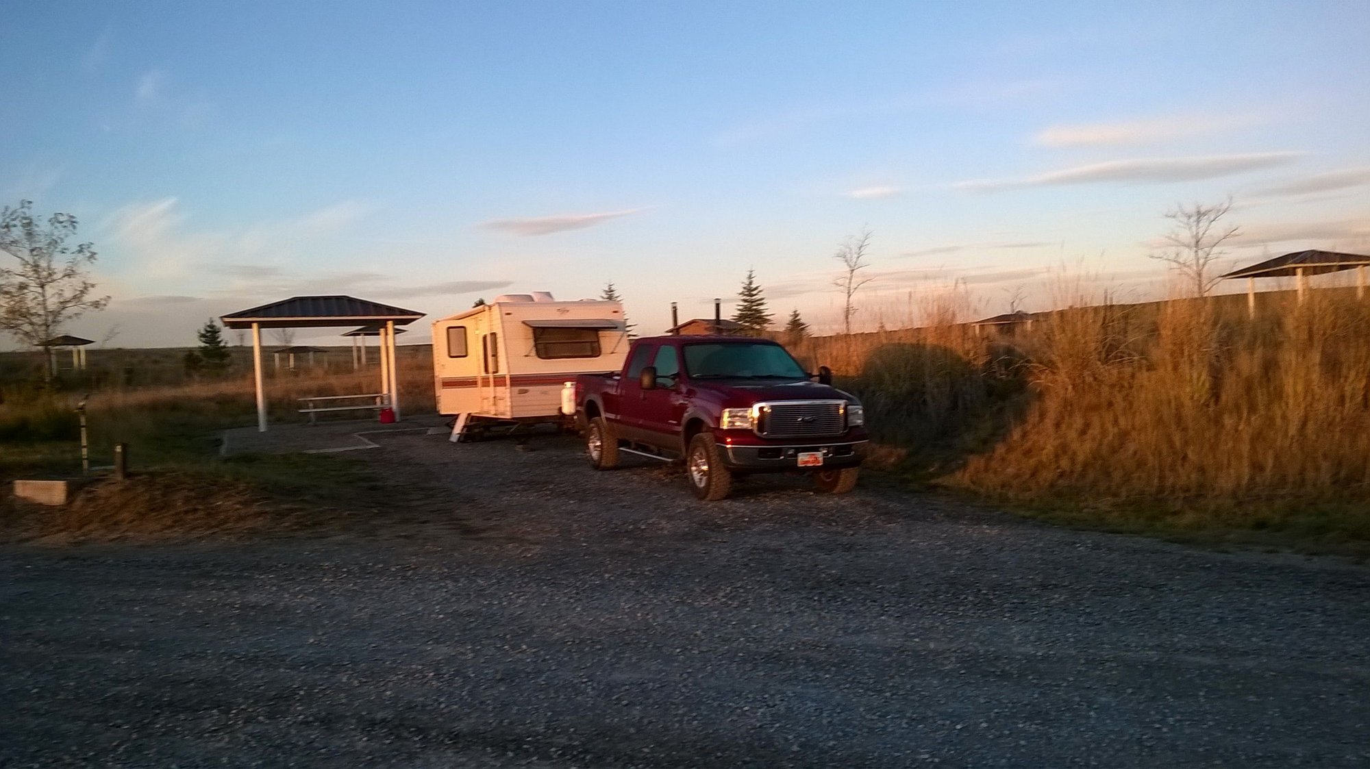

Here's my rig 1993 cobra, this is the last year I'm going to be pulling it. Upgrading to something 2005 or newer. I'm sorda glad I started off my camper adventures with something older and more forgiving for screw ups with stuff and leading what you can and can't do.
