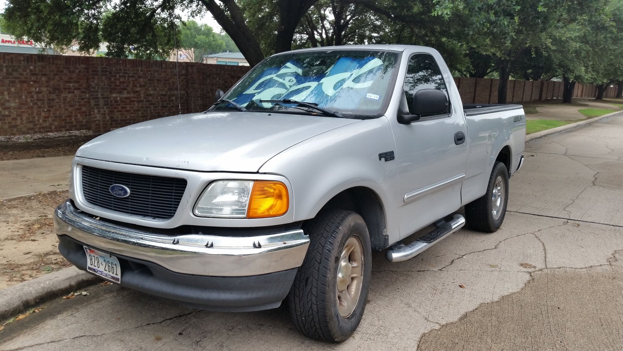

Old Jun 22, 2015 | 06:25 AM
MooSSe's Avatar
MooSSe
Joined: Nov 2012
Posts: 46
From: North Texas
I'll see if I can get this picture to work. And thanks for the advice MCS.

If I not mistaken, what you have sir is a '04 "Heritage Edition", which is essentially a carryover from the previous generation while production as ramping up for the more square trucks that were produced from '04-'09. With that being aid, the 3rd brake light assembly is most likely a completely different assembly...???
Anyhoo, just give it a good look over from stem to stern and ya should be fine.
