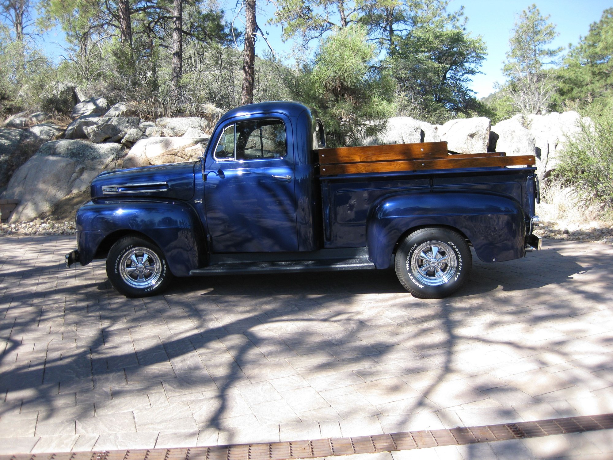

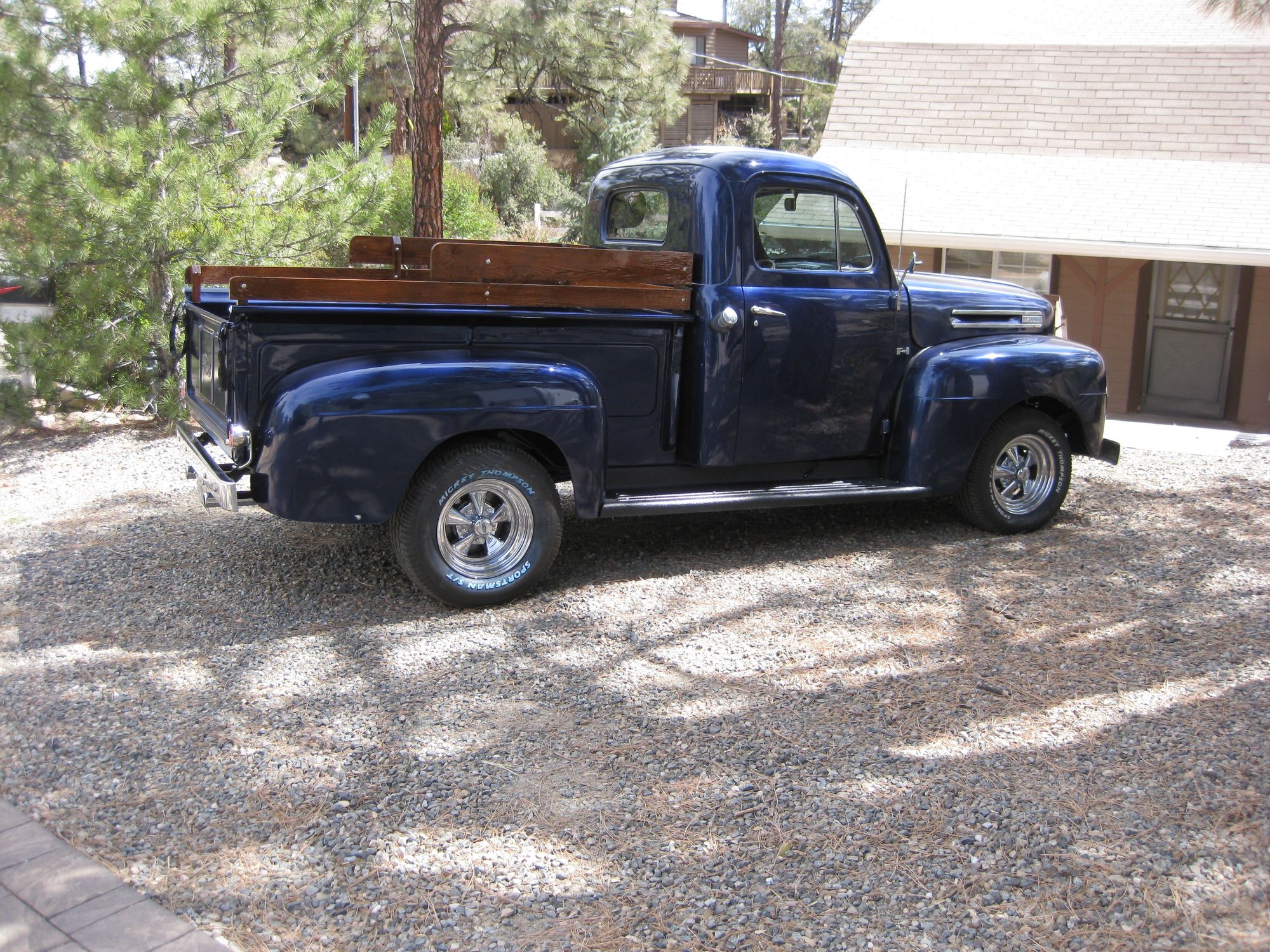

I am using the Mickey Thompson ST's on the 48. I first used them as street tires for my Cobra and was very pleased with their performance and would buy them again in a heart beat. I bought the tire and wheel package from Summit. They were delivered to the house mounted , balanced, ready to put on. No sales tax, no shipping and nobody could beat their pricing.

ChuckRob what size tires and rim width are you using on yours and thanks for the info and pics

The rears are P275/60/15 on a 15x8 wheel
The fronts are P245/60/15 on a 15x7 wheel
