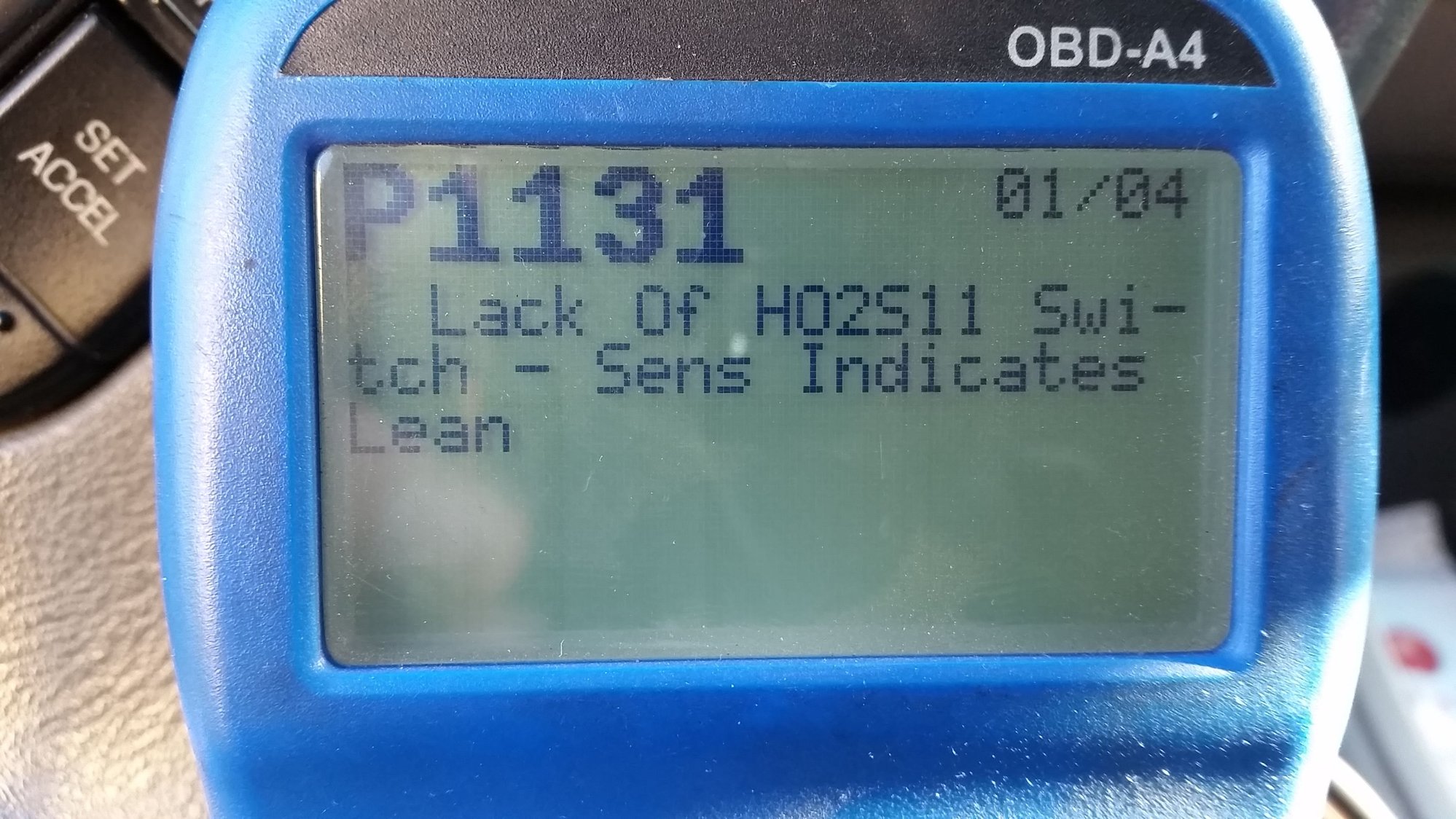

Hi. I have a 2001 ford expedition with the 5.4 v8. Last week i left it to a company to clean it ( incl cleaning the engine room) after that the service engine lamp is on this is one of the error codes. Any idea what to do?

Sounds like they fried a COP/COPs or blew a vacuum hose off. Bank 1 is P. side I'd expect a misfire code shortly if it is a COP or injector issue.
Code means the right side of the engine is running lean.

It indicates lean on both banks, no missfire, but i also noticed that mow i cant change the vent inside the car (panel/floor etc) is that also vaccum controled? Thank you for your help

Yes both banks and air not changing is vacuum. Must be a major hose pulled off somewhere.
