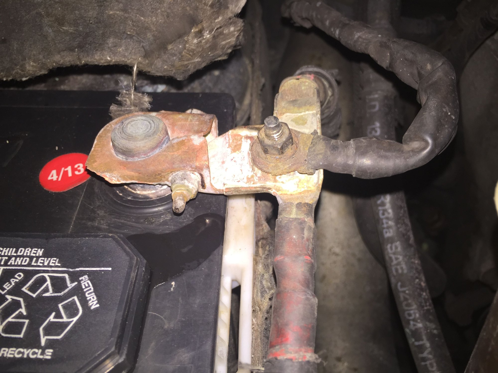

I removed my batteries yesterday to clean, add water, and clean terminals. My passenger side positive terminal is hanging on by a thread. I wasn't sure how it was constructed so I cut off the plastic support to get a better look. Is there a standard, accepted replacement for this?

I don't have a picture, but what I did on mine was get a marine battery terminal like this. Universal Marine Battery Terminal: BatteryMart.com
I cut the round part of the OEM terminal off and then removed the screw from the remaining flat part that the two cables connect to. Drill out the hole a little bit bigger so it goes over the stud on the new terminal and then slip the 3rd wire, and any additional wires you need on there and tighten down.
Hope that makes sense.

Makes perfect sense. Thanks for the advice.
