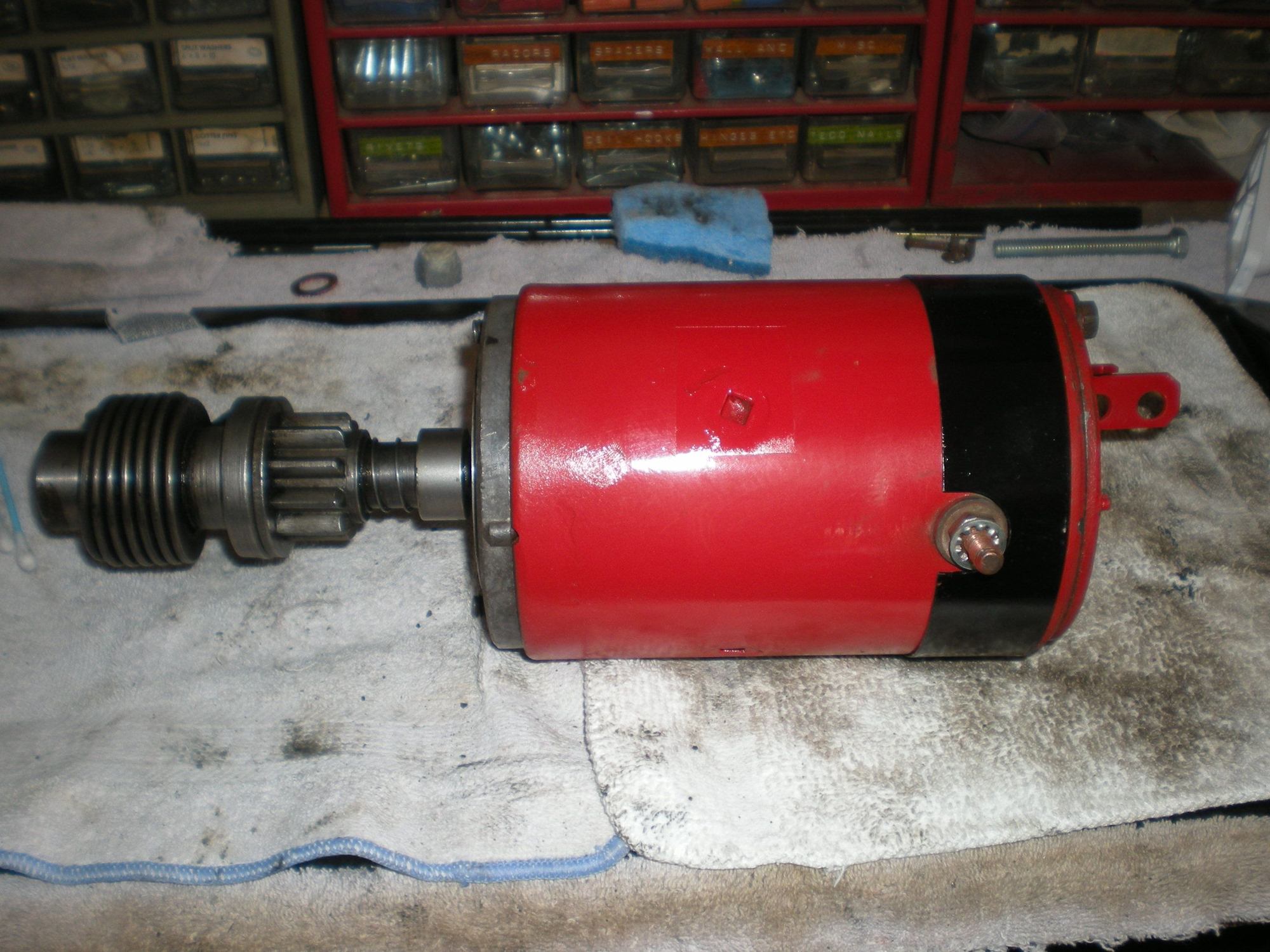

I know it has been a while since I last posted to this thread but I finally got a few minutes to take out the starter (a counter-intuitive procedure). This is what I found when I got it out. I have looked at the visible flywheel teeth and they "look" OK but I have not rotated the engine to look at all of them. Clearly the teeth on the starter are badly damaged and there are metal filings stuck all over the bendix. Can I assume this calls for a new starter? or can you buy just the gear and clean everything else.

You should be able to get a new bendix, but it looks like the starter was setup with the clearance too tight between the drive gear and the ring gear. Things were most likely better when hot because of heat expansion giving more clearance.

I'd bet that with the front edge of the teeth worn away like that, the starter has picked up enough RPM by the time the teeth get up to the flywheel that they aren't engaging. No question, need a new drive.
Being 12v, you have the option of going to a mini-starter. Minor re-wiring involved. They push into the (undamaged?) front side of the flywheel ring gear, instead of the rear. They also draw less than 1/2 the current of the stock starters.

Originally Posted by obscurity
It should look like this. Those teeth are really chewed up.

I have been looking for a place to buy just the bendix but so far no luck. Can anyone comment on the advantages/disadvantaged of bendix style starters vs newer mini starters.
ALBUQ F-1 already mentioned the mini starter require minor rewiring but only need half the current. Are either of them easier on the starter or flywheel teeth?

The starter circuit is kind of a package deal when servicing. To avoid trouble in the future you want everything "just so". For that matter a well tuned engine means easy starts in cold or hot weather, and saves on unnecessary wear and tear of both the battery and starter. An engine that won't start at all or grinds will just roast batteries and cables and starters too - they have a duty cycle (that nobody ever follows).
It may not fail the very next day after a crank marathon but the damage has been done. I sort of like the sound an old FORD starter system makes when setup right and wouldn't change it, but then I'm strange.
Best to use NEW heavy gauge cables, NOS (not modern junk) Solenoid, NOS bendix or starter drive, and new/rebuilt starter. Voltage drop testing during crank will show the extent corrosion and rust (or paint) will affect starter performance.
Inspect ring gear carefully. No shims should be required on a FORD. Can buy all the parts for rebuilding a FORD starter yourself for about $40 - new armature, brushes, bearings , hardware, everything. Need to find a good part # for the Bendix (starter drive); that particular was probably used for many years and fairly common, should get plenty of hits on the net from the usual suspects? May have even been used on tractors, not sure but it looks the same.
