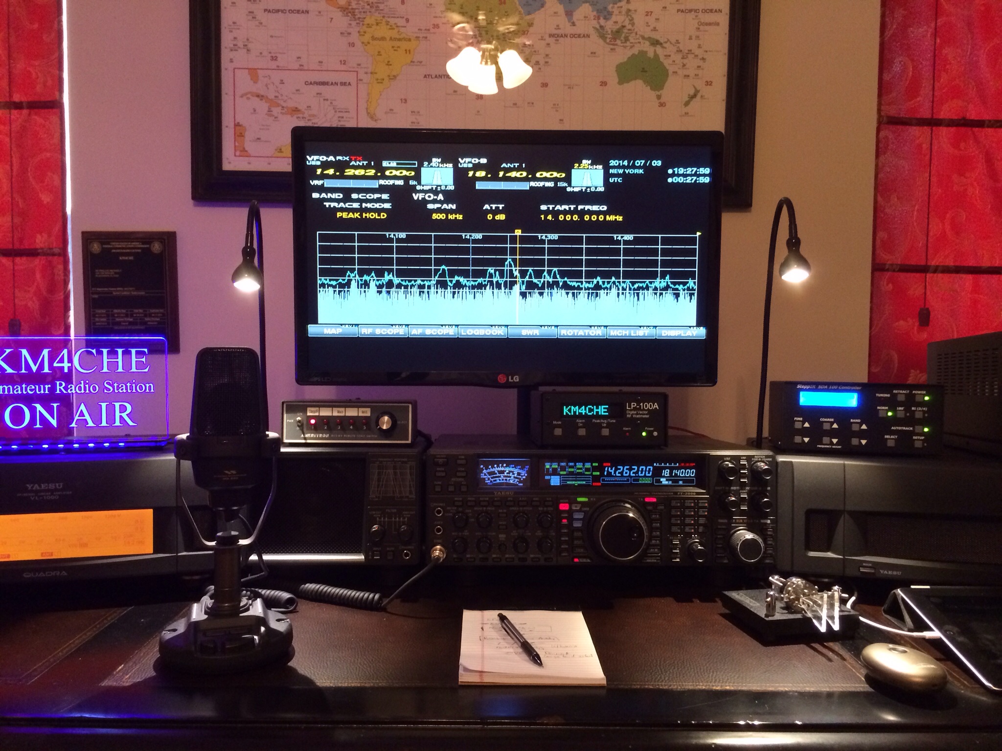

I wouldn't steer you in the wrong direction lol...
Old Jun 10, 2015 | 06:58 PM
bcrewcaptain's Avatar
bcrewcaptain
Joined: Dec 2006
Posts: 609
From: Central Va
Attachment 120339
showing your age...notepad instead of keyboard and a keyer closer than the Ipad... I'm jealous, more Yaesu than in my shack
Old Jun 10, 2015 | 07:14 PM
LivingLarge's Avatar
LivingLarge
Joined: Feb 2011
Posts: 26,410
From: Ft. Lauderdale, FL
Lol, I have a wireless keyboard, just not shown in that pic...
