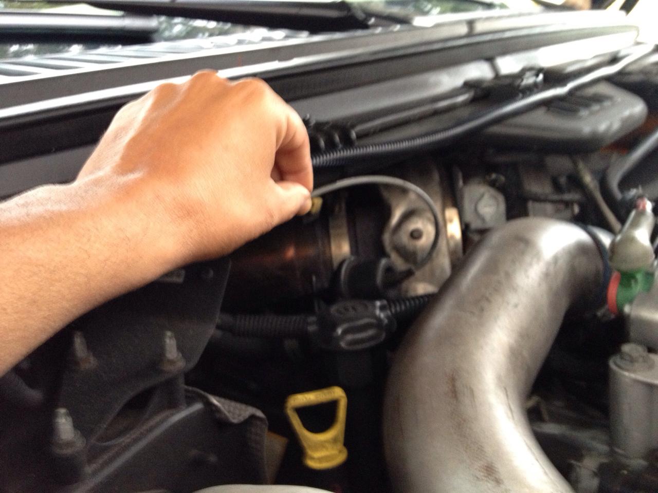

I always tell people to start here... Make sure this grey tube is plugged in, if it's not the ac will be cool but never get cold. Take a look you may get lucky.

Thanks for that, didn't even think about it, just went and checked and it is hooked up

I know this is an old thread, but does anyone know the part # to this grey tube? Mine is cracked and needs to be replaced.

I THINK it's just a vacuum hose, not sure of the part number though. I'm guessing you checked on the line and didn't see a part # printed anywhere?

Correct. I've identified it as a vacuum line for the heater core bypass valve but I am having a hard time tracking down the part number.

Any old 1/8" (probably) vacuum hose will work.
Otherwise, any dealer parts department can look it up and see if its a stocked item (probably not).

Thanks for the input, the whole hose is very brittle so I think I'll just replace it. I'll swing by the dealership on the way home from work and order one up.
