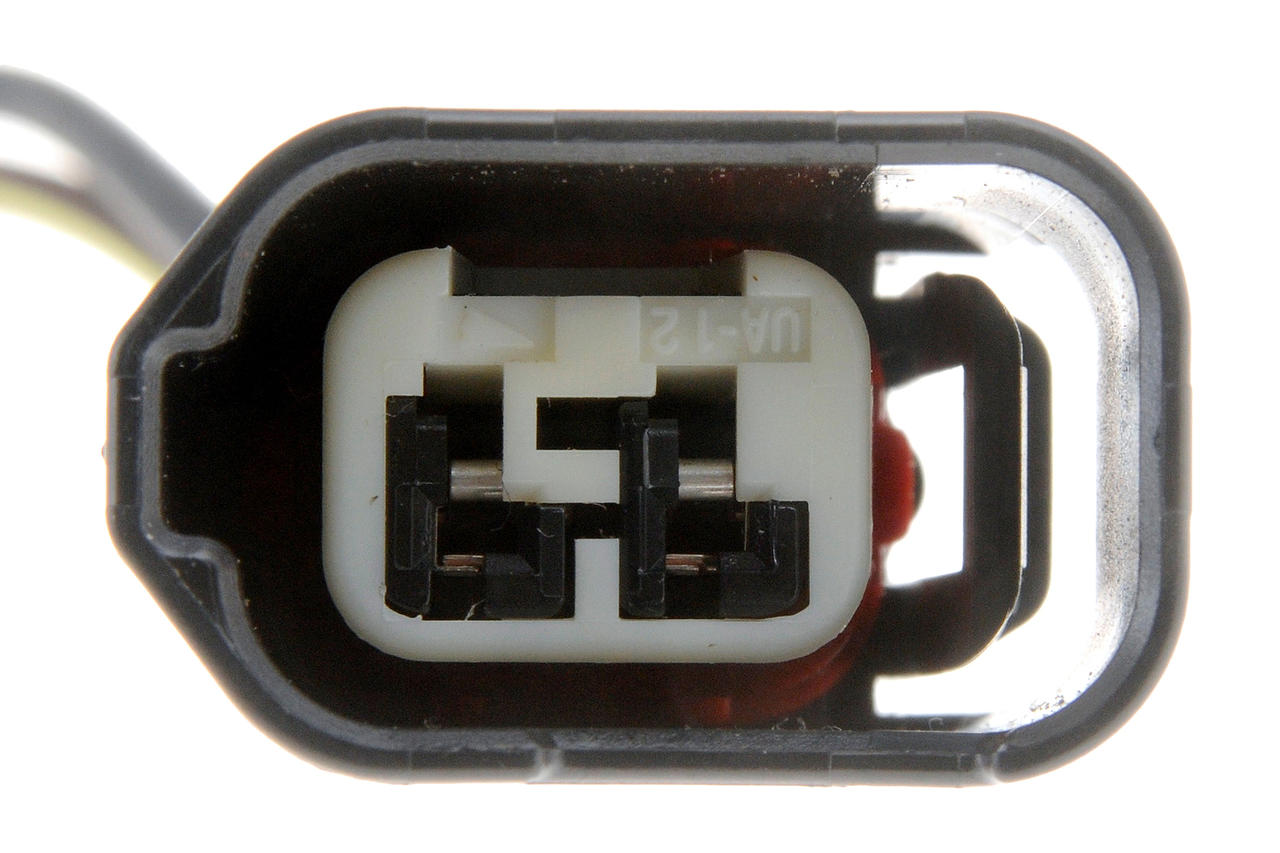

Press in the tab on side of the socket pigtail near the wiring end. This should release the harness plug from the socket. You should be able to see a barb inside the socket that engages the latch of the plug.

Here is a picture of the pigtail that plugs into the socket.
Name:  84772-2 Harness Pigtail.jpg
I can't find one that shows the release tab and I don't have my truck anymore to take a picture of it for you. Sorry.

Roland, Thanks so much for your help and pictures!! just now had a chance to get back at it, I was able to unplug the old 90* socket from the pigtail and plug in the straight socket from the '07 light and it fit perfectly!
I don't know if the aftermarket '07 headlights come with new sockets, but my brand new OEM ones did. I got the adaptor harness online for the headlights themselves, and used my original '99 parking/turn sockets as the '07 socket would not plug into my '99 pigtail......Thanks Again!!
