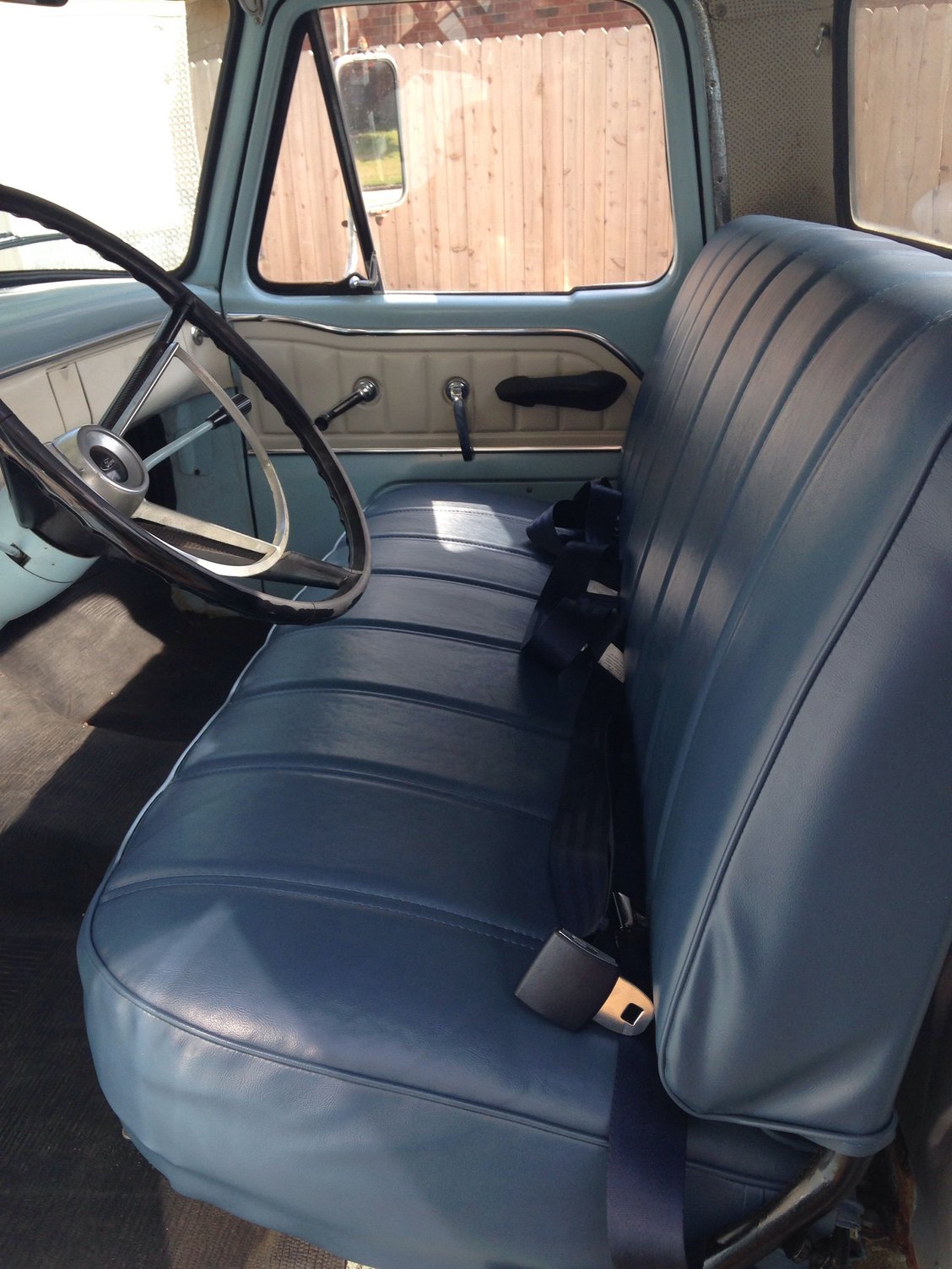

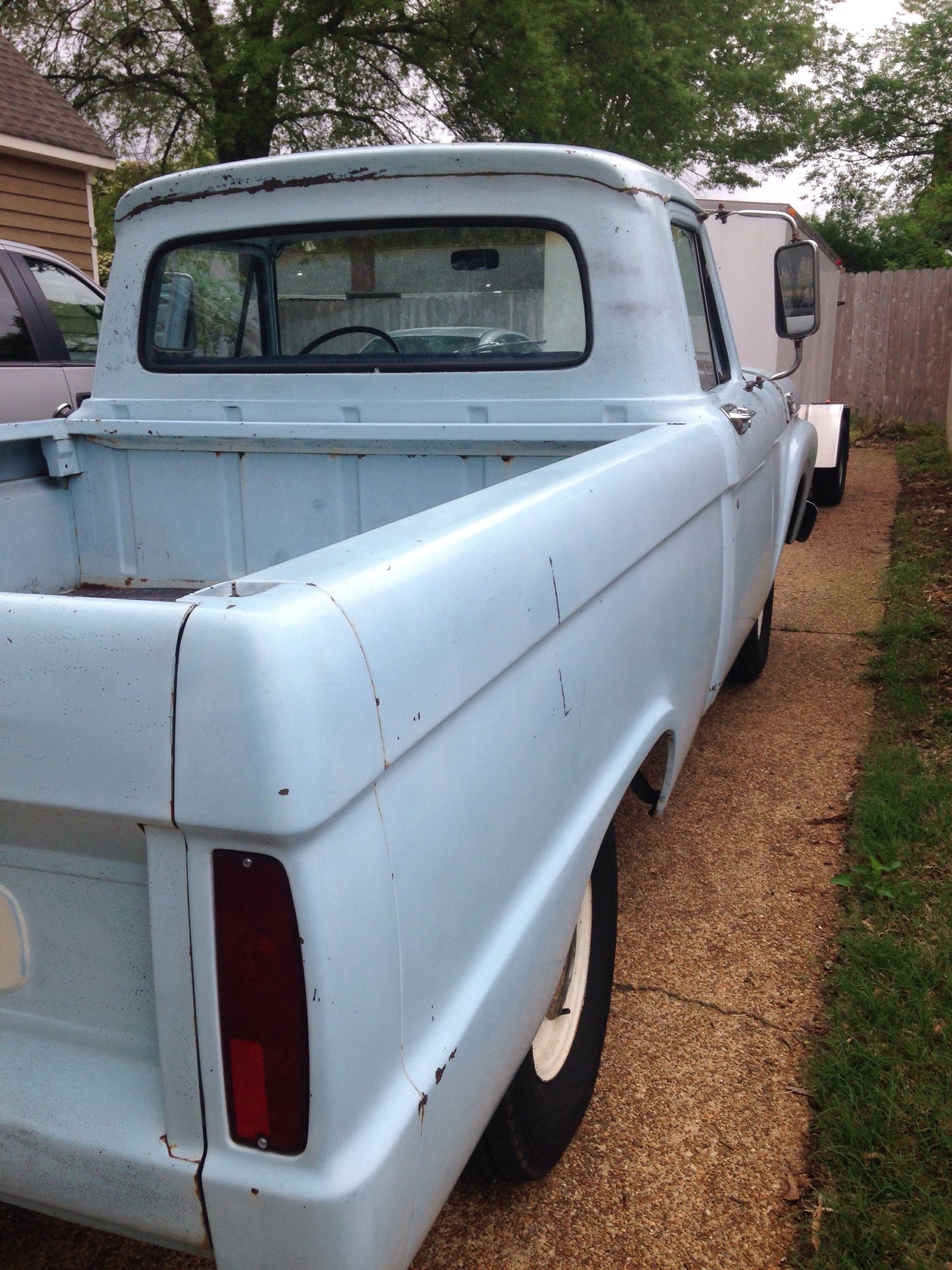

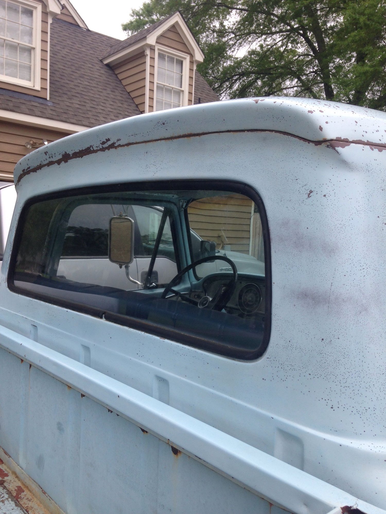

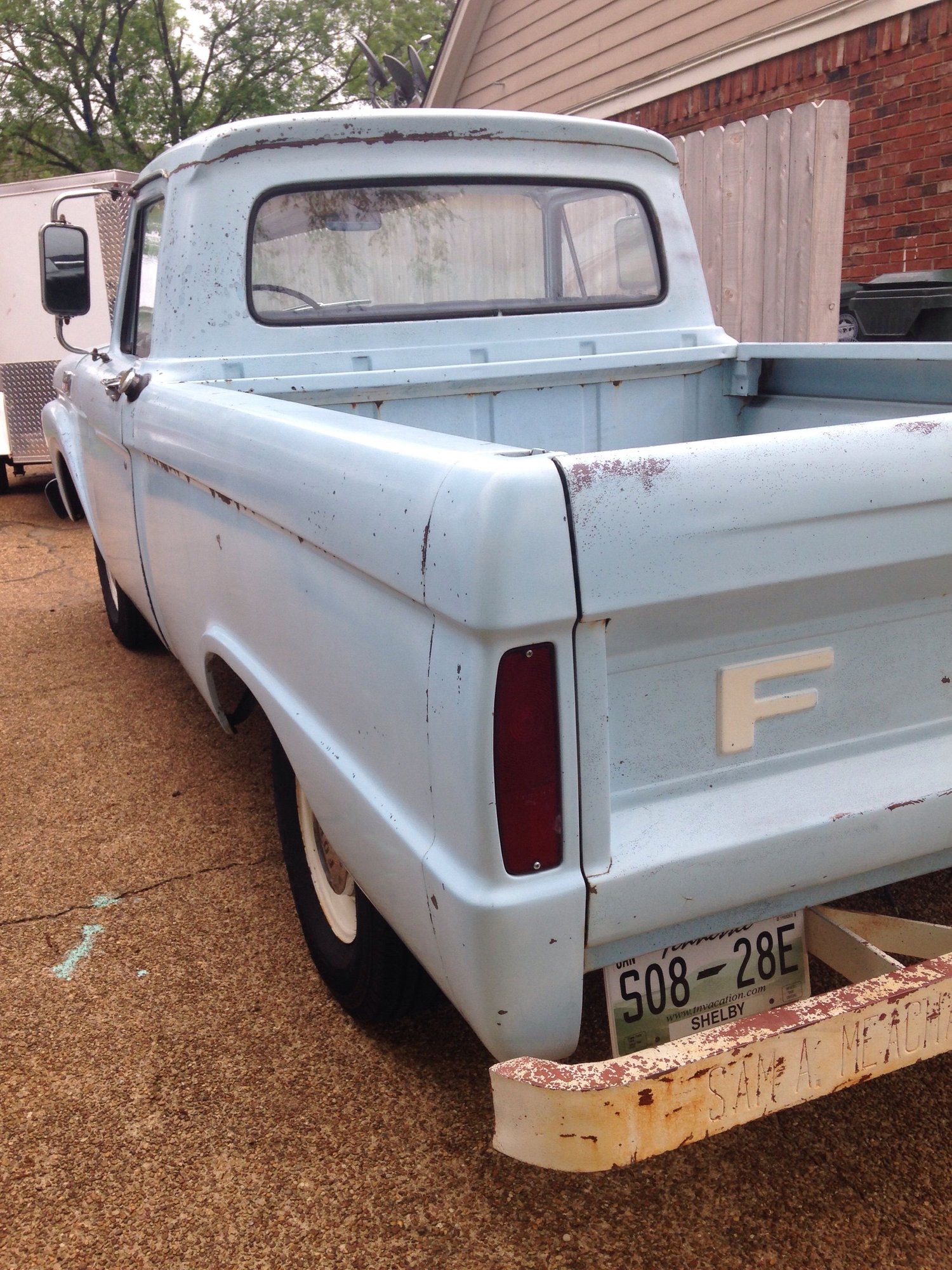

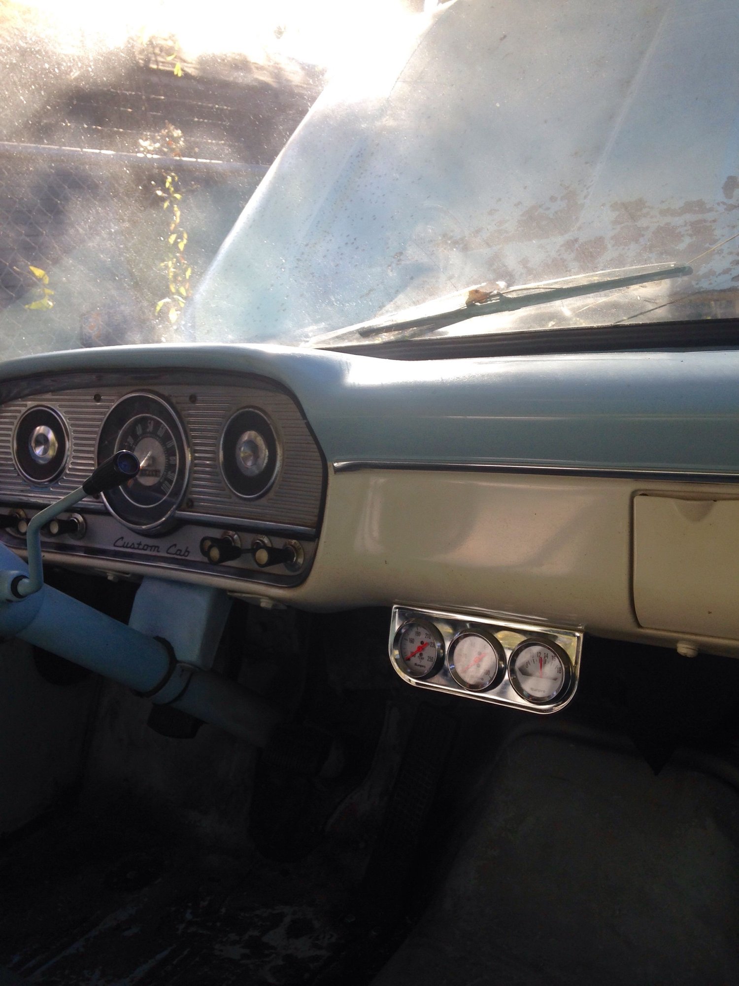

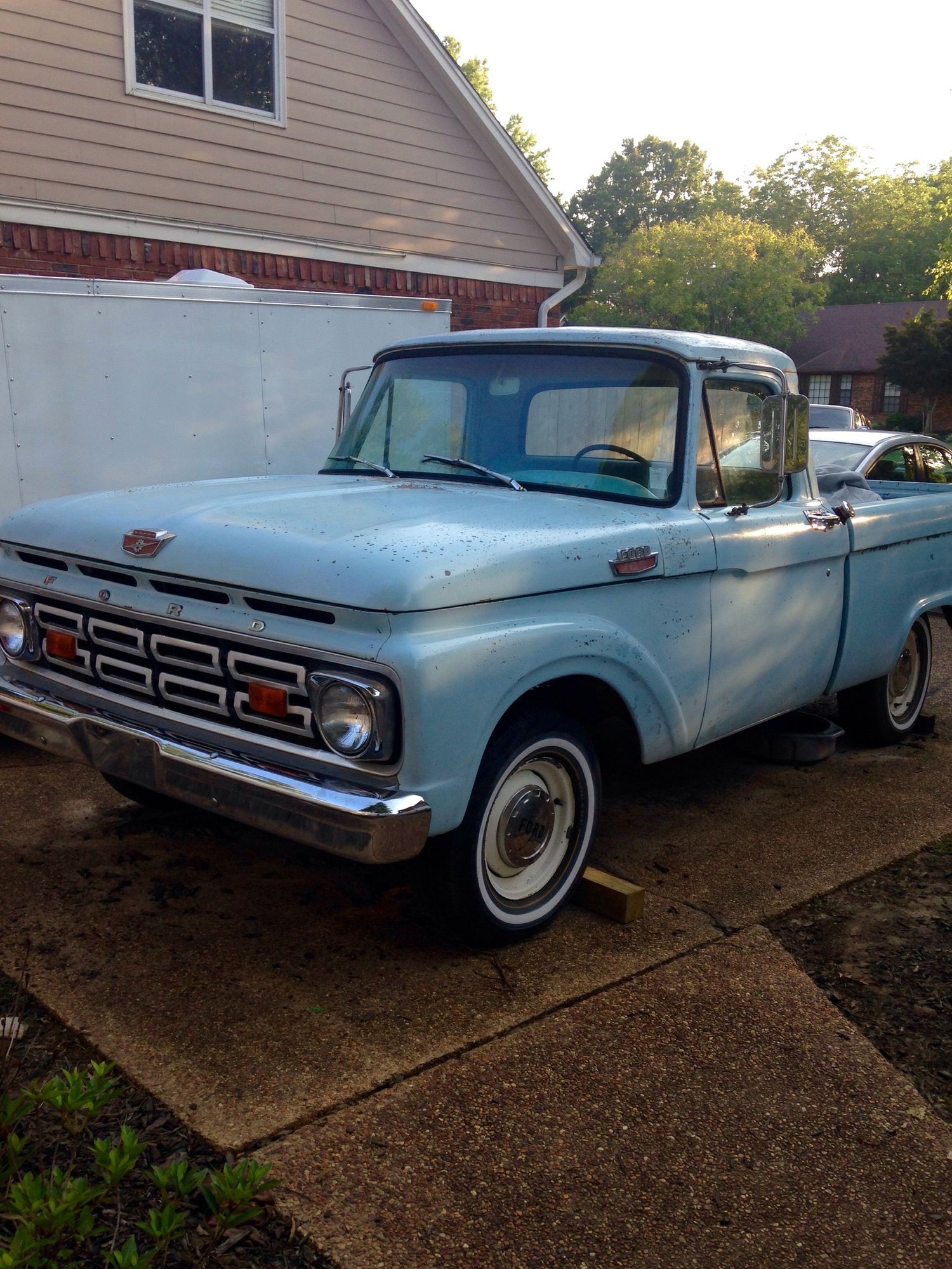

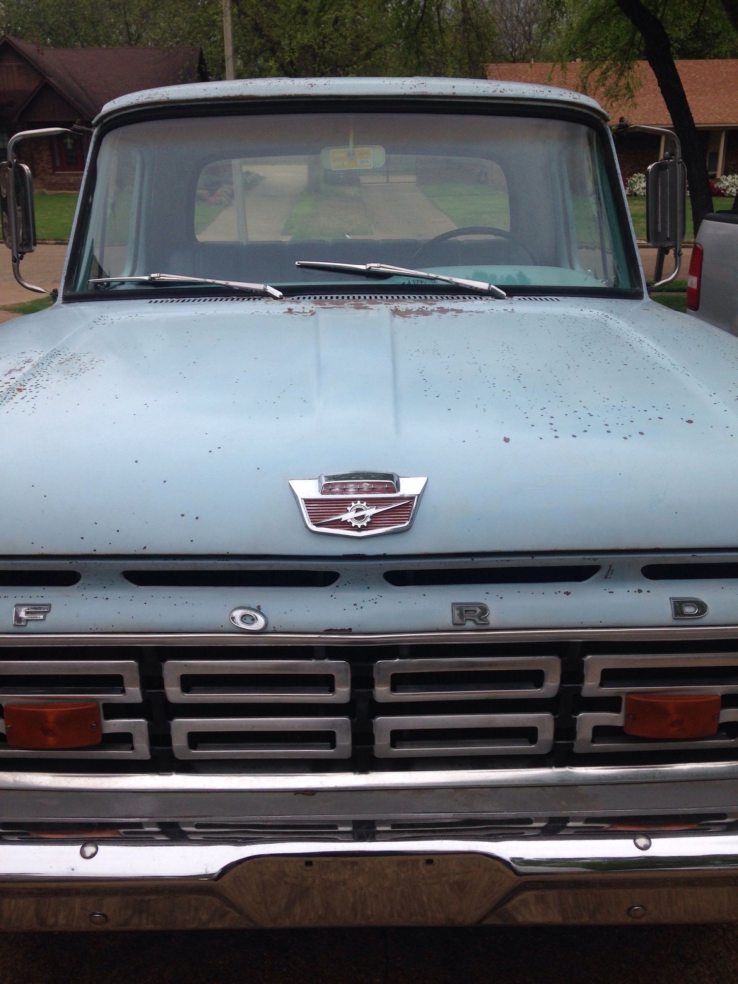

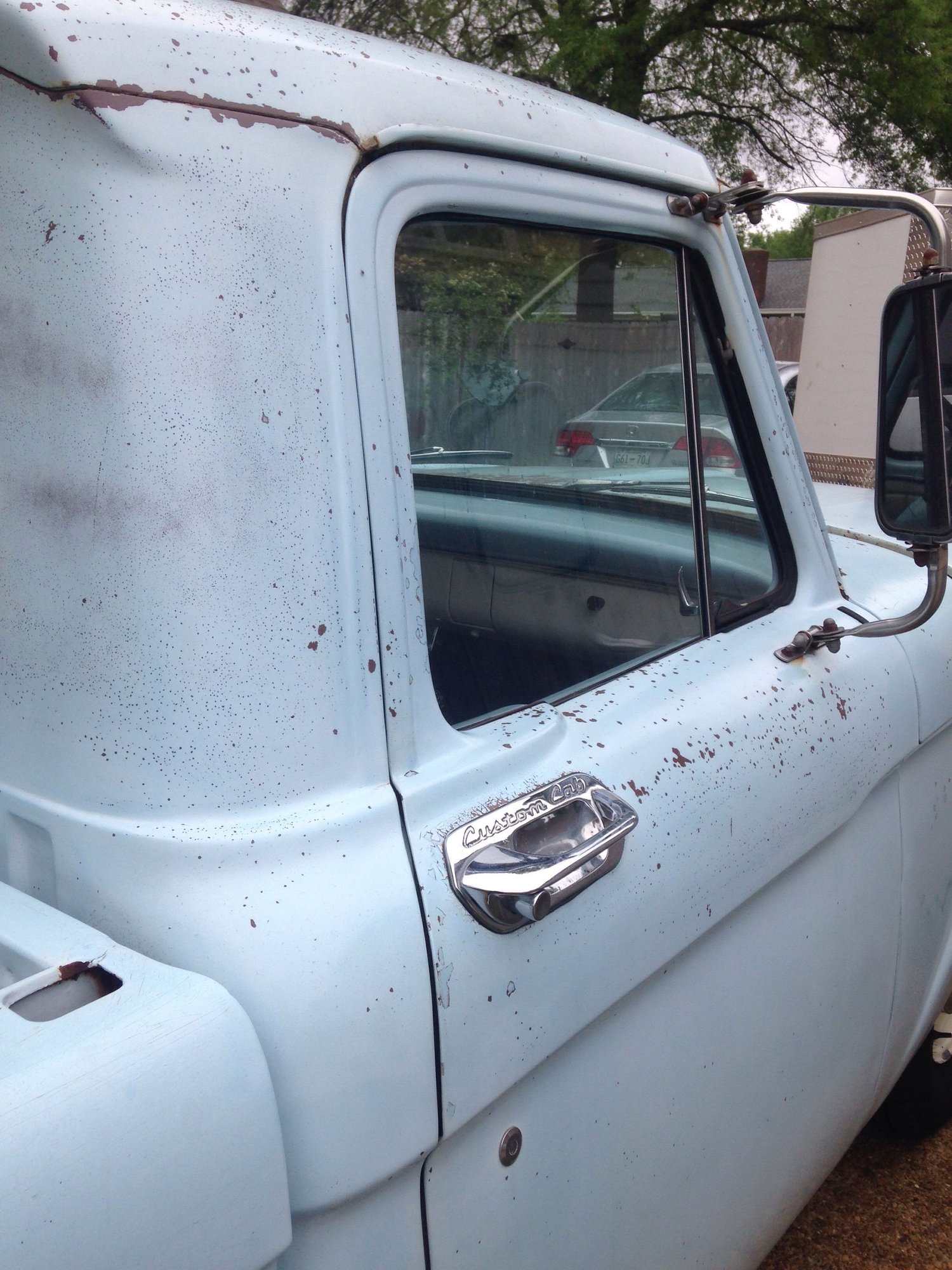

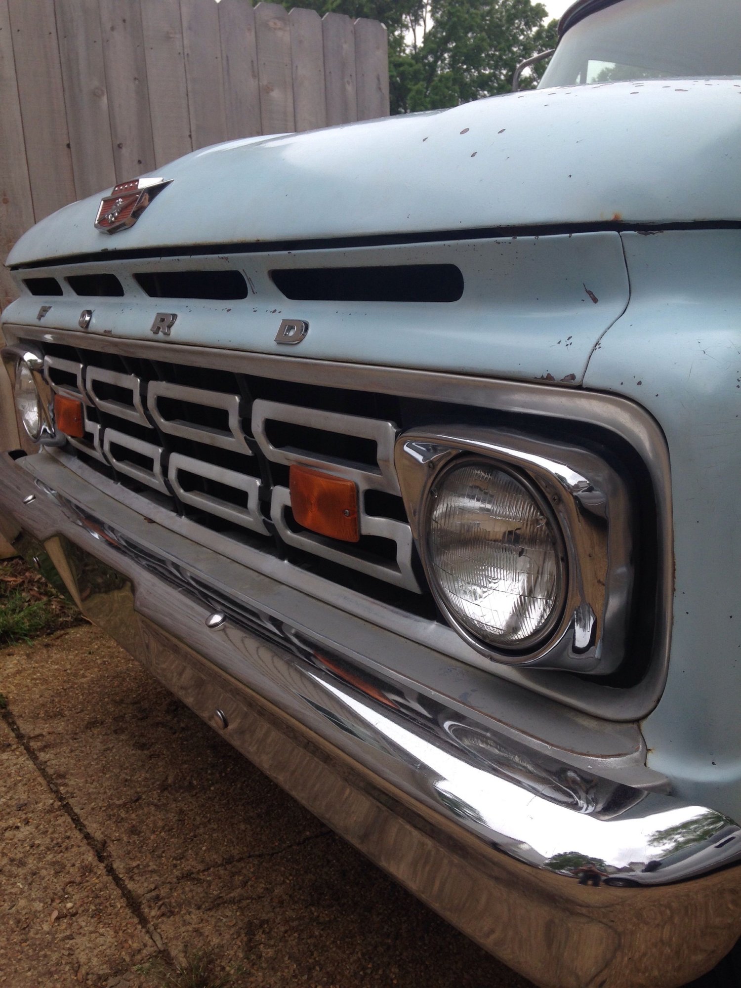

Paint would be nice but I can't afford it at this time. And the first picture is before I got new tires so the white walls are now gone

So you want to stand out - I get that. But are there really a large number of 1964 F100s in your high school parking lot so that yours doesn't stand out? There were NONE in my high school parking lot and I graduated from high school IN 1964. You could always try some custom pin striping or flames or something. Not a whole paint job but just enough to be noticed if there are too many look alike trucks in your town. Just kidding you. Nice truck. Has a nice old truck patina. Have fun with it.

I love your truck!
I may be biased because I have a 66 short bed that's the exact same colour combo. In my high school/broke days I often found that the best way to personalize my cars or trucks was wheels and tires. You could try trim rings, losing the hubcaps (not literally), spider caps. There are lots of different options. You could also lower it and that would just cost you mostly time and effort.

I'll be honest...sounds like a recipe for disaster. You really need to think about it. A lot of the time when you have something and see it every day you begin to think it's not that special.
You have vehicle that some only dream of owning. I mean look at what I'm working on.
Sure you can do things to it but do things that are period. Do things that can be easily undone.

Wow…what a nice truck. I would not change much if anything. Maybe wheels and wider tires like Peter suggested, but make sure you keep the original. What size engine does it have?

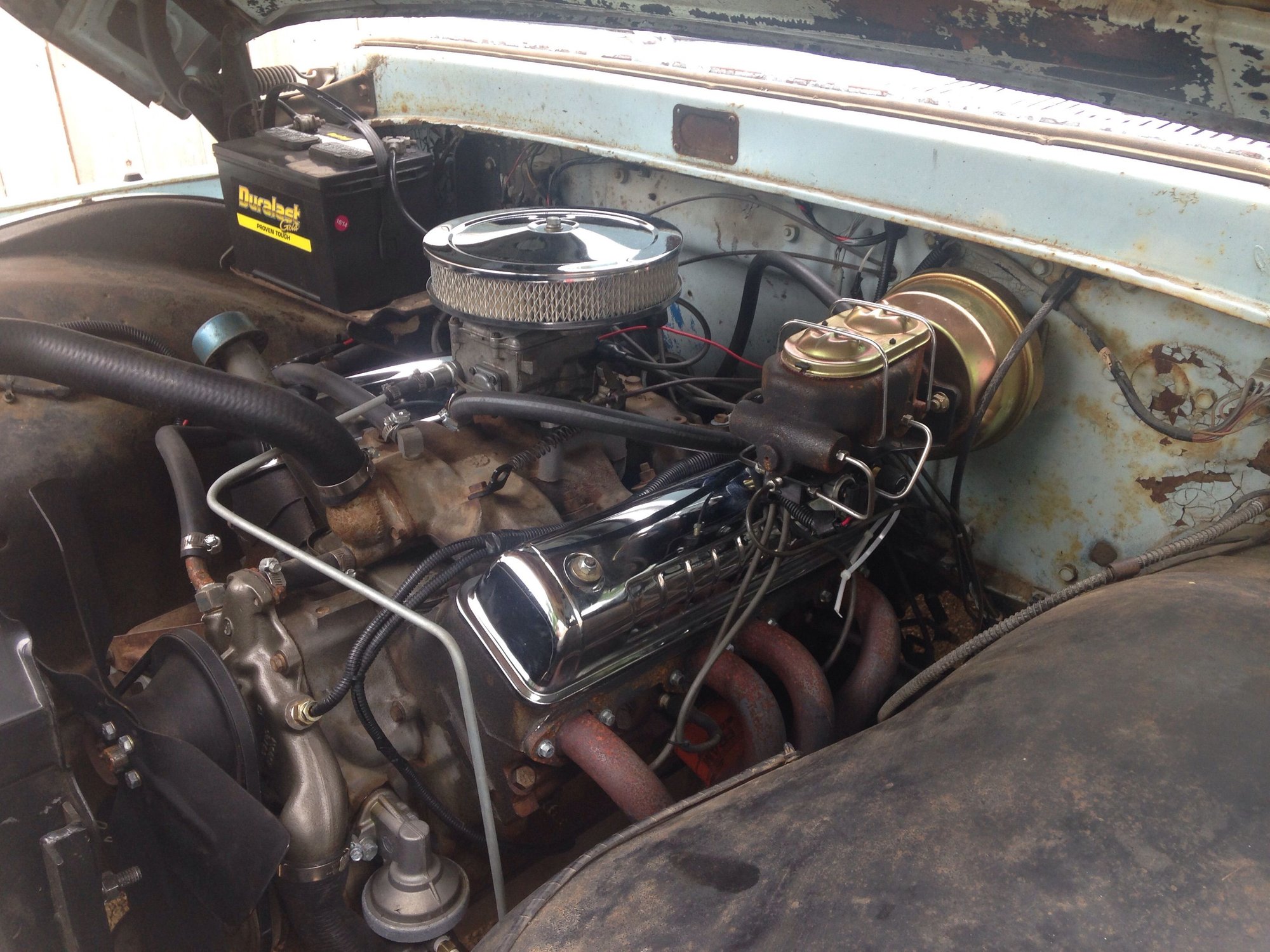

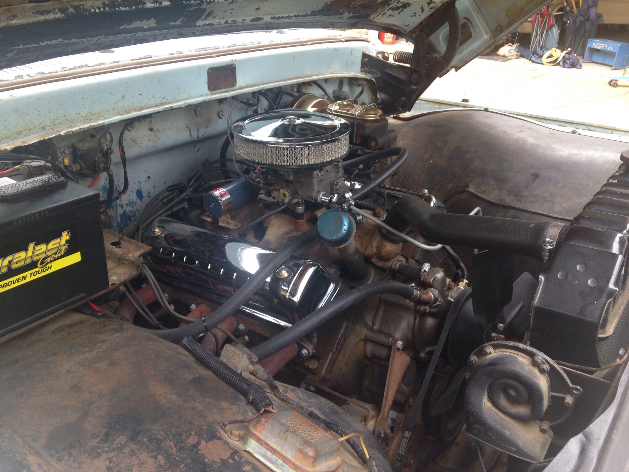

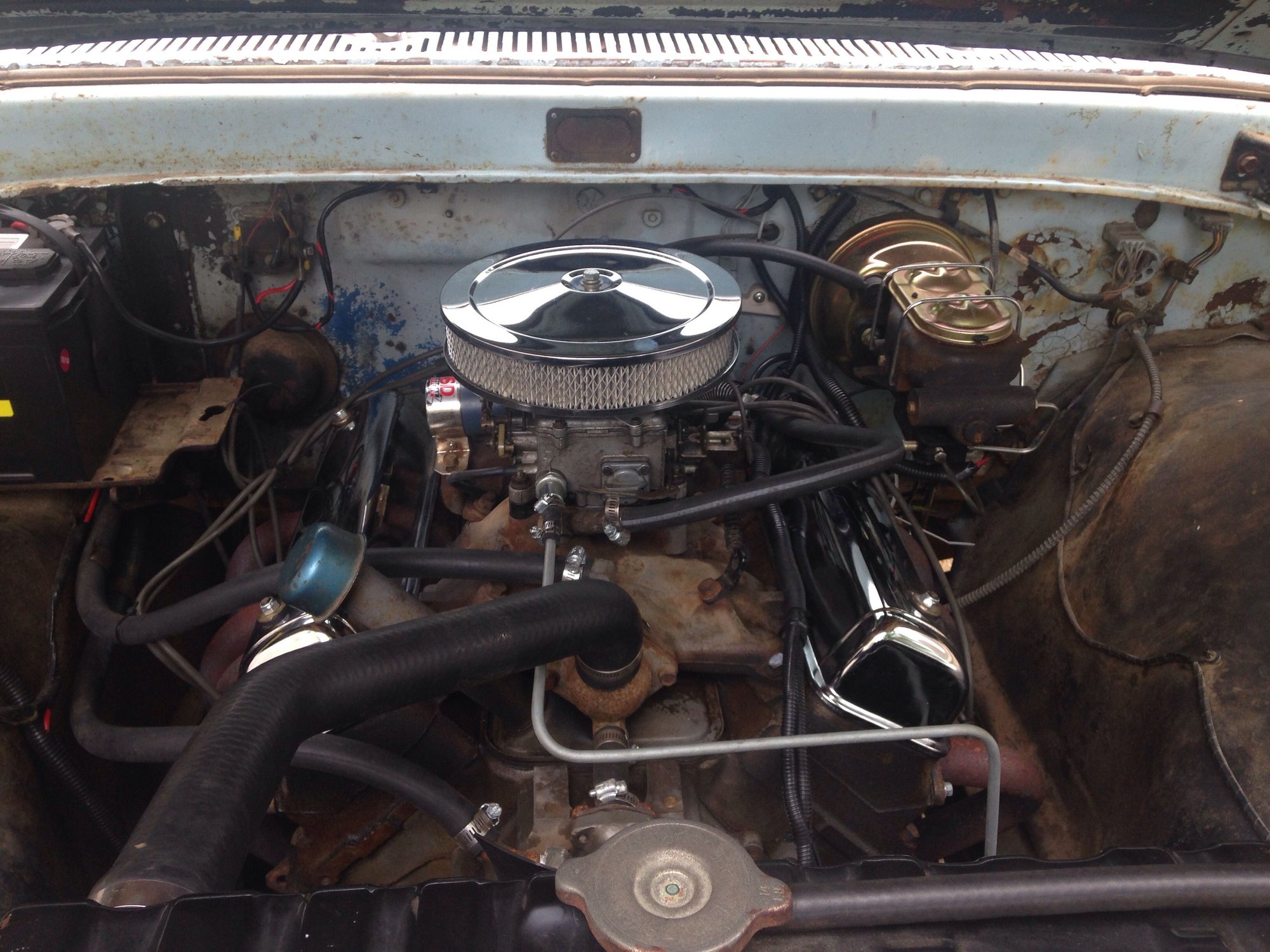

Dashknob- it's got the 292 and it's mostly origional except now it's got headers, new valve covers, and new air cleaner. I will paint under the hood soon. I can post a picture of the motor to if anyone wants to see

Sure I'd love to see the engine pics.

If there's any more pictures you'd like to see don't be afraid to ask, I would be happy to post them for you.

Only because I've done it a few times and because it is cheap, I think a nice satin black on that truck would look really good. It accommodates keeping the stock wheels, tires and caps and turns it into a more youthful-looking vehicle.
You can do it using $10 a quart Rustoleum #7777 and some elbow grease. Do some simple wet sanding the original paint to remove most of the pock-marks first, mask it, and spray it. I've never had a spray booth and never had issues. Spray it early in the morning before the bugs wake up and it'll flash off fast enough. Cover important things in the garage and go for it! Also, they sell the same paint in rattle cans for the odd touch-up. Almost invisible when you do.
As for the purist comment and concerns, I think we can all sit back and see the beauty of this old patina truck. It's easy to say leave it alone. But we're not all in high school anymore. It does look like an old farm truck. And it is an old farm truck with some obvious blemishes it is clear he wants to make go away. Even I [don't want to] afford a good paint job these days and I doubt he can afford one at his age. I can see where he's coming from wanting to change it - just as easily as those of us who might think he should leave it alone. Bottom line is you need to listen to your own voice on that choice. It is a great big canvas and no matter what you do to it, if it makes you feel better when you drive it - go for it. It will be more apt to stay maintained and driven if you feel good about driving it - and not parked in a field to rot.

You can sand and paint bumpers, grille, wheels, and various little things. You could add some pin striping or something. You could take out the Cluster and paint it a custom color. I actually did a speckled finish on my custom console just using textured silver paint and then backing away a shooting bed liner.

I also see you have a TN plate. Where are you? Im in Nashville
