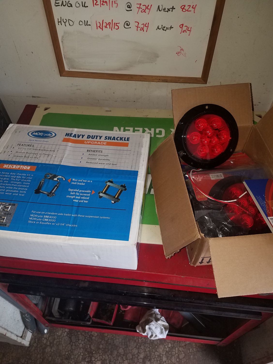

Big ugly and ineffective. Only 4 screw holes and 1 pass though hole for the wires. All those holes are hidden behind the new lights.
