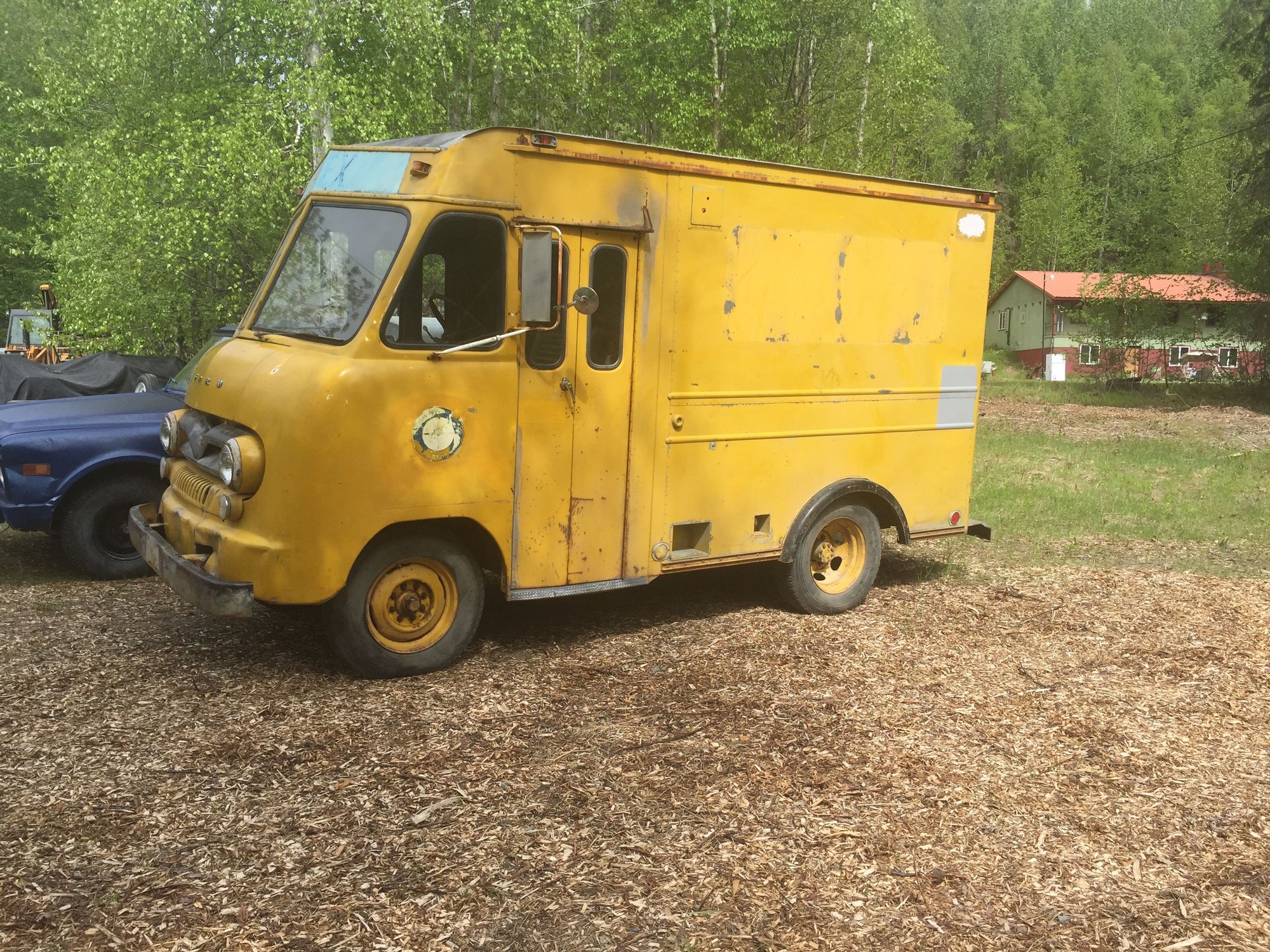

Looking for a serial # location for a 1962 parcel van P350. I was informed today by Harleymsn that what thought was a 52 p35 isn't per data plate. Someone here on the forums said maybe the SN was on passenger side top frame rail near motor mount or shock area. Any help would be nice. Thanks

The grille looks like a 55 grille. What did Harleymsn say the year was?
Old May 24, 2015 | 04:19 PM
52 step's Avatar
52 step
Joined: May 2015
Posts: 25
From: Eagle River,Alaska
Year
1962 per data plate.

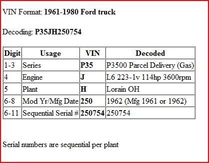

Originally Posted by 52 step
P35JH250754
P35 = P350 (gas).
J = 223 1V I-6, 114 net HP @ 3,600 RPM
H = Lorain OH Assembly Plant.
250754 = 1962, assembled January 1962.
The P Series Parcel Delivery grille is the same 1955/76.
It looks the same as 1955 trucks, but it's not the same, it's shorter.

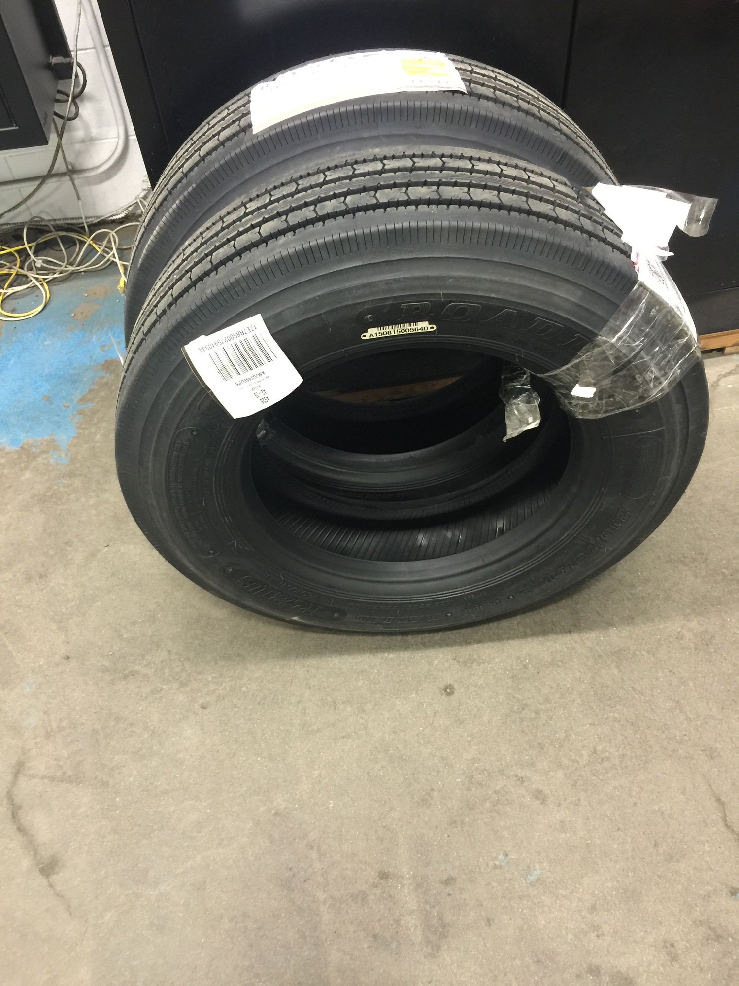

New tires
Got my new tires 17.5 today,need 4 more…
