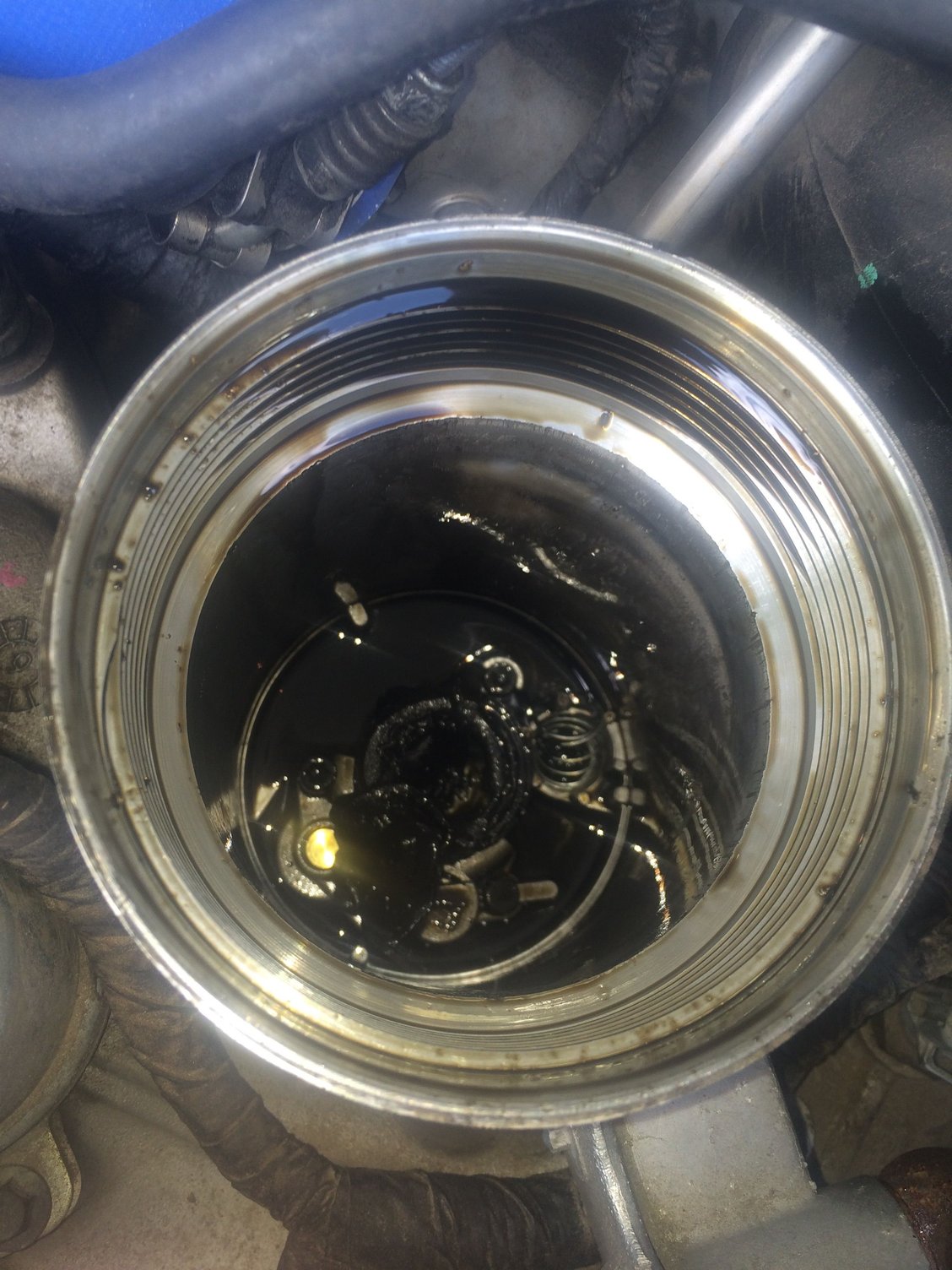

Ok. Just an update for your thoughts and estimate. Of course it's a holiday weekend so no one was open. Drove truck around loop where I was and it drove pretty smoothe. A surge every now and then and at idle it sounded like it was hard to get gas sometimes. That was on day 1. Here we are on Day 3, cranks fine idles a hair, just a hair, and its occasional, louder than it used to. Couldn't get to oil filter, but because it was driving smooth we drove it home and left camper at the tv park. Temp stayed normal. Drove pretty smooth all the way home. 2.5 hours. Interstate running 60-75mph. Stopped one time checked water wS good. Stopped second about 20 mins from home and had to add water. But never ran hot and never surged. Idle sounded pretty smooth. Got home pulled oil filter. Below is what I found. Now I started reading different posts concerning melted oil stands about the engine is toast since it melted because the stuff has gotten everywhere. Which is hard for me to believe seeing as I just drove it about 3 hrs and it didn't sound bad. Will be at mechanic tomorrow. Just want to calm my nerves tonight. The oil filter chamber was devoid of oil. I mean that pic is exactly like I found it. I saw a few foamy bubbles not a lot in the water reservoir. No water in oil it appeared. Aside from the occasional surge which never happened on the way home, appeared it work itself out, and the occasional rough idle which I never heard all day today. 2 month old rv camper so whatever is wrong with truck will have to get fixed. Just wondering if i got lucky or could the damage be so minor that it would still run good but cost the price of severe damage.. Thanks guys.

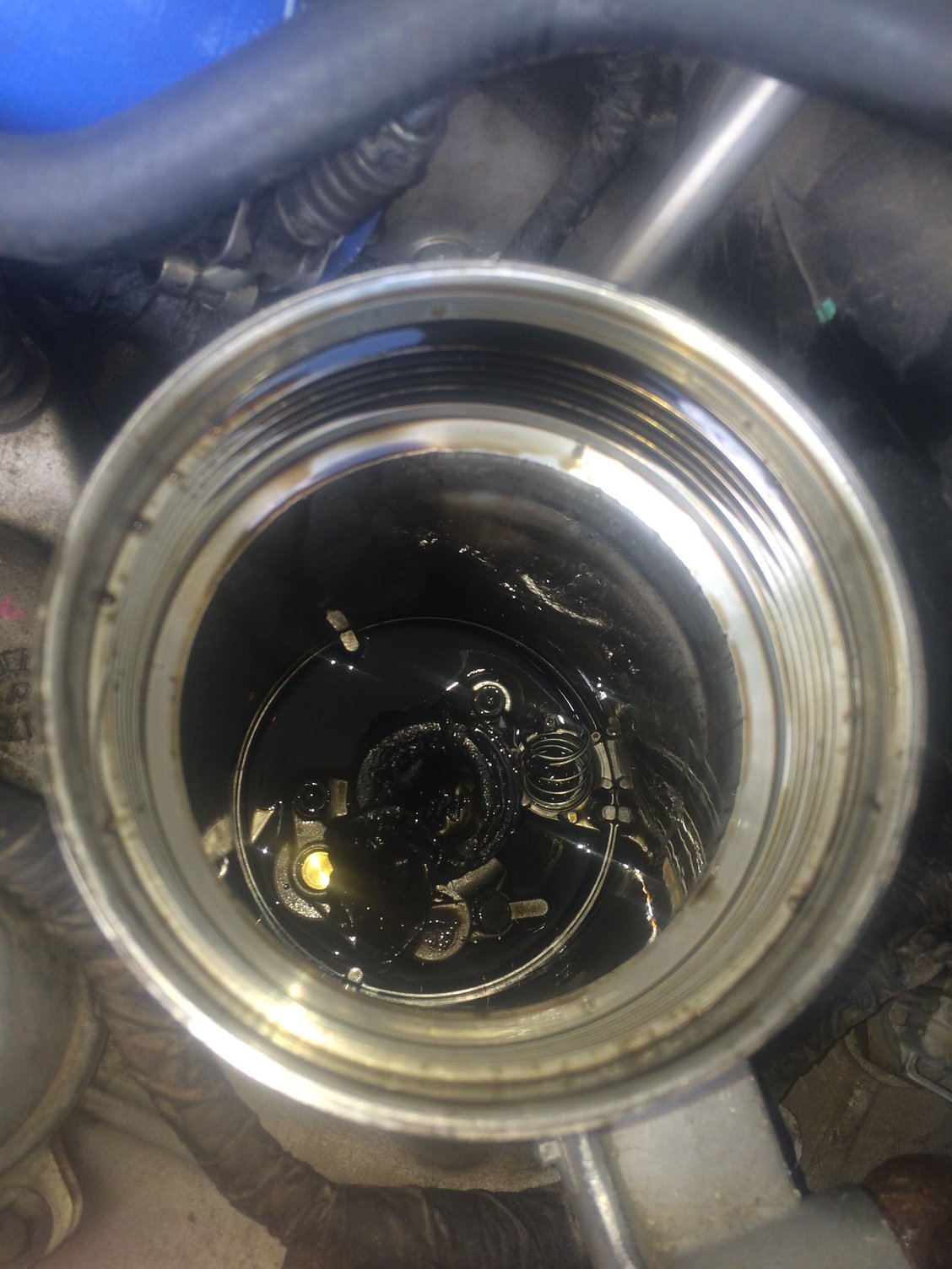

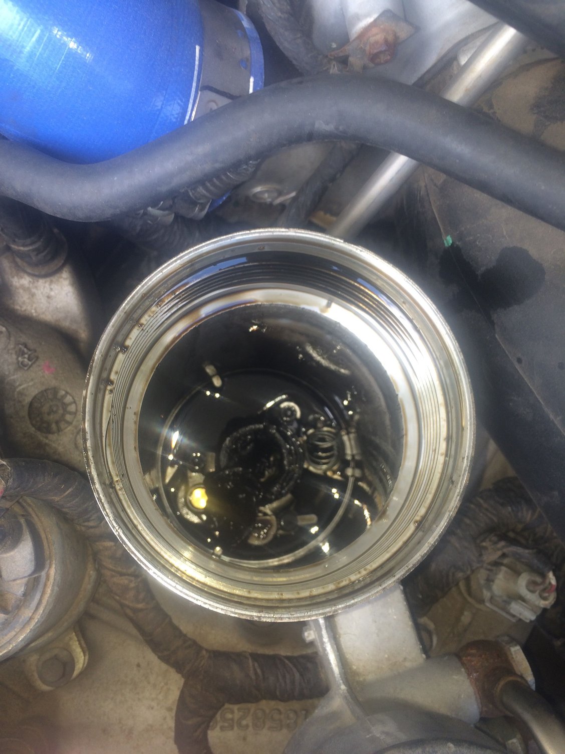

This is what is supposed to be in there.
Amazon.com: 3C3z6c755aa Oil Filter Housing Return Tube, Guide Stalk Post, Oe Ford 6.0 Diesel: Automotive Amazon.com: 3C3z6c755aa Oil Filter Housing Return Tube, Guide Stalk Post, Oe Ford 6.0 Diesel: Automotive
If it was, and looking at the remains appears to have been, it melted and is now down inside the engine clogging passages up as it went. Glad you made it home safe, unfortunately your engine didn't do as well.

Stand pipe is gone, so is the oil drain valve in the bottom, only thing left is the spring. Melted stuff goes somewhere..... ouch. Do you have a gauge to read live data, like how hot it really got? IIRC, takes 350 degrees to melt that piece.

prospects aren't looking too good after seeing that oil filter standpipe, or lack thereof...
At this point, finding a used engine with some kind of warranty doesn't look like a bad option to consider. The other option would be rolling the dice and having this engine gone through and hope it is worth repairing. Best case scenario, the melted plastic stopped at the screens or somewhere non-critical, or even just barely melted and stopped right under the filter assembly and the loss of coolant is simply a leak somewhere. Worst case scenario, the passageways are at least partially plugged and the engine is a timebomb, on top of having failed head gaskets and/or bad EGR cooler.
You could roll the dice on having that engine taken apart and hope for the best, but chances are the repairs would cost more than the engine is worth, especially after it has seen that kind of heat.
If I were in your situation, I would save the money of tearing down that engine and go straight to looking at some used engines, preferably with some kind of warranty.
I don't mean to be the bearer of bad news...but that melted standpipe is bad news.

The "melted stuff" is just confirmation you over tempted the engine to the extreme. It will not live. You made it home, count your lucky stars and prepare to either tear it down and fix or swap it out. I would be willing to bet your head bolt are not much more than finger tight right now.

OK,on the other side of the coin ,how much of the stand pipe is left in the filter? You may have just lucked out and be able to salvage the engine. It most likely will need head gaskets in thee future but if you are not wrenching it yourself,find a REALLY good 6.0 mechanic,no fly by nite shop. I say this because if it ran good for that long it didn't suck the plastic into the motor it would have died on the side of the road
