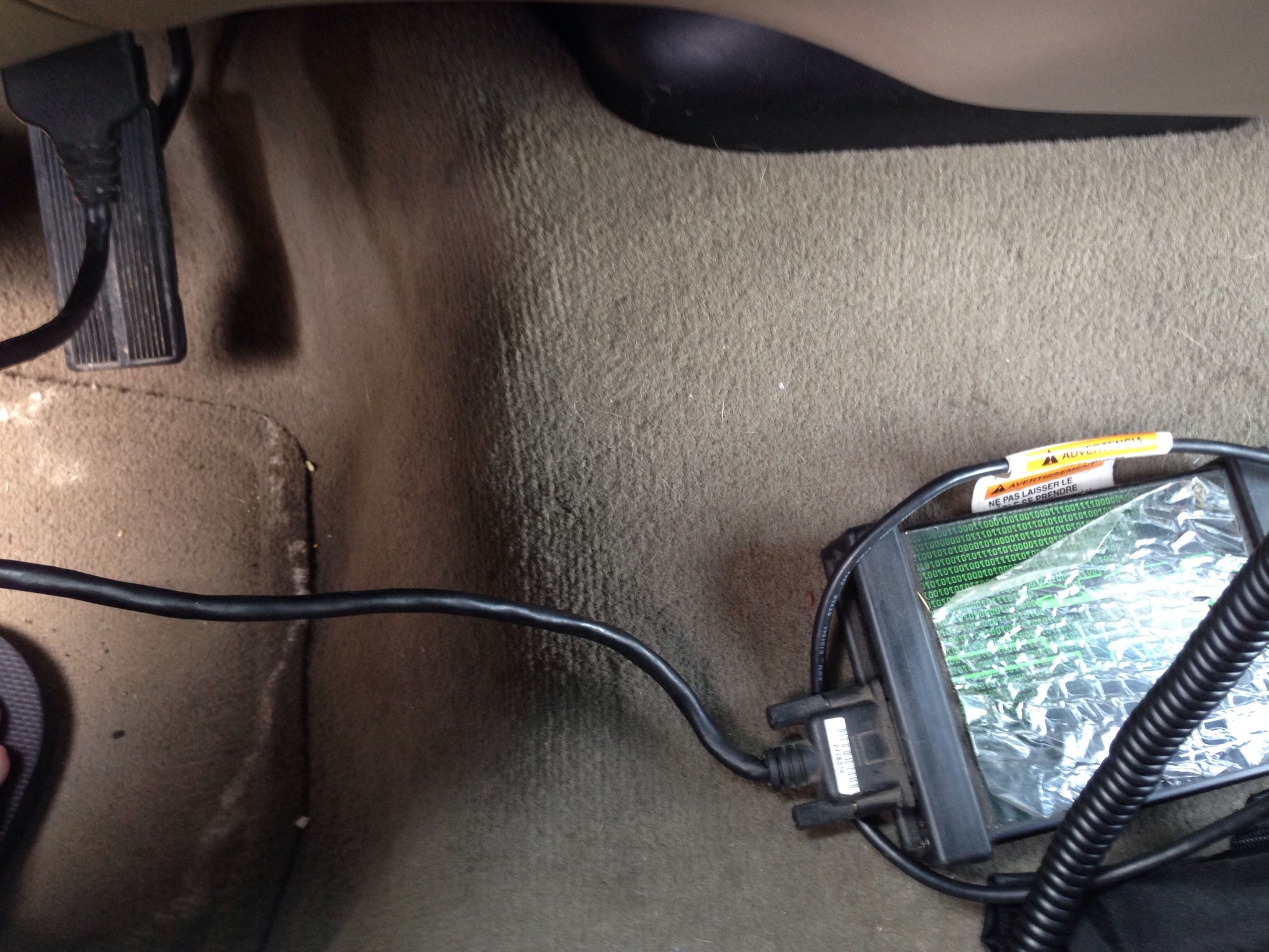

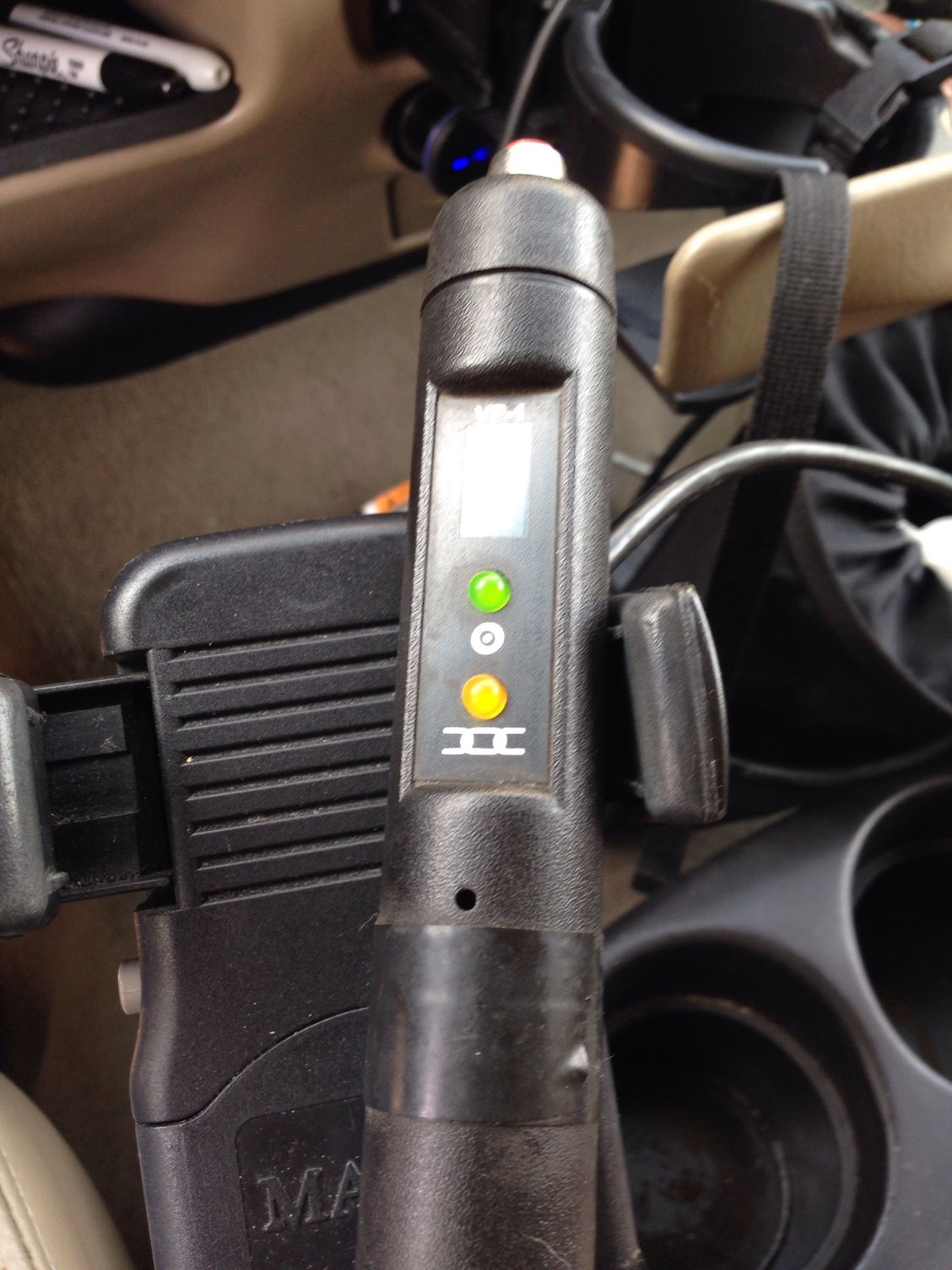

Keeping fingers crossed. Hubby took it in before he left Thurs and talked to the mechanic who did the work and I brought it back Friday morning and they hooked up some sort of device like a heart monitor that records the "issues" as they happen in 30 second intervals when I push a button..I recorded the 4 max times over the weekend so will take it in tomorrow morning and leave it for the day. It does seem like after husband going in that issue is the egr so will see what happens.

Ahhh. The Customer Flight Recorder or CFR - one of my favorite tools!
Thanks K!
I knew that they had things for planes, trains and hearts but not residential vehicles lol. I hope I was able to get the issues recorded properly. I'll go over in the morning and drop her off for her play date..

Am sure if you've seen one you seen them all but I really liked the stick part. Only 4 shots but wouldn't it be cool if you hit that button and it was a turbo button? ��

Don't have technician notes or invoice yet but after they checked what was recorded, which they said was really good, they did replace the egr valve based on recordings. So thankfully that little tool was used. It seemed like they were surprised (one recording felt like I was going to lose power lol) because they said they would not have been able to find it without them.
