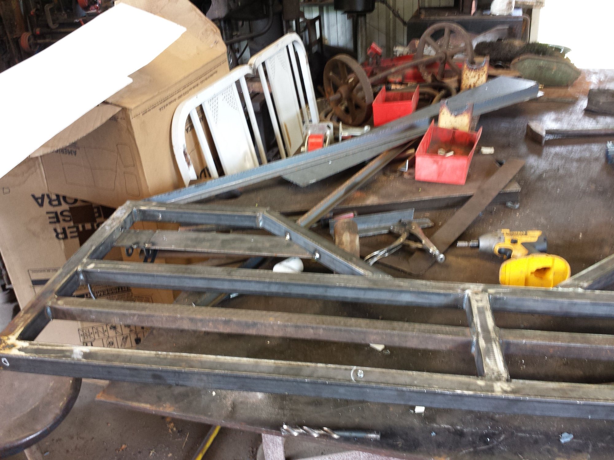

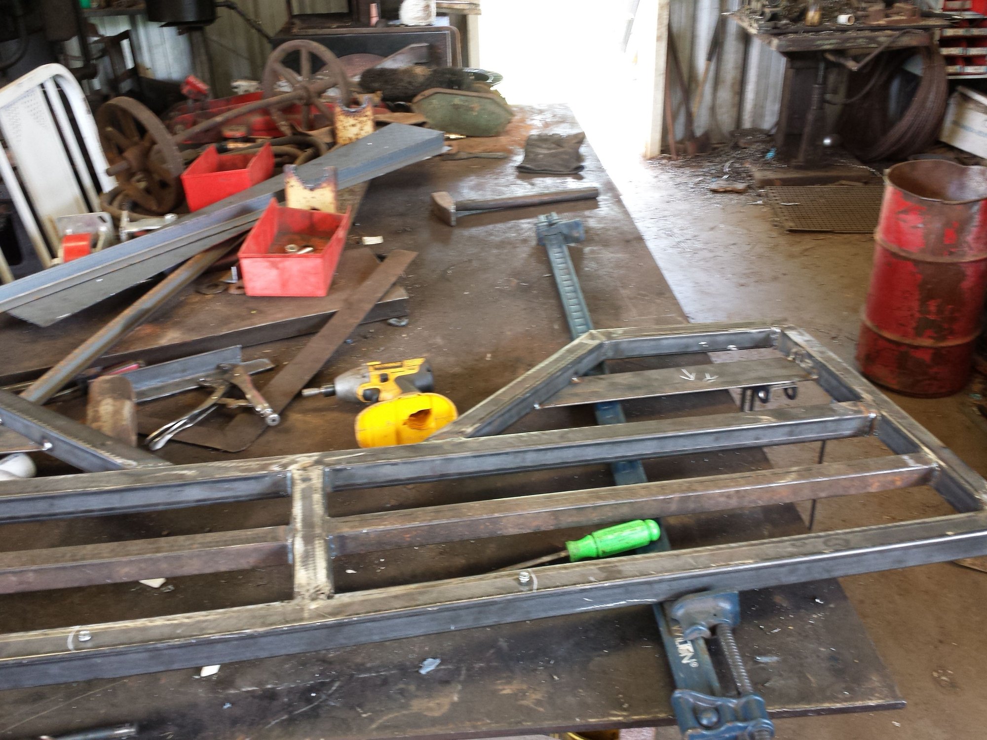

The original design has been somewhat modified with a goal of making it slimmer and lighter. It's not finished but he (the welder) wants me to swing by today for a fitting.

First fitting today, he had to break two welds and flex it for square'ness by 1/8 inch/ then re-weld. Then a few more cuts to clear the trucks hardware and bring it up tight to the bed. Then he attached a couple of sliding bolts (my choice) with padlock locking capabilities (L&R) to secure the gate closed, and rattle free. Finally he drilled for/attached the two cables that hold the gate open at 180 degrees.
Now that we're both happy he'll finish all the welds and clean up the crud spots. He says I can pick it up Monday and take it for a powder finish. I'm thinking a regular black, not flashy/shiny nor a spooky dead/dull black. Is there a name for that?
I paid him his asking price, $250; I'm thinking it should have been more but he wouldn't allow it.

Sorry for poor quality, I didn't think to get a picture of it fitted on the truck and so had to snap quick pics of it on the bench, by holding phone blindly over my head and aiming down.
Looks like I screwed this up three ways (3 postings). Good thing this site is Free <grin>.</grin>
