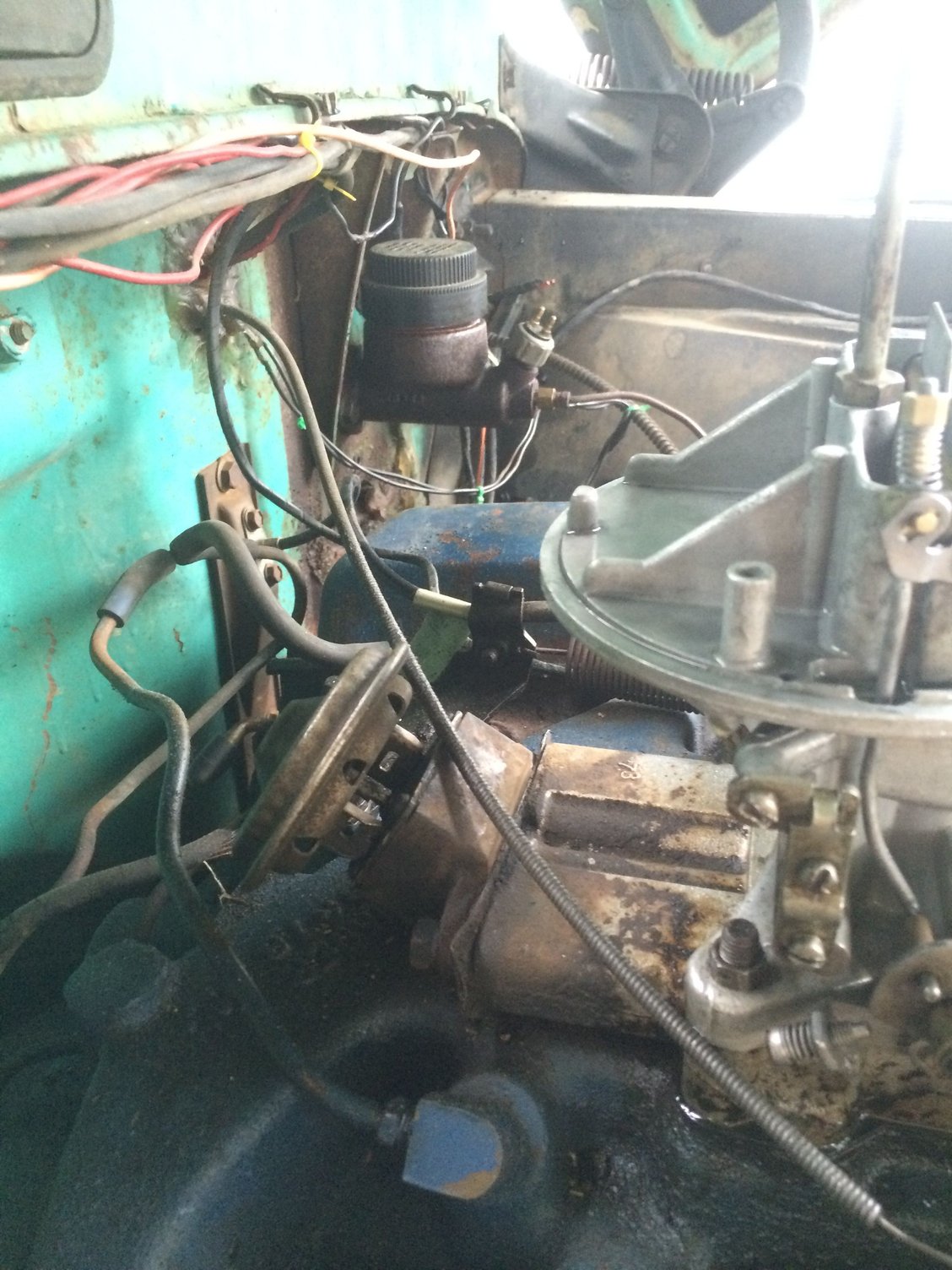

Hey guys. New to all this but I have a vacuum line running from distributor vacuum advance to a port on the side of my carburetor. (300 cfm motorcraft 2100) and I am wondering if I could plug that port and run my vacuum to this port on my intake shown below.
It's the one that's capped right now.

Vacuum advance should go to a ported vacuum, which has no vacuum at idle. A vacuum port on the manifold will have vacuum at idle. Keep it attached to your carb.

What's the capped line on the insulator plate for then?

Posts: 42
Maybe a pcv?

Yes, some sort of smog related device, which looks like it requires vacuum. My spacer has a hose to a pcv valve on the valve cover. You can change to a solid carb spacer and eliminate that contraption, or get hold of a vacuum diagram.

It's an EGR valve. I'd do like KO1960 suggested and get rid of it.
