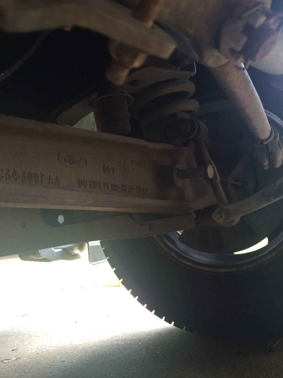

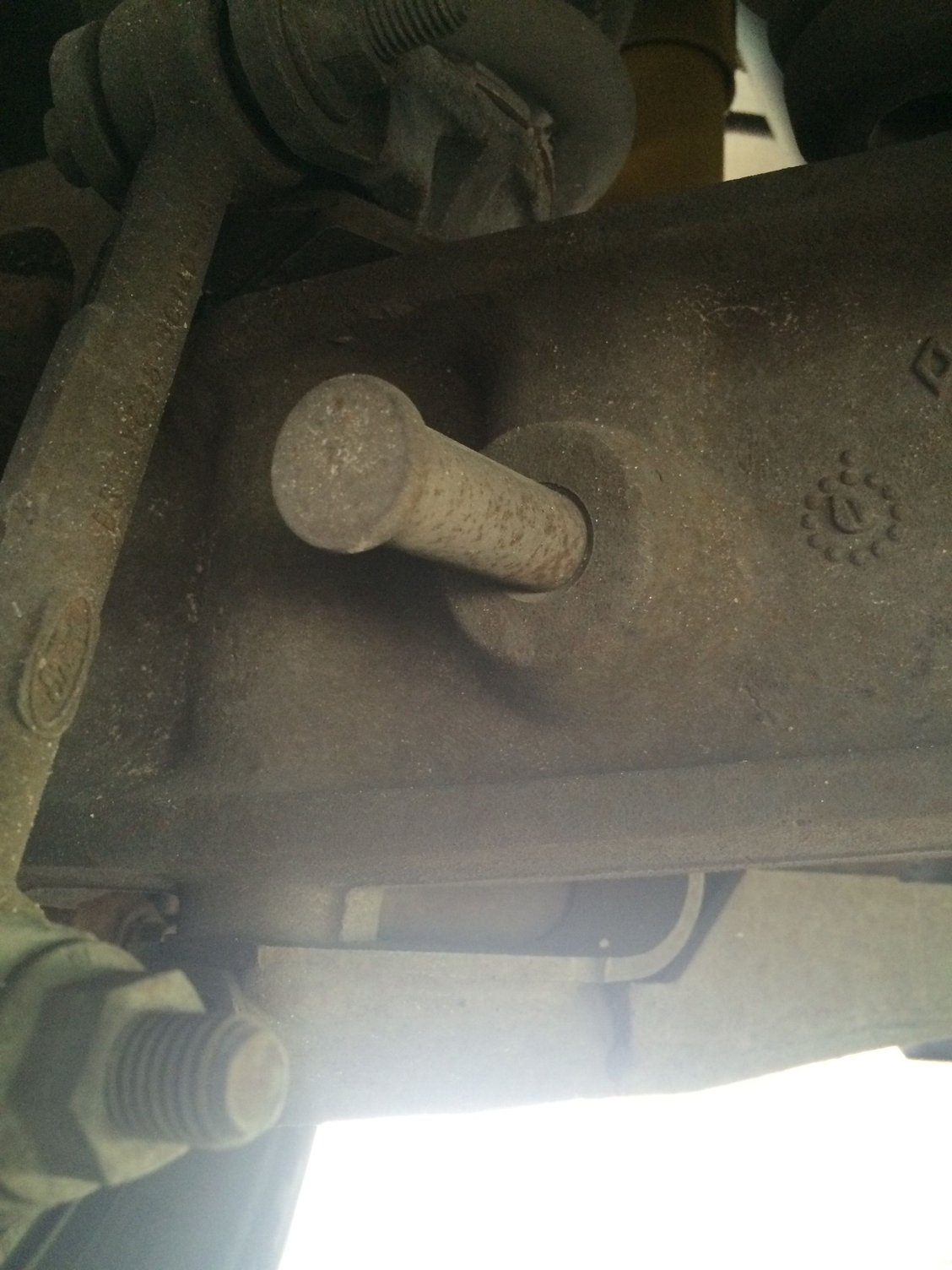

Was crawling around under my struck and saw these. Looked odd to me. What are they? Is something supposed to be mounted to them. Don't remember them on my 05 f250

Here are the pics

Those are sometimes called whell stops. The purpose is to keep you from turning the wheels too far and jamming the steering/wheel linkages.
Some Fords for some reson do not have them but the hole to mount them is sueually there. A production error I guess.

It's the jack point for SRW 2wd trucks. I'm thinking it's because the stock screw jack has a curved head and Ford didn't want a procedure in the owner's manual to lift with a curved head under the flat arm, or because the jack wouldn't fit under the arm at it lowest height. DRW F350s and F450/550s came with a hydraulic jack with a flat head, and the owner's manual shows to lift from directly under the arm for those. Having the pins in the arms of a dually is probably parts-commonality for the front suspension components.

I believe they are jacking points for the front of f250 and f350 SRW. I saw that in the owners manual after Razzi told me what they were

I have an 05 owners manual that does not show the same jacking diagrams.
Have no idea why it doesn't it is for a 05 F250 SW

In 2005 look its on page 143 of a first printing guide, page 142 of 2nd and 3rd prints. Same pictures. Are you looking at a diesel supplement or something other than an owner's guide?

Sorry did not see the picture on page 142, so there is that difference.
What I was told was from years ago maybe old wives tale but I have seen the same pins on almost every truck since about 1950.
I have a 1996 F-150 in the drive with twin I beams that has them also and its jack doesn't look like any of the jacks in the diagrams.
Altho that does not really mean much. Just saying.
