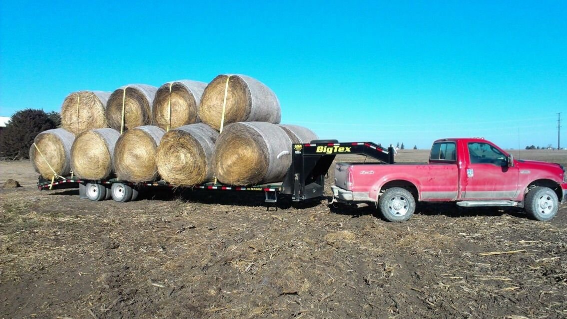

In my experience in the full-size truck gas engine comparison the 5.7 Hemi and the Chevy 6.0 really aren't all that much better if any at all on fuel mileage for the year of trucks you're looking at, the Chevy 6.0 is pathetic, regardless of how hard you rev it you really don't go any faster and the HEMI 5.7 while snappy unloaded will put the supposedly high revving 2V V10 to shame at how high it can rev while towing.
Both the 2V and the 3V V10 will play with what your pulling but I would personally walk away from any of them that have the low 3.73 gears unless you want to do a gear swap in the future. I was in a similar position as you and waited and found a 06 F350 V10 with 4.10 gear's by pure luck and love it! It plays with my little 35ft GN flatbed with 14 round bales of hay.... And you think you tow hevy, lol.

Lol I have seen that pic many times. Grandpa use to haul 10 round bales behind his 79 f150 on a 28 foot gooseneck. Of course I followed him with that load at the ripe age of 16 and a few years after.
Was looking at all years but will narrow up the search to 02 and newer.
